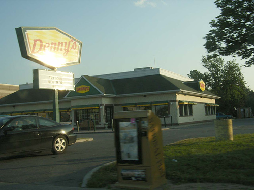

OK, it's time for a "Grand Slam" breakfast at Denny's... Research shows me that there are several styles of a Denny's restaurant. There is an older style with a sloping front and a newer style with a modified Mansard roof. There are also many other styles, but most of them are converts from other restaurants. Here are shots of two Denny's with the mansard roof that I'm going to use as my inspiration. The second one is about seven miles from my house so I was able to get pictures of the sides and back as well. My Denny's will be unique, but will follow much of the architectural aspects of a more modern Denny's. There's a brand new Denny's just about three miles from us, but it really doesn't have the characteristics of some of the others I've seen, so I'm going with this style.
Denny's in Glendale, AZ

Your right. That second photo looks very generic. More like a burger joint.
We have one like the first photo about a mile from us.

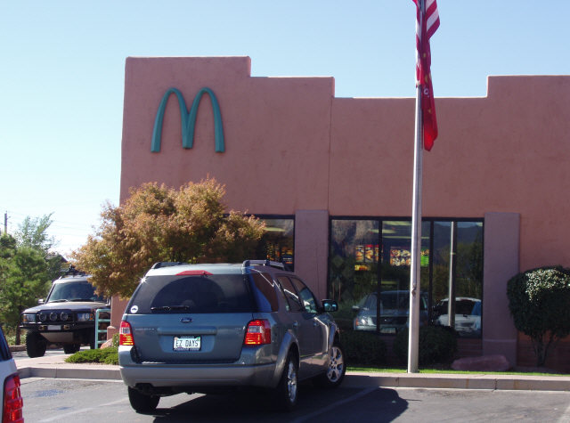

Talking about requiring McD's to do it their way, a goodly number of years ago, they wanted to build one in Sedona, Arizona. Well, Sedona has a rather strict building code, just about all commercial buildings are designed to blend in with the surrounding scenery. McD's agreeded, but balked when they were told they couldn't have golden arches. "Teal, or turquoise" was the edict. At first they balked, but soon decided that if they were going to have a McD's in Sedona, it would have teal arches. So here's a picture we took about four years ago:
Oh, note the license plate on the vehicle in the picture. We have since changed cars, but the plates stay with us.

Quite a thing, they turned what they thought was a baddie into a marketing bonanza. There are signs as you come into town, "Home of the teal arches".

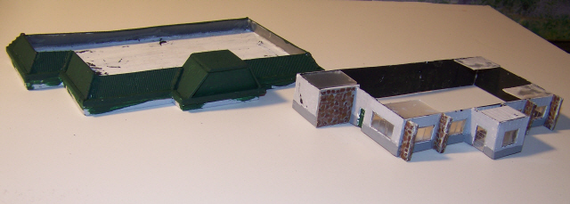

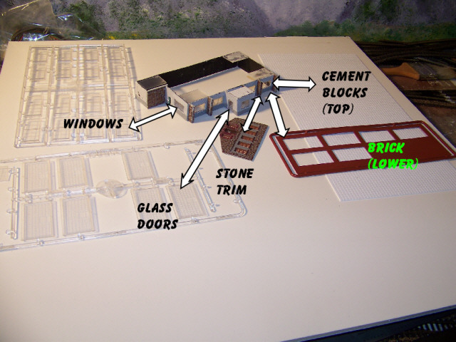

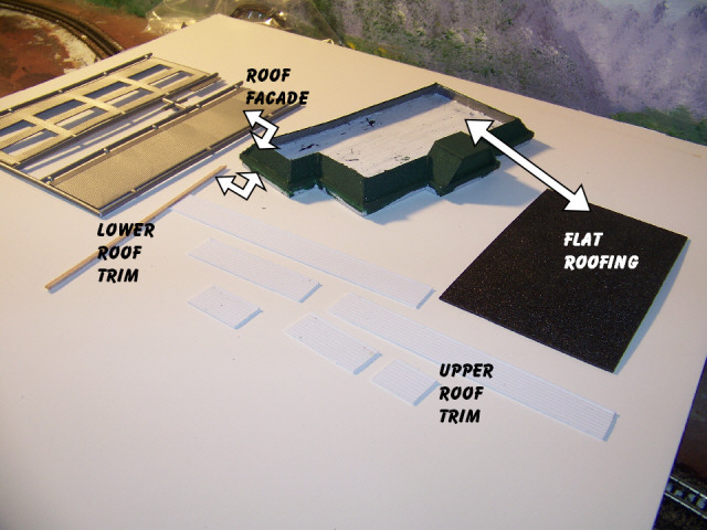

Well, I've been pecking a way at this for some time now, making a bit of progress, throwing away and redoing just about everything several times. I did take some progress pictures, but some of them are meaningless now, and a few others didn't turn out too good, a testimony to my picture-taking skills. So, just to bring things up to date, I took these pictures the past few days and kind of laid out the components that I used.
About five or six years ago when Model-Expo was going out of the train business, I bought up several Bachmann Car Repair Shop and Locomotive Repair Shop kits just for the parts. I know they were under $1.50 each and knew I could use the material someday. This is where I got the material for the roof facade, glass doors and windows. I also used the brick from the loco shop for the bottom of the walls. The top cement blocks are from a sheet of Evergreen styrene with 1/8" squares. The roof is a piece of .062 ABS and I used balsa wood to trim it and give it thickness.
This is where I am right now with the walls and roof:
Now this is how I got to the roof. Installing the upper roof trim will be my next step:
The walls and windows are all cut down from the Bachmann kits while th rock trim has been cut from a Pola loco service shop. I've got some corner blocks glued in place right now to keep the walls square and to give me something to glue the roof to when the time comes.
