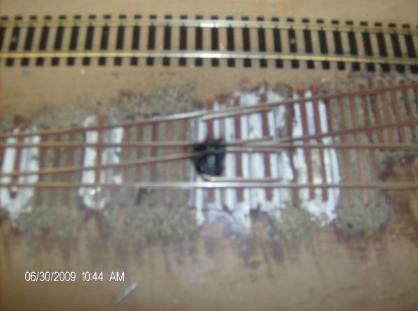

My layout was on fire!
Well, almost. The train had left the yard ten minutes ago, and I was at the furthest point from the yard testing the track work. All was fine and then there was a short somewhere. Before I could find it I smelled smoke Eek The short was in the yard and I found this Eek No idea why. Sorry for the blurry pic, cheap camera.
Guarantee you I am buying another fire extinguisher!
Loren
Glad that is the extent of the damage. My guess is something bridged the gap in your PC ties (those are pc ties, right?) and caused a short, and overheated. I am suprised a circuit breaker or fuse did not blow in your power system first.

Wow that is going to the extreme to add detail to your layout. There is even a spot where a locomotive fire happened. I think i can even smell the charred remains. 357 Smile
Beamish Wrote:Wow that is going to the extreme to add detail to your layout. There is even a spot where a locomotive fire happened. I think i can even smell the charred remains. 357 Smile
Hmm, not a bad idea. Thumbsup Maybe something good can come out of this. Big Grin

Wow! I wouldn't have thought that was possible since the voltage is so low, but there's the proof. Makes me want to go back and check all my wiring. Thanks, and glad there wasn't more damage on your layout!

Good thing you saw it in time.
That looks like a handlaid turnout, could of been something wrong there that didn't trip the circuit breaker, but was causing a sporadic short, instead of one long one that would of tripped the curcuit breaker.

Herc Driver, I didn't think that could happen either. Now I know better!
Eightyeight, the turnout is handlaid. What's funny is that turnout has been in use for a month, and I was doing no work in that area.

I think when you use pc board ties for a handlaid turnout, you do have a risk of a small bit of metal falling on the pc tie and crossing the slot you cut to isolate one side from the other. It is not unusual for various metal Kaddee coupler parts to fall, especially knuckle springs. It is probably not very common since anything that would cause a short must fall precisely on one of the few pc ties and exactly where the cut has been made to bridge both sides! We used an insulating paint called "Glyptol" on all of the electrical connections on any of the equipment we used when I worked in the harbor. Much of the equipment like cranes and such run on either 600 volts or in some cases 4,180 volts, the refrigeration units ran on 3 phase 440 volt power, and you don't want anything to short out connections! It is available at any electrical supply house. It might even be available at Home Depot or Lowes, I haven't looked. I only saw it in spray cans, but if it isn't available except in spray cans, a little could be sprayed into a small container and then brushed over all of your pc ties. It is bright orange in color, so you would use it as a primer and then paint your creosote, gray, brown or whatever color you prefer over it. We could use a meggar to check for voltage leaks from terminal boards to ground to make sure we had no shorts and a thin coating of this stuff would insure that we got a reading of infinity.
