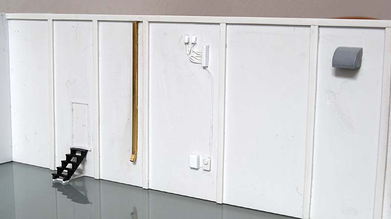

Just a short update to keep this thread alive and to show that I was not totally idle . After I ballasted the track on the left side extension, I built the first background structure for this side of the layout. Again it is a simple shoebox design and was very easy to to. That is why I only show the picture of the finished (but yet unpainted) structure and not how I built it. The structure is about 2' long and covers about half of the back of the extension.

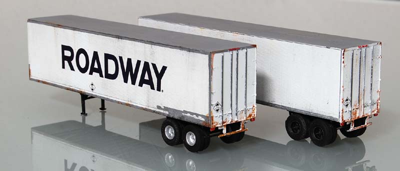

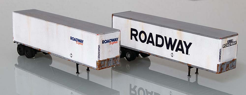

Today I assembled these two 40' trailers from an A-Line kit. I need them for another scene I am planning. These 40 ft. trailers are too old for the era I am modeling to be still in service, but they will look great on a lot with cracked and overgrown tarmac, left there to rot and fall into pieces. I don’t know if Roadway ever had trailers that looked like these, but I had the decals at hand and what can I say ... I really don’t care if they are prototypical or not .

I LOVE the little details like that electric meter, boxes and cables!!! Amazing!

Hey, some flat tires and some rusted rims would really make those old trailers look like they've bought the farm. So to speak.

Ralph, I love doing these little details and I think they can make even such a boring structure look interesting.
Shane, you are right, a litte rust on the rims would not hurt, but to flatten a tire that is made of solid rubber is beyound my capabilities .

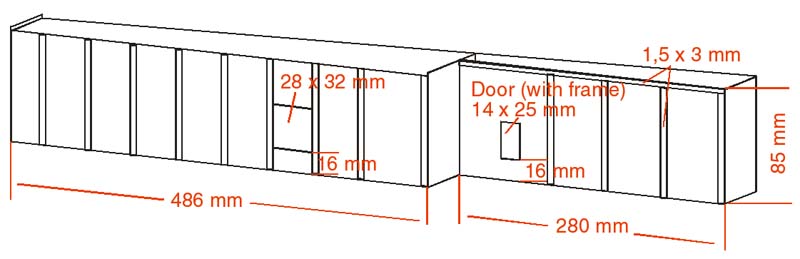

cnw1961 Wrote:Just a short update to keep this thread alive and to show that I was not totally idle . After I ballasted the track on the left extension, I built the first background structure for this side of the layout. Again it is a simple shoebox design and was very easy to to. That is why I only show the picture of the finished (but yet unpainted) structure and not how I built it. The structure is about 2' long and covers about half of the back of the extension. Hi Kurt,
I'm wanting to start scratchbuild some buildings... is this building really as simple as it looks? Sheet styrene plus strips? Can you post your measurements here?

If you have 40 foot trailers, and are modeling a more modern era where the majority of trailers would be 48 or even 53 footers, 40 footers can still be used for beer or batteries. There may be other commodities that are just too heavy to use a longer trailer as well. If a company is using a leased owner operator's trailer to move a commodity, they would probably end up loaded into a longer trailer; but for company owned equipment, using 40 feet of a 53 foot trailer instead of special ordering a new 40 foot trailer is probably not very common. 40 footers are much easier to maneuver in tight places than a 53, and thus less likely to suffer accident damage. A friend of mine here in So Cal works for a local beer distributor, and they special order 40 foot trailers, even paying an extra price for something "non-standard" because they couldn't load all 53 feet in a longer trailer anyway.

Russ, thank you for that very interesting and useful information. So even though my trailers are old, they could still be in service – looks like I don’t need to flatten the tires .
Colin, welcome to The Gauge. This building is really as simple as it looks. I used 1,5 mm (.060") styrene for the walls and the strips and some small pieces of corrugated styrene for the rolling doors. The electrical boxes are made of 2 mm (.080") styrene and the wires I cut from a 0,3 mm (.013") sheet. For the downspout I used a 2 mm (.080") square brass tube. The door is just a few thin strips of 0,3 mm styrene I glued to the wall. If you build a structure like this, don’t forget to brace it with styrene strips on the backside to prevent warping. Please feel free to ask if there is anything you need to know.

cnw1961 Wrote:... This building is really as simple as it looks. ...
Kurt,
Thanks for the info! I like how the building is angled to the backdrop.
Just one more question, which size corrugated styrene do you use for the doors?
