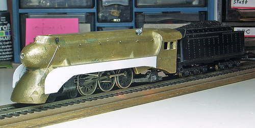

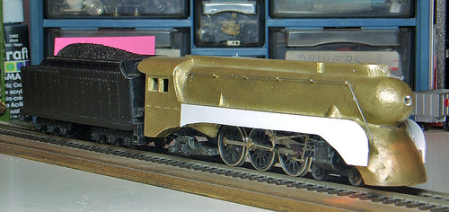

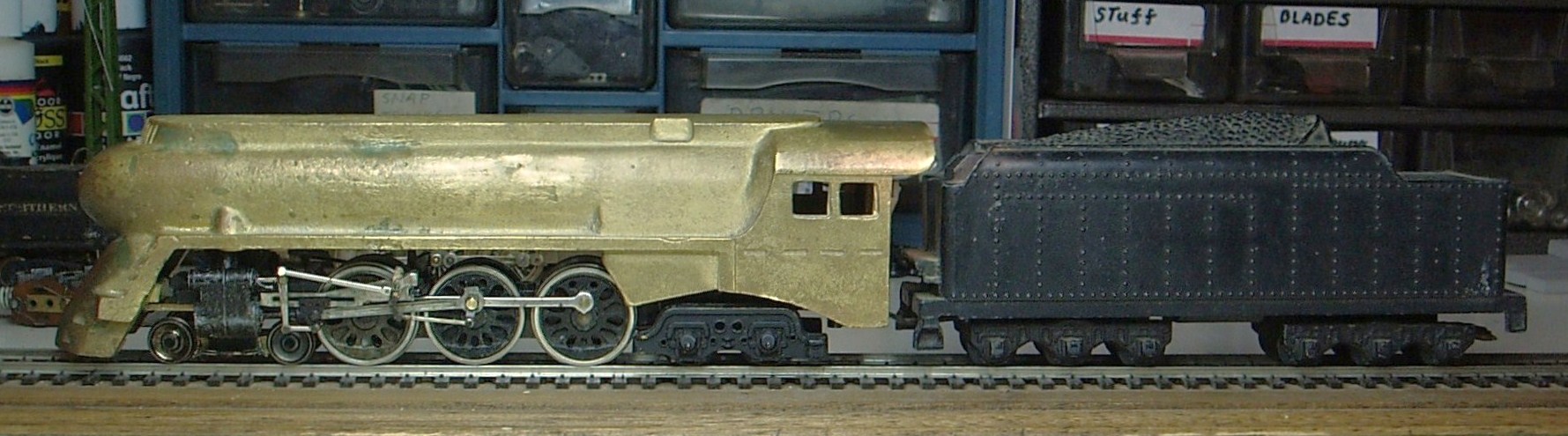

The body is a bronz streamlined economy hudson loco body. I first tried a old brass mountain frame. I tried it as a mountain and it didn't work out. I removed a driver and tried it as a pacific or hudson. The brass frame just didn't work out. I went to the Mantua Pacific frame and drive and had some sucess here. I have a frame in the body and I tried different tenders with it. The two that seam the best was the Riverrossi NYC Henrey Driffus streamlined tender and a old A.C. Gilbert diecast hudson tender. I am going with the gilbert. On the mantuas drive I replaced the mantua lead and trailing trucks with brass ones. The gilbert is just as wide and the height is good. They are both from the same time period. This is where I am now.

Looks good! Thumbsup Can we get a pic with the tender?
I like rescue projects like this! I will be watching.
Dave
-Dave
To view tender just slide the bar on the bottom of the photo to the right.
" It's a Heck of a Day " !!!!
That body must weigh a ton!
Loren
loren : yes it is ! When i was a kid this is how it was done. Not that everyone made bronze boilers. The ones i know of is, Varney, Cary, Bowser,and Takara of Japan. One thing is for sure, that boiler will last many generations. Finding a bronz drive for it would be great. This is what is not done. The loco need a a skirt made to partially cover and fill in the space below the walkway as Varney shows in it's sales photo of this model. Also the hand rails, head lamp, front marker lights, and a smoke stack. I have somemore drilling to do to complete the detailing on this model. Then a nice paint job. Finding a original tender would be nice, tho i can live with the old American Flyier one i am using.

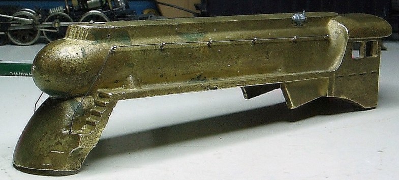

Here it is with its new handrails. frank

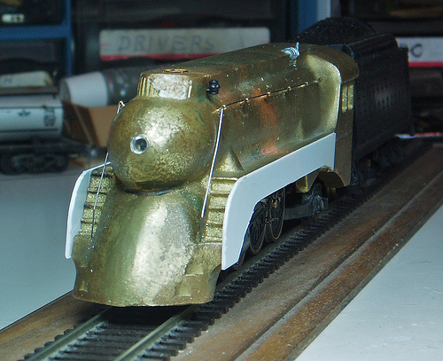

Here are the latest photos. Changes have been made. The side skirts are on. Headlight with lense done.The drive is changed and is now a Pacific. The locomotive is now a Pennsylvania Railroad K class streamliner. I am still busy with it. Finishing touches, painting, and lettering are still to come.

Looks good, but I have one question, didn't the k4 Pacific have a belpaire boiler? How difficult would it be to build a belpaire boiler out of styrene and install it.
** Russ : The belpare boiler is a Pennsy trademark. It is visiable on all of it's streamlinerd K class, except one. If I do all the necessary work to make it and try for a very prototypical boiler shape,I would have to cut the front pilot, and boiler front, off because it is very different than anything Pennsy had. This would make a Varney boillerd streamliners resteration impossable. I do want a use this very unique boiler as close to original as I can. My August 6th board goes into it more, but the front end on this boiler is NYC, or Santa-Fe, and i don't model ether. I'll have to exercise may right to artistic license, and for a more finished, and complete look, go with the boiler as it is. Their will be a attempt at a belpair boiler. Got to see how it comes out.
frank
I was thinking more of the distinctive large fire box seen on most Pennsy power. Since I model Santa Fe and not anything from the East, I've never noticed the differences at the front of the boiler, just the large "quare" box in front of the cab.
