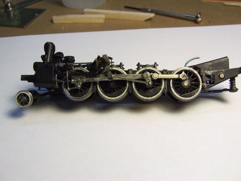

Once I received them I was shocked to find out the sellers description was sugar coated. Both had seen lots of running time and had never been taken care of. The paint was heavy and very poor and they were filthy. The pictures below are of the first one I have decided to work on and the one that will be the topic here. It was the one in the best shape and seemed like the logical one to start with and get back into operation first.
The following are pictures on #1 as I received it.

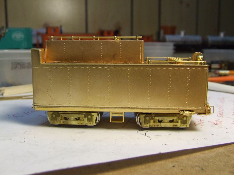

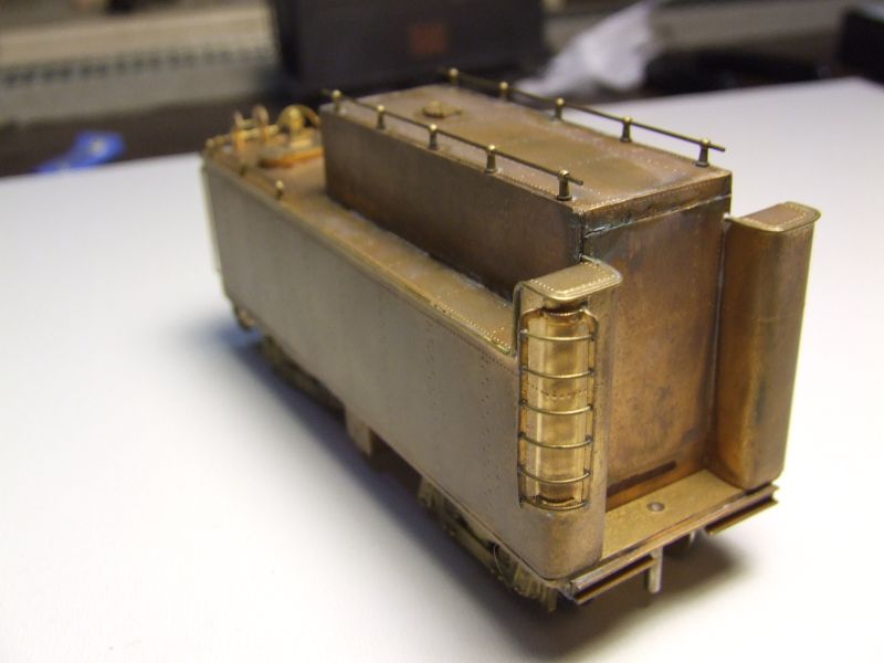

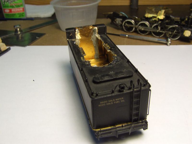

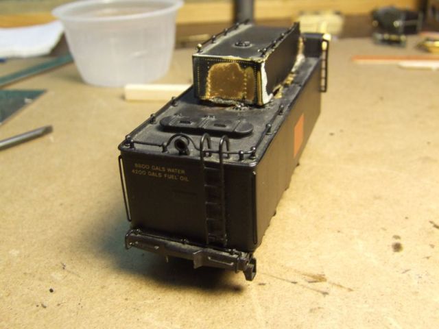

Removing the paint from the tender showed the damage was bad but possibly repairable. The original owner liked a coal tender more and he had removed the oil bunker. The oil bunker was bent in places and was the tender top deck where it was mounted. He had mounted a coal bunker from a brass CPR engine in its place and covered over the rest of the large hole with paper and some glued down coal.
I did not take any pictures of the paint removal process as it was a messy and stinky job.

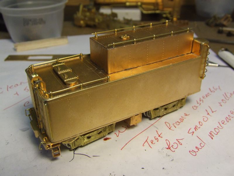

Seeing as the locomotive would need a usable tender I decided to start with it. After a lot of careful bending, test fitting and two evenings worth of effort I was able to piece the tender back together. The pictures below show the repaired tender. The repaired parts were test glued back together to check the fit of the parts. Once I was happy the glue was removed with acetone and the part soldered back together.
I am actually very pleased with the results.

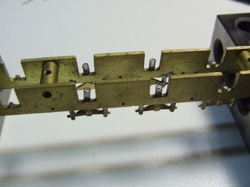

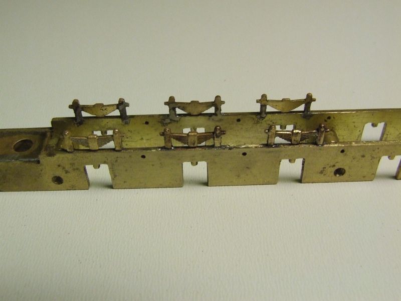

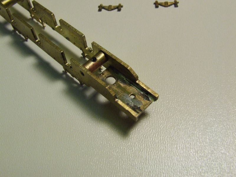

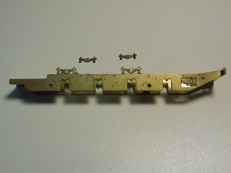

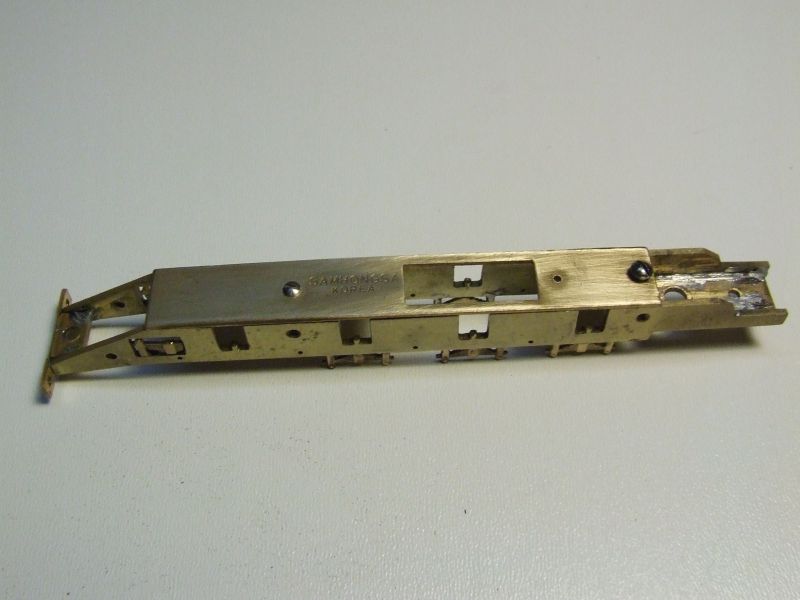

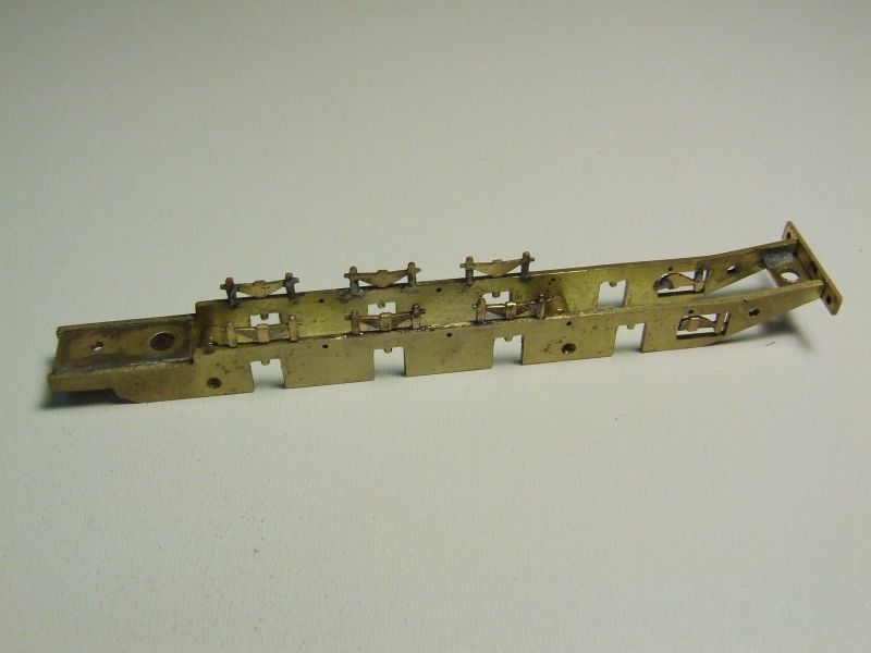

The frame was then removed from its lacquer thinner bath and rinsed off. Once agin I found some parts had been glued.A couple of the leaf springs were at the bottom of the jar and the brass plate between the front of the frame sides that the pilot mounts to was unsoldered on one side.
These were for the most part easy repairs. All the soldering was done with my homemade resistance solder unit. It made quick work of all the solder joints. I will post a few pictures of the soldering unit tomorrow and give a description of how it was made.
Below are some pictures of the repaired frame. The first one shows it right after paint removal and the rest are after it was repaired.
Wayne R
Some more shots of the frame.
Wayne R

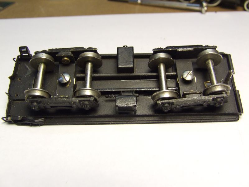

Here is another picture of the tender before paint removal with the damaged oil bunker removed. It was actually just sitting on top the tender in the other pictures. I was actually lucky that the oil bunker was not damaged any worse. It took a lot of careful work to remove the bends and get it to look as it should.

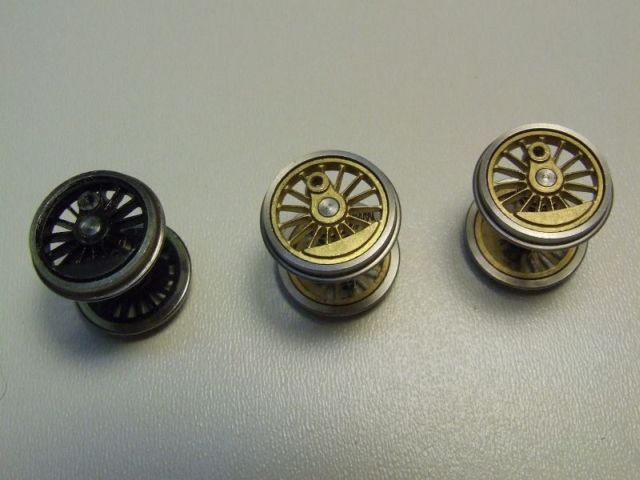

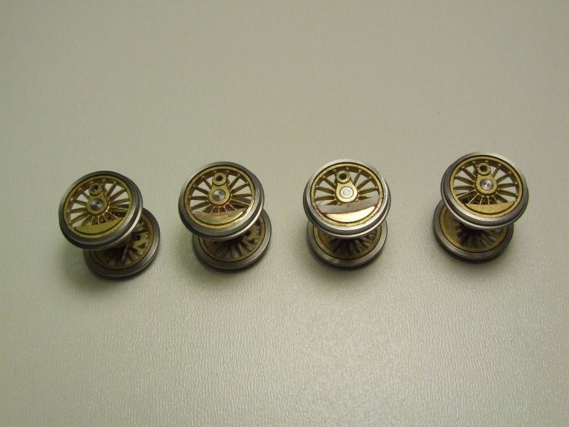

Next I decided to inspect the drivers. The were supposed to have moderate wear and they did. After cleaning them of the old sticky oil and dirt I placed them back in the frame to do a roll test. Right away it was clear by the bouncing wiggle the frame had when rolled down a section of track something was wrong. Careful inspection soon showed the axle holes on a couple of the wheels were not centered. One was of center by 0.025". I had planned on replating the original drivers but now replacing them was the only option. So I ordered some new 63" drivers from Greenway Products.
A couple of the new drivers beside an original one. The original ones had cast white metal center and the new ones have cast brass center. I like the brass better.I also believe the new drivers have either solid nickel silver tires or stainless steel tires. Either way they are not plated.
Wayne R
When the new driver set arrived I was faced with a new problem. The counter weights were all the same ( small ). I was unable to get new drivers with medium and heavy counter weights that had the same side rod screw spacing from the center of the axle. The pictures below show the new drivers with modified counter weights.     This photo shows the four new driver sets.
I added some plastic to the counter weights on two driver sets to give me medium and heavy counter weights. I wanted to use brass sheet stock but the spokes made it to hard to get the brass sheet to lay flat and look right. Plastic was my next choice and it came out nice. Once the wheel are painted it will be hard to tell there is plastic there.

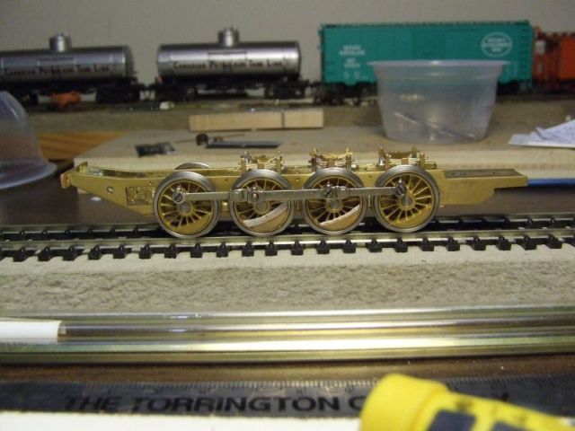

Seeing as the original driver springs were way to stiff I decided to add some new ones. NWSL light springs were added to all four axles.
Here is the frame with the new modified drivers, light driver springs and the side rods in place.
A rolling test showed the new drivers were a big improvement. The frame now rolls very smoothly. The bouncing is gone. While installing the drivers in the frame I noticed some of the axle bearings fit loose in the frame slots. They had front to back play. I used strips of brass shim stock to correct this and made sure the axles stayed 90 degrees to the frame and the axle center spacing was the same on each side. Once I completed adding the shims further rolling test showed it rolled even better.

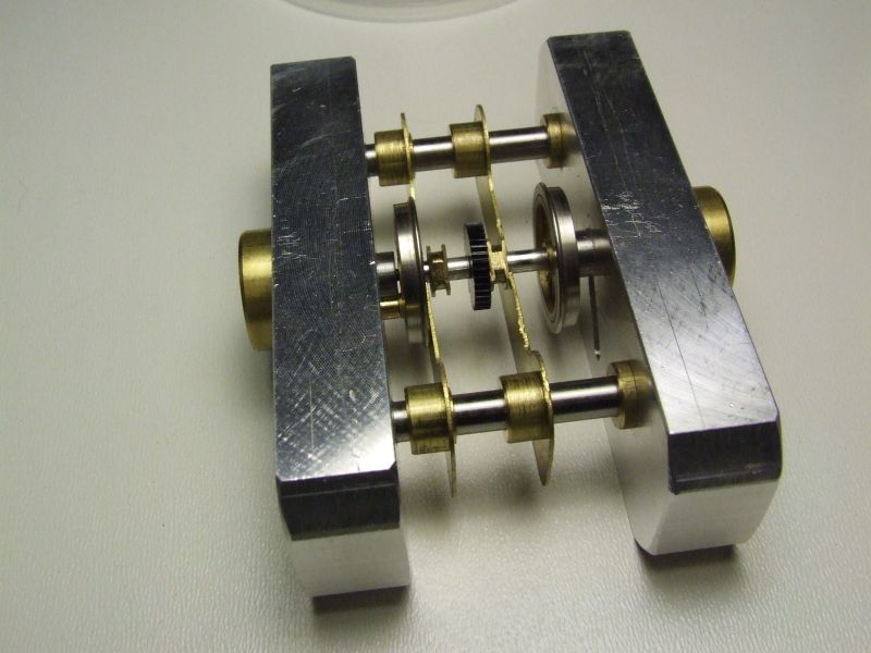

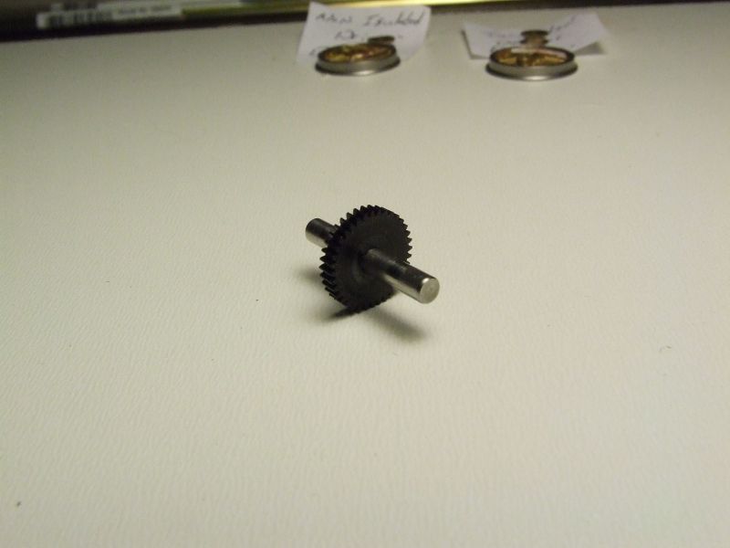

Installing the new gearbox means changing the axle gear on the geared driver set and requartering all the drivers sets so they match each other.     Here is the axle with the new 36 tooth gear pressed on. Both wheels were removed in order to use a set of machined metal blocks to check to make sure the gear is 90 degrees to the axle. Any wobble will make for a noisy gearbox again.

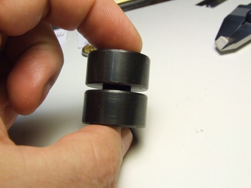

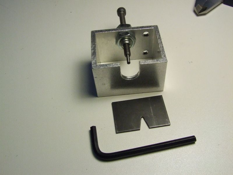

These are the blocks used to make sure the gear is square to the axle. You can use one block while pressing the gear on the axle. I placed the gear on the block with the hole in the gear over the axle hole in the block and press the axle through the gear. For a press I used my drill press with the axle in the chuck after I made sure the table on the drill press was 90 degrees both ways to the chuck. Careful work payed off as the gear was perfect when checked with both blocks.

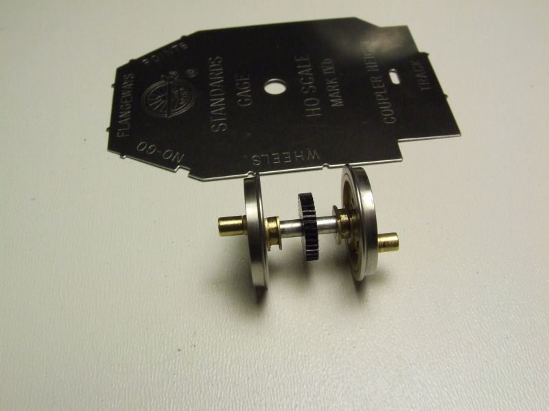

Here the geared driver set is being quartered with my NWSL quartering jig. This tool is a must for driver quartering. Works very well and makes the job easy.
    The geared driver set is now quartered and the wheel gauge has been checked. The brass pins screwed into the crankpin holes are the pins needed to use the quartering jig. The pins go into slots on each side of the jig and give an exact 90 degree quarter to each driver set. For a smooth running steam locomotive the driver sets must all have exactly the same quartering angle.

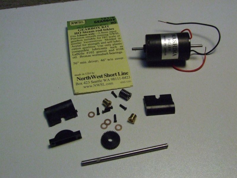

    Here we have the motor and gearbox kit I will be using to replace the open frame motor and the worn out original gearbox.
The motor is rated at 10,000 rpm. The gearbox is a 36:1 ratio. This combination with the scale 63" drivers should give me a scale speed somewhere around 65mph. I am not too worried about top speed but I do want the locomotive to have good smooth slow speed.

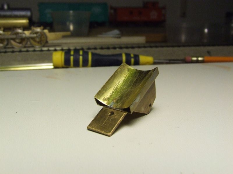

    This photo shows the original motor mount and the modified mount.
    I modified the motor mount to except the can motor by bending a piece of 0.010" brass sheet to match the curvature of the motor case. Next I took another peice of 0.010" brass sheet and made a U channel. It took some measuring to figure out how high to make the sides of the U channel so the curved brass sheet section would touch both sides of the U channel and the bottom of the U channel at the same time. Once everything fit the way I wanted it I soldered it together and to the original motor mount. A simple and sturdy motor mount.

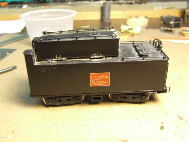

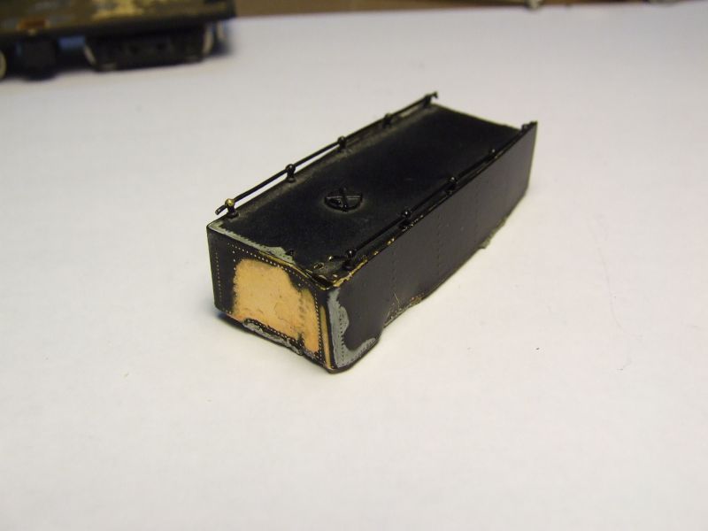

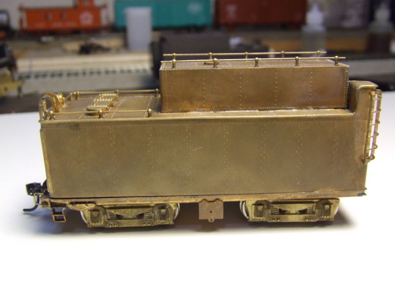

While I was resizing some more photos I found a couple of more of the repaired tender.
    This is the front of the tender and it shows where I had to add a small piece near the top front. When the original owner removed the oil bunker he cut the front wall off just above the raised front side sections on the tender. This left a small gap. The good and bad news was when he removed the oil bunker off the tender belonging to locomotive #2 he cut the front wall a little lower on that tender so with a little filing the piece from tender #2 was made to fit this tender. The bad news is the oil bunker for tender #2 was totally wrecked when he removed it.
    Here is another right side view of the repaired tender. The only thing missing is a ladder at the rear of the oil bunker going from the tender deck to the top of the oil bunker. The tender has lost its shine and has started to tarnish from all the handling.

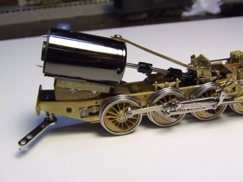

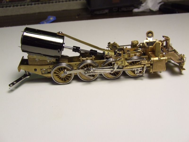

Now for some pictures of the reassembled drive for my N-5-d.
    Here is a right side view of the assembled drive. The new drivers and springs, the new gearbox with new drive shaft couplers, a torque arm, modified motor mount and the can motor.
    A close up view of the new can motor and the motor mount. I ended up using a different motor. This one had a single shaft and is 2mm longer than the other one. The motor is being held in place by some double sided foam tape. Same stuff used to mount after market plastic body panels on cars. Very strong stuff.
    The valve gear has been cleaned up and remounted for test running.
