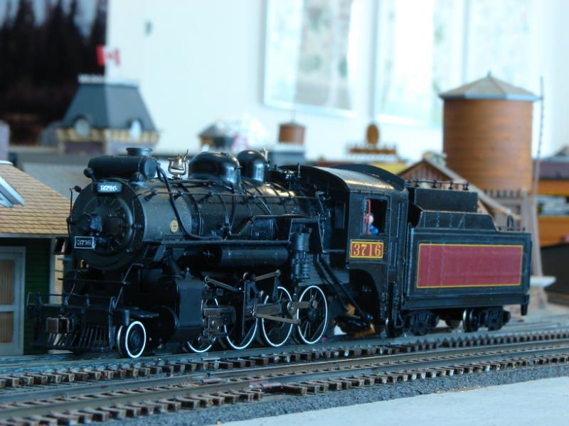

No problems here with using my picture again. Smile If you want to give the Spectrum 2-8-0 more of a CPR look Athabasca Shops makes an etched brass cab kit that fits the 2-8-0. The cab kit also includes a set of brass running board skirts as well as some other details. I used one of the cab kits on a Spectrum 2-8-0 a few years back for another modeller. Athabasca shops also makes a etched brass oil bunker kit for the Spectrum tender.
I am not sure where I got this picture but this in an example of what the Spectrum 2-8-0 looks like with the cab kit and oil bunker kit.

Wayne R, that really captures the look of the photo posted by Shane! To me, the distinctive skirting under the cab is what really sells the model. If I was trying to capture the look of that engine with just a single step, it would be to add a styrene skirt under the cab.

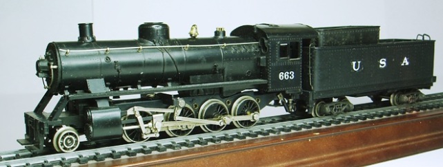

You can also consider the Riverossi clear vision tender as used on first the very old 2-8-0. Then later on the Indiana harbor belt ,2-8-0.
The same tender was used on both locos.
old Riverossi 2-8-0.
[ATTACHMENT NOT FOUND]
Riverossi Indiana Habor Beth 0-8-0.

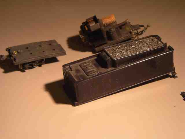

Tetters: I have an old Rivarossi tender like the one shown, but the coal bunker looks a bit longer. The frame has suffered from ZinkPest.
(PM me if interested)
