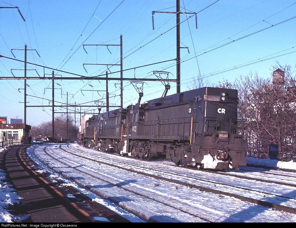

basically, i was already into electric railroads, but there was a photo that i really liked of three black E44s pulling a train in New Jersey that REALLY got me to go down the road of electric railroad.
on the other hand, the dark paint really obscures alot of the details. Its not that it covers them, but they were shallow to begin with, and flat black paint really makes them blend in with their surroundings. I figured one blue engine would be a nice change of pace and a realistic one. however, it ruins my 5 year dream of a three black unit match up.
A pair of black ones or a black and blue pair looks fine, but my mind seem unwilling to accept a three locomotive set with one blue loco mixed in.

this is the original photo that got me hooked-
[Image: 2354.1157428800.jpg]

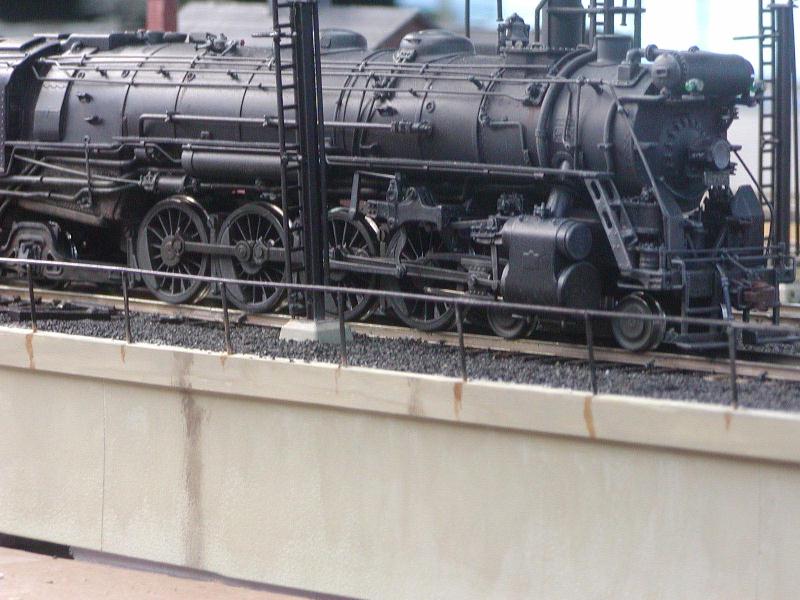

Hey, your dream is 3 black units, go for it. Black is a tough color to paint and not lose detail, but I've seen it done. I am not much of a painter but I'll ask a painter I know. I believe part of it is to use a paint such as loco black or grimy black rather than straight black. Also, weathering will pop out the details, drybrush white on the raised details. Wayne should be able to help you with this.
Here are a couple pics of a black steam loco, the closeup shows how well the details show, the other shows the loco is indeed black, not grey!

jglfan made a good point i never use carbon black if using black i either use a weathered black like payne's gray or ivory(bone) black both are a soft black . also a semi gloss or egg shell finish is better than flat.

I agree with Gary: the black units were the ones that inspired you, and that image is a strong one that stays with you even today. Paint 'em all black. If you're meant to have a blue one, another unit will become available.
Floquil and PollyScale both offer a Weathered Black which is still black, but not too much so. Wink Personally, I like to start with Engine Black, then lighten it to suit my tastes, using Reefer White and/or Grey Primer.
As Jim suggests, a semi-gloss will allow the details to show a little better on the un-weathered models, and a little weathering atop that will really make them "pop". Don't Dullcote after weathering unless you're doing a heavily weathered version - remember, the prototype wasn't painted in a flat finish.
