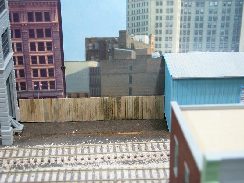

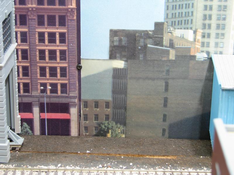

A variation on the many ideas presented thus far is a fence.
Before:
After:
