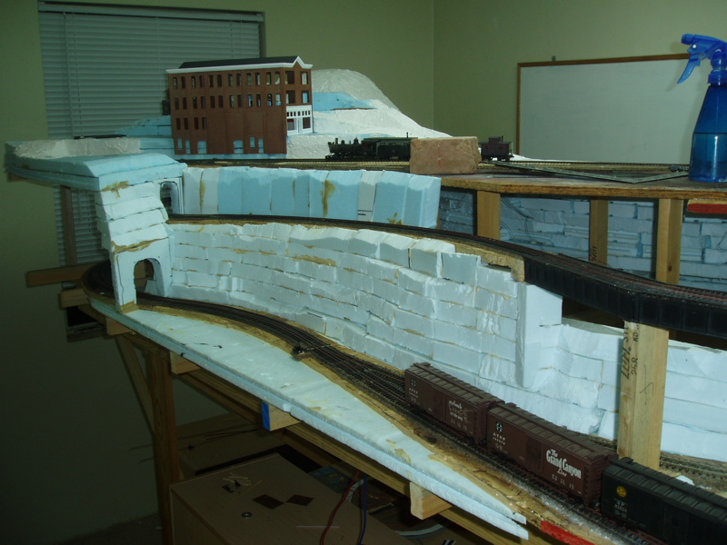

On the superimposed return loop section all of the lower loop is hidden until it emerges from the tunnel while a good part of the upper loop is blocked by the hill and farm scene.
[Image: IMG_0805.jpg]
