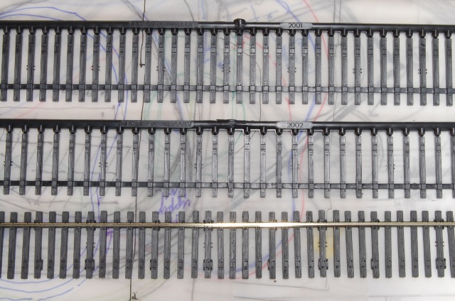

I haven't seen a lot of images of these outside of the CV site, and since I have seen a fair number of posts (i.e. interest) about these on this board, I thought I'd share some photos.
All are common in that they come in 1 foot lengths with the ties at either end molded half thickness. Given this is styrene, you simply glue the top half of the tie at the end of one strip to the bottom half of the tie at the end of the next strip. I had this pictured completely wrong in my head, so I'm glad I bought these - I like the way this works. As a side note, the end ties have little nubs for indexing, which speeds assembly, but these nubs are not the same from type to type - i.e. you can't index one type to another (you'd have to cut the nubs off - no biggie, but I'm curious as to why it was done this way)

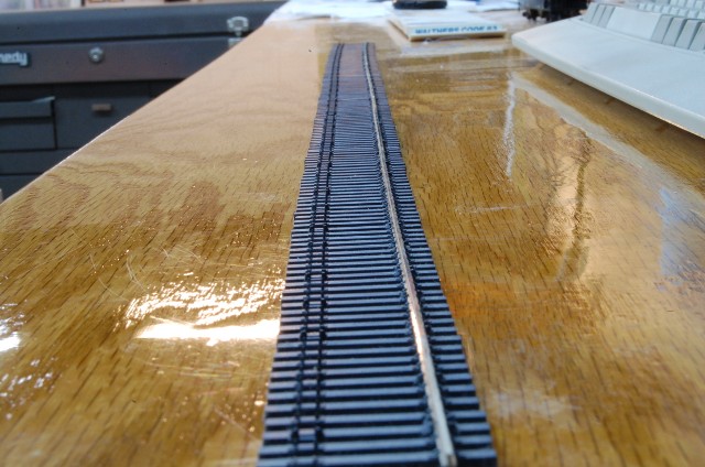

The end result can be bent into impressively small radiuses (the track around the radius of the image is about a 21" radius, for reference):

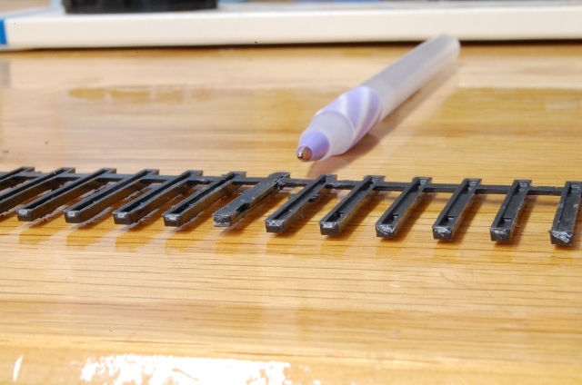

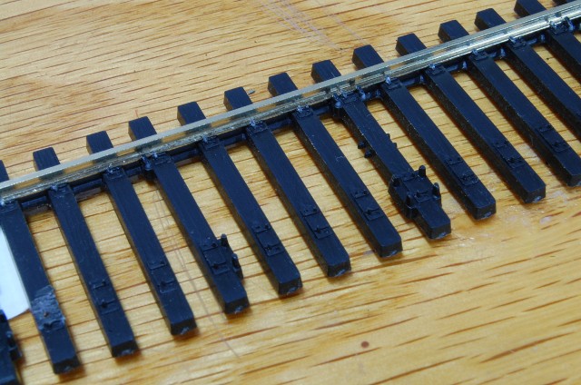

Fastening rail to the ties is NOT common from type to type. Central valley recommends that you either spike or glue rail to the Branchline and 9' Mainline ties. The 8'6" ties are more challenging; the spike detail and rail clamp detail is quite tall, after laying the rail into the tie plates, the design is for the user to use a small nailset or like tool and bend the "spikes" over the rail. At first this sounded pretty interesting. After fastening the 3' of rail in the next photo, I was WORN OUT! Smile
It actually held very well, until my daughter, in a sudden fit of interest in what I was doing, picked it up and bent it into a 8" (or so) radius. It held until I tried to straighten it out!
I personally like the 8'6" look because of the random set of the ties this way and that from centerline. The 9' look too long for a 1930's theme, though they are spaced on wider centers than the 8'6". The 8'6" ties also have quite a bit of rail clamp detail on them, more than I need, but that can be trimmed off.
