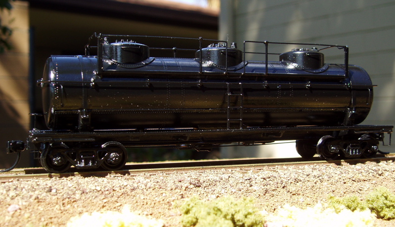

I have assembled everything and painted the car gloss black. Right now, it is resting on "shop trucks" while I wait for the paint to completely dry - then I will apply decals. Looks like it has already attracted some dust I will have to blow off before decaling.

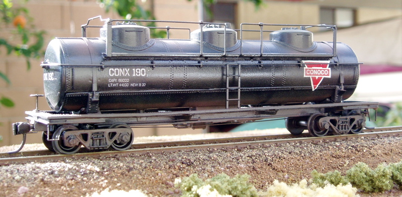

Thanks for the compliments guys. Wayne, if you want a 3-dome car, I suggest looking for the Athearn model. This bachmann car took quite a lot of work just to make it useable. I think they even used inferior plastic. Bachmann probably bought the molds from someone else - tyco or AHM, and perhaps those earlier cars were better. Anyway, here is the car with my homemade decals applied. Next comes some weathering.

Here is one more photo after some light airbrush weathering. It is still sitting on "shop" trucks. I will let this weathering dry overnight, and then dullcote the shine away, put on the final trucks, an call it done.

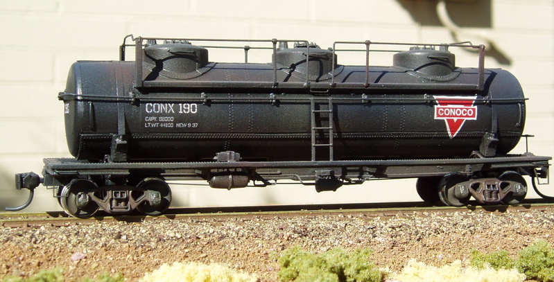

Two down, one to go. Here is the car after dullcote and final weathering. Not perfect, but definitely respectable. The only thing new I purchased for this car was more black paint. The rest came from my scrap box.
