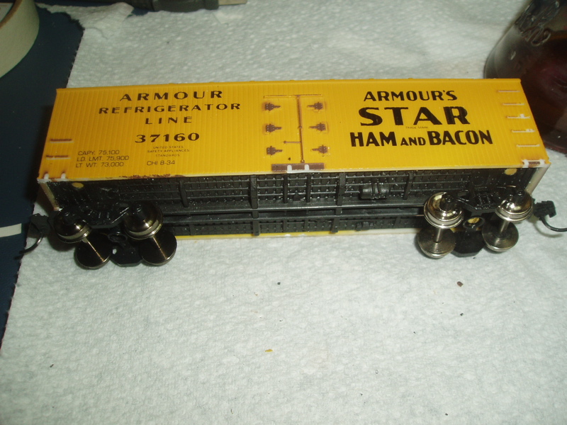

The stirrups are gone! Also, all grab irons have been shaved off using a chisel blade. I also shoved a piece of discarded sprue into the truck mounting holes, drilled and tapped them for a 2-56 screw to mount the trucks. I also glued a styrene pad to the floor to body mount kadee couplers.
That was quick! What brand of trucks are you using?
The trucks are from my junk box. I think they are either Athearn or MDC trucks in which I replaced the wheelsets.

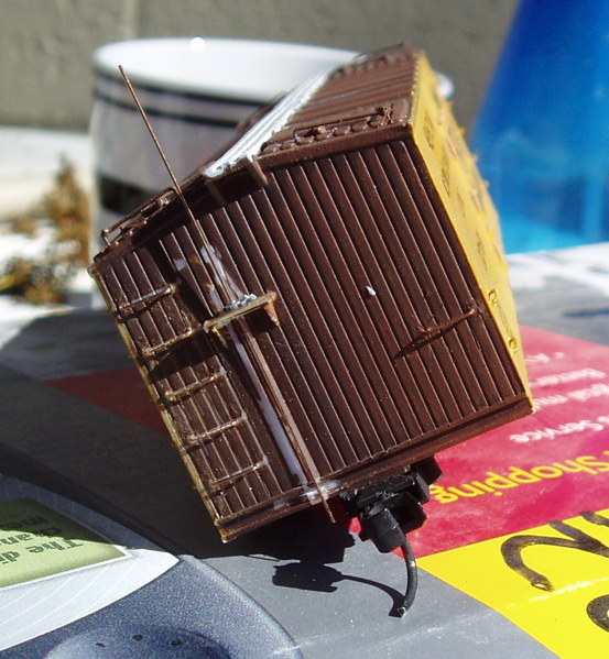

I decided one way to make the car look more appropriate for my era is to use archbar trucks and mount the brake wheel above the roofline. I carved off all the molded brake detail from the end of the car, and began fashioning a brake staff using pieces from my scrap box.

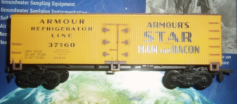

I also replaced all the grab irons with wire grabs, and touched up the paint using, oddly enough, "Armour yellow" that was on my paint shelf.

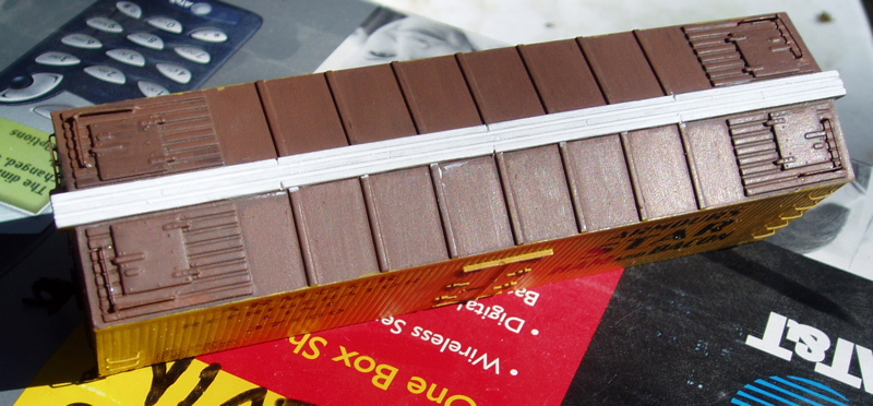

I also read that wooden roof walks were left unpainted because painted wood is slick when wet. So, I carved some board detail into the roof walk, added wood grain detail with 60 grit sandpaper, and primed with thinned household primer in preparation for staining with an ink wash.

One thing that you might want to consider is painting the grabirons black: many such cars, especially before WWII had the ironwork painted black - I think that it was because black paint was more durable than most other colours. Of course, if your paint scheme calls for yellow or boxcar red, use whatever is most appropriate. Wink
That is some nice work, Kevin. The grabs and the brake modification are right on target.
