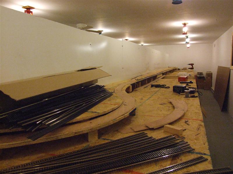

I have been busy with the layout too. doing some changes as I go, but it is getting to the point I know what it will look like, and I'm quite happy.

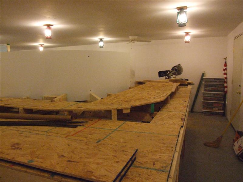

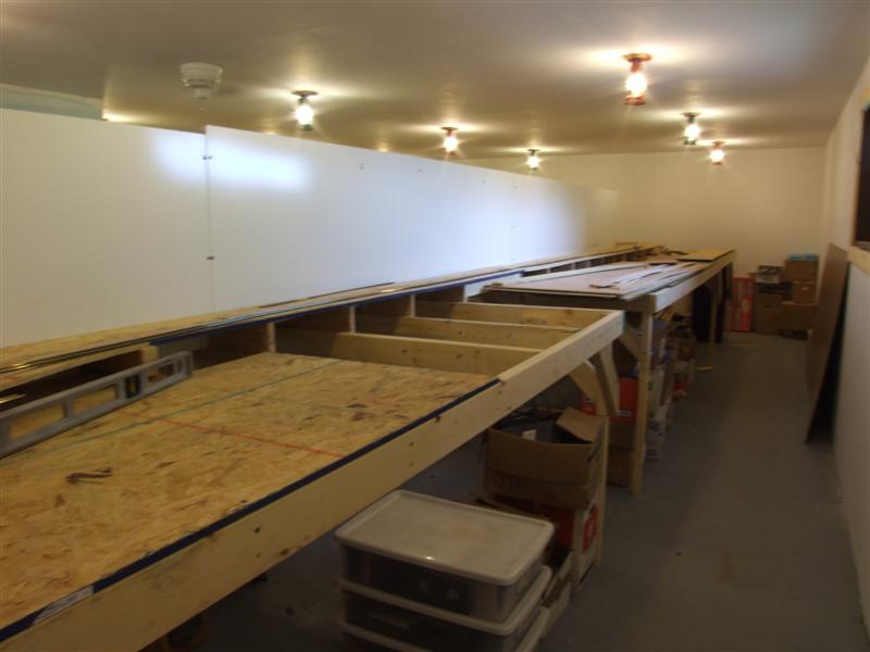

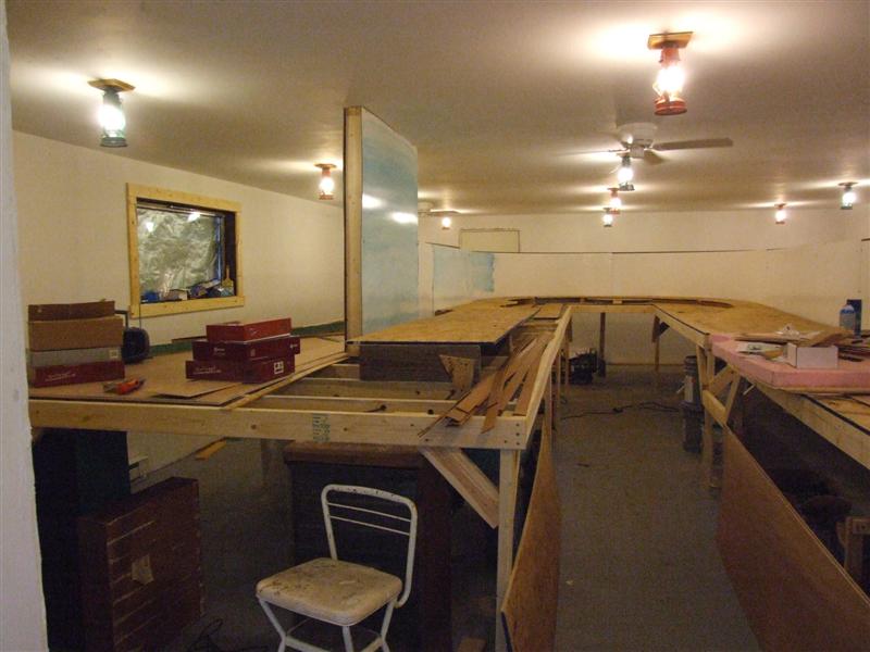

Here are a few more pictures. Not too much to explain yet, just cutting board and laying out the elevations.
Wow you're on the move Charlie, don't stop!

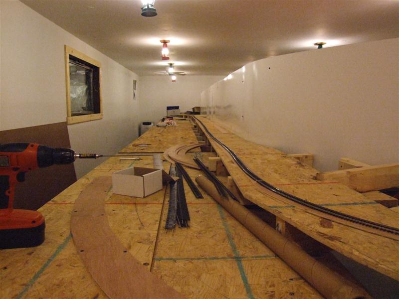

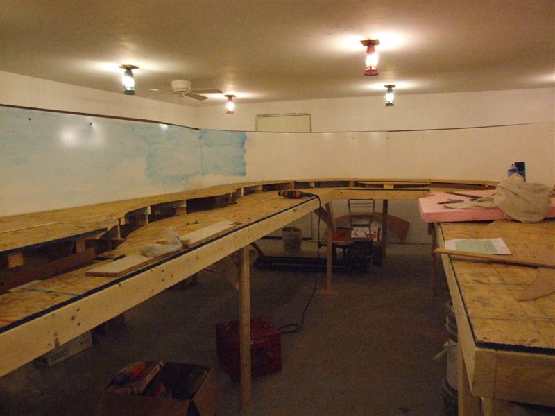

Charlie B Wrote:
ocalicreek Wrote:Charlie - have you got really long arms, or does that benchwork just look wide in pictures?
Galen
Galen, I have short arms, and the bench work is 80 inches in total width so I have to reach 38 inches to the backdrops most places. Once the scenery is on I shouldn't have to reach that often, the moving parts will be easily within reach, but I want broad curves so you have to sacrifice somewhere.
Very true. If you want the broad curves (and who doesn't!) then compromises have to be made. OR, access hatches have to be planned, built, hidden, etc.

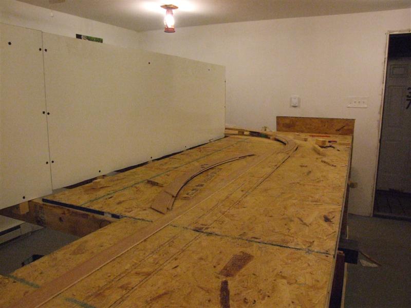

I have all the elevations established and I'm cutting and laying roadbed. I even put a few sections of track together (not spiked) and ran a locomotive just to run a locomotive.

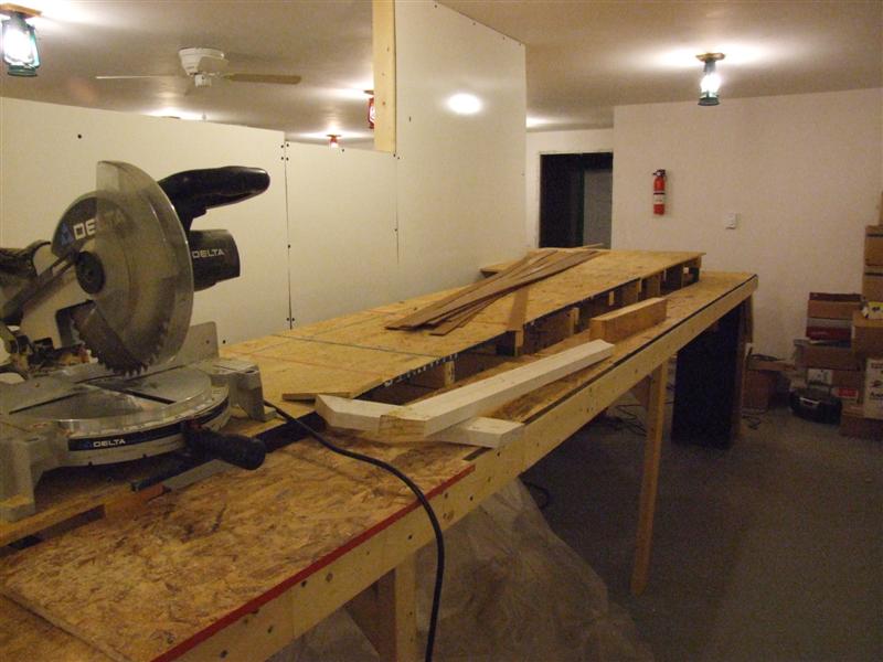

I did the math today and made templates for all of the curves. As much as I tried to avoid it I will have one curve that is only 24 inch radius. I will have 3 other tracks around the same curve so if I have to restrict some equipment I can run it on the other tracks around the curve.
I'm cutting my own roadbed too, just to do it. I'm using 1/4 in luan plywood. I have used this before with great results, it just takes a little time to cut, and I do have time.

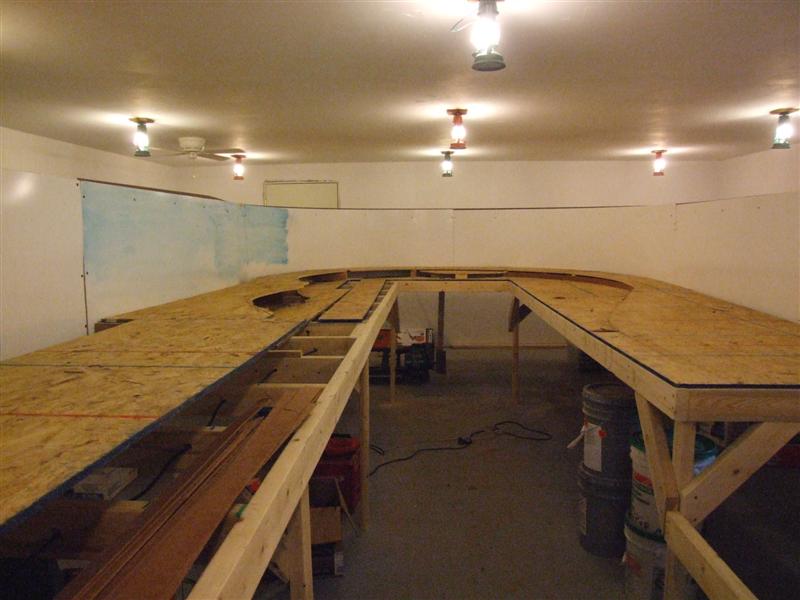

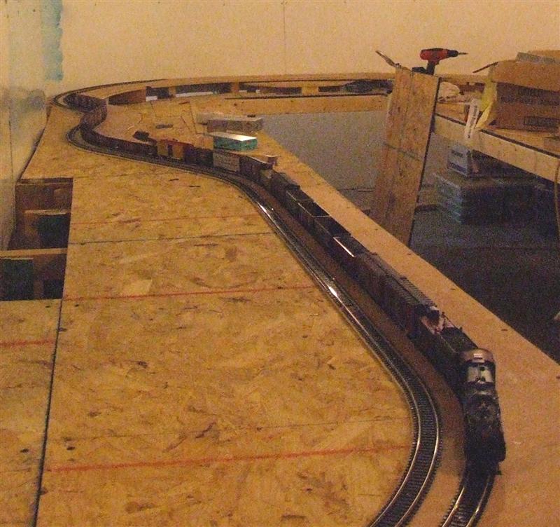

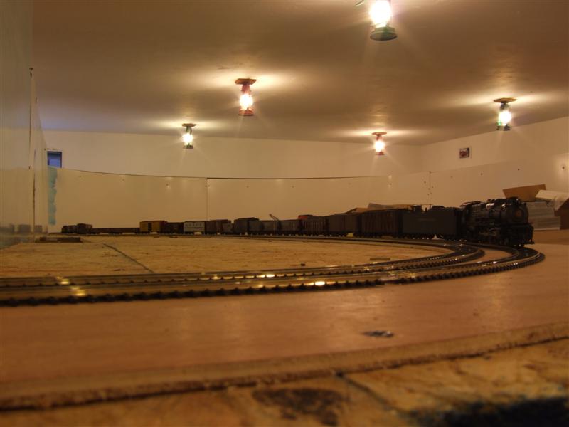

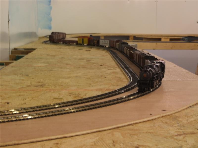

I have all the roadbed cut and laid so I started to lay some track. The area I'm working will be a 4 track main line. Here are some pictures, with a train on display too. Goldth
WOWZER Charlie! You're really getting a lot done!!!! That is gonna be one impressive layout with those long runs! Thumbsup
CHARLIE! Wonderful progress! And a looooong train!
