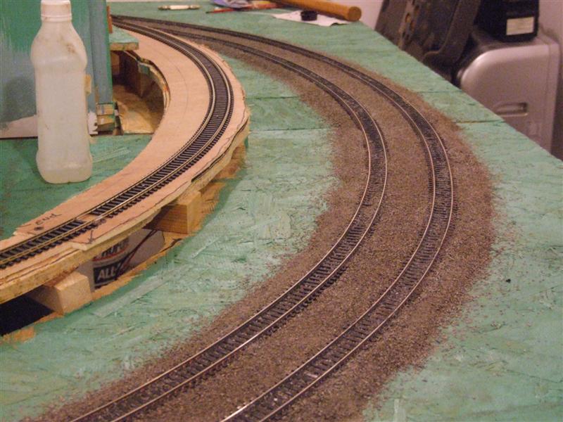

I was lucky enough to find a splatter shield (that you put over a frying pan) that had a smaller mesh than window screen, so the larger is the window screen, and the finer is what goes through the splatter shield. The material being pre-washed has very little actual dust in it.

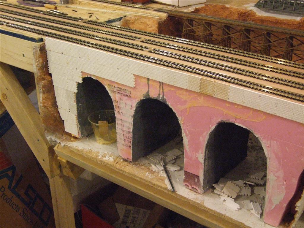

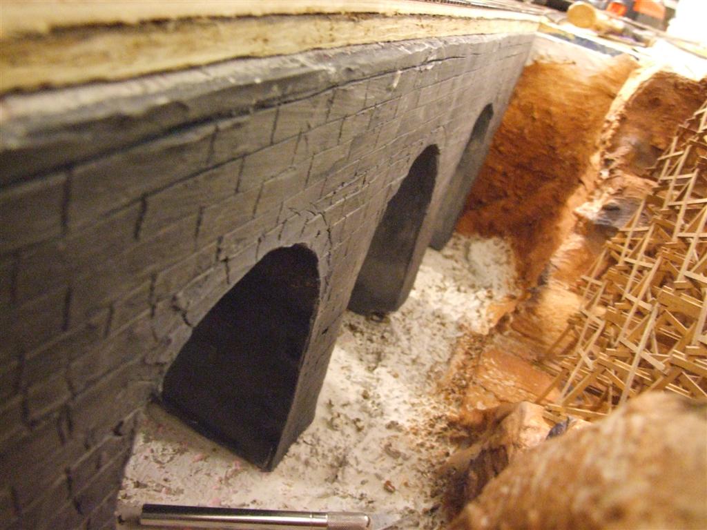

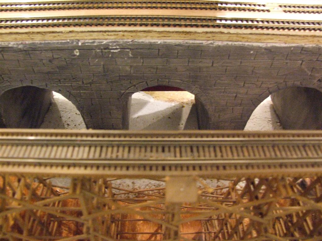

Here are a few pictures of the viaduct. On the back side I coated the foam with Dura-bond and then scribed the stone before I installed it. I figured it would look OK as no one will see it without craneing their neck out of joint. The front side I'm laying the stone plaster castings from top to bottom, I figured it was easier to make the top come out straight by starting there. It is all new to me. I wish I would have scribed the front too after seeing the pictures, but if the stonework looks too bad I can cover it too. Goldth
A four-track stone viaduct?!? Eek Eek Eek Eek That's epic! I love it when model railroaders dream big!
And a pretty solid-looking big dream, too. Thumbsup Thumbsup

I decided to give the small Linka stone the boot and as soon as I get the Durabond where I want it and straight I'll scribe it to resemble larger stone. I felt the stone in the Linka kits was just too small for such a large structure.

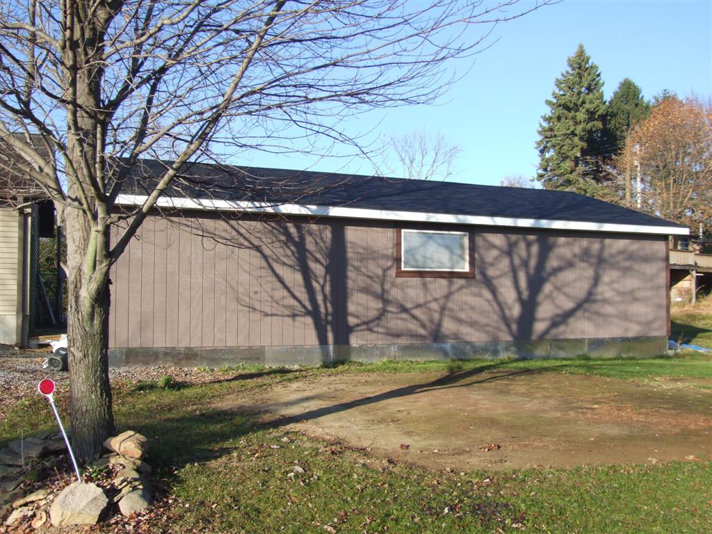

I guess not much noteworthy going on. We had such nice weather this week I took 3 days and got the final paint on the outside of the building. Now it is all the same color at least.

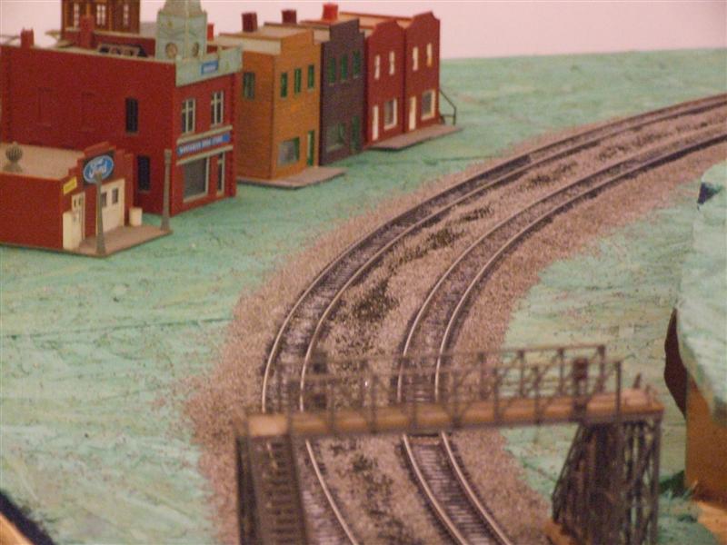

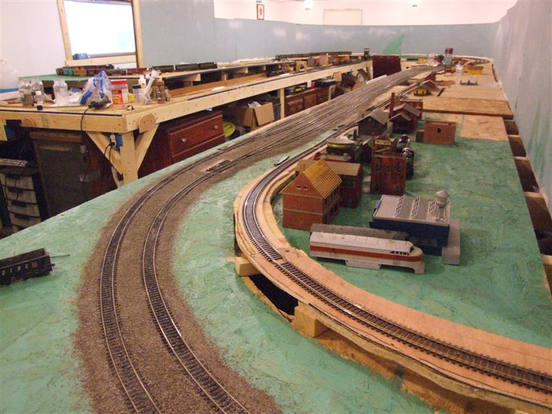

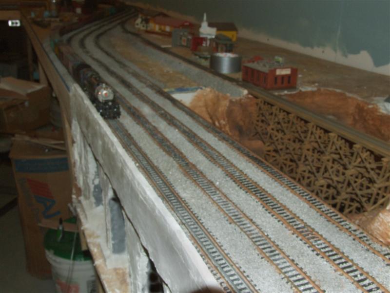

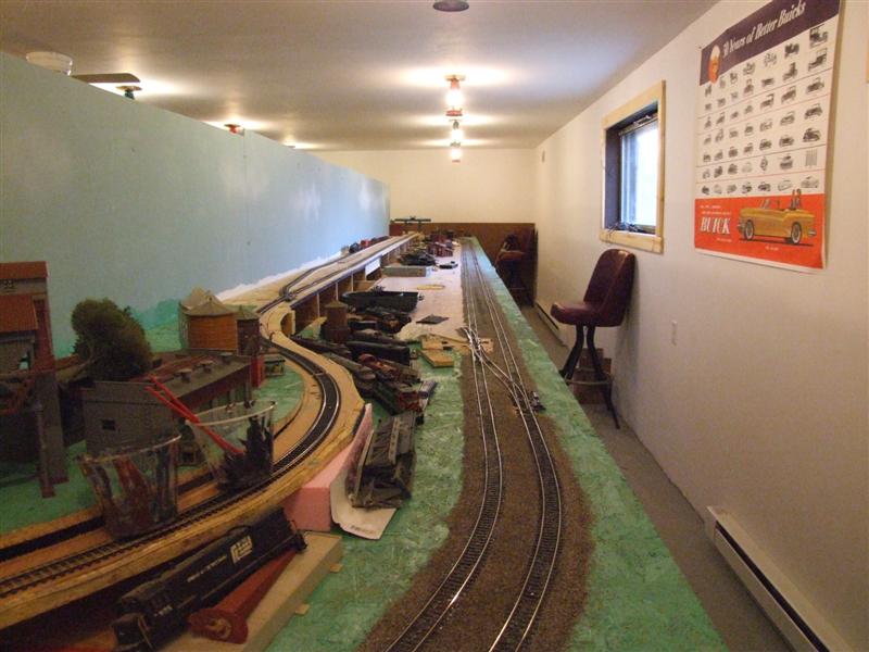

I installed 3 crossovers between the mains so the yards had access from both tracks in both directions, and all of the double track main is now ballasted which is about 60 feet of line, or half the layout. I still have 60 feet of 4 track main to ballast as well as 150 feet of branch line, then I will start the landscaping.
I had some cheap green latex paint so I painted the foundation, just to have something that looks a little better in pictures, and it will help until the real grass is applied.
That's ALOT of ballast! Will be great to see multiple looooong trains running! Smile

Here is a picture of the building with the new paint. The trim will remain dark brown and the doors are supposed to be red as well as the window trim. I don't know about the red, but that was one of the PRR schemes.

Nice ballasting work on those cool long stretches! It gets exciting at this point because things are looking like a real railroad. Say, what's happening with that PC U28B in the last picture of your track?!!
Charlie, the outside of the building is looking good too. I like the choice of colors. Thumbsup
That is a great building.
Do you have heating installed? I remember from my trips passing trough Ohio a climate similar to Germany. You will do very "cool" model railroading in the winter otherwise.
Update: I did find the heating on one of the photos.
