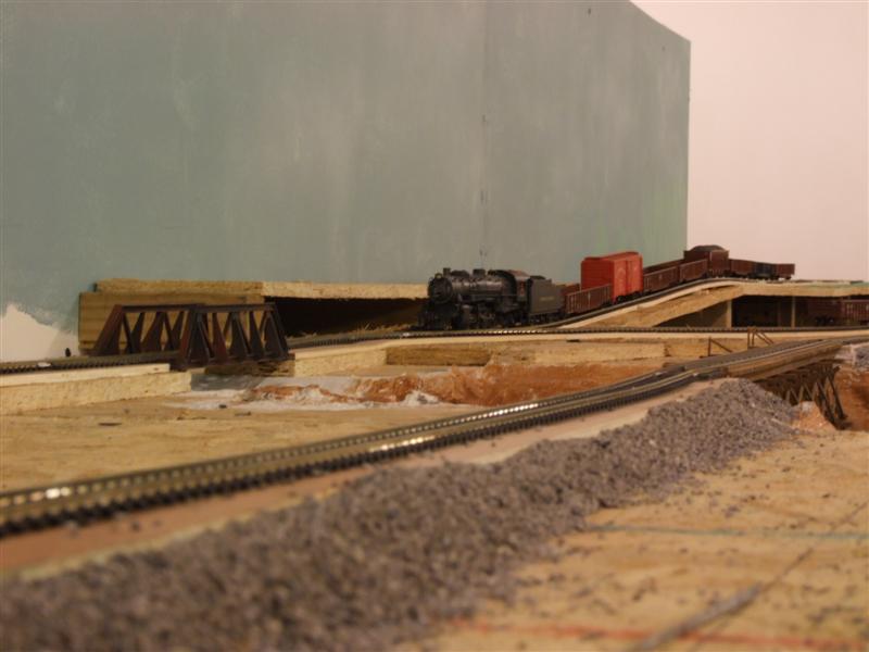

I managed to get the interchange track in for one of the two "short lines" that I will have, and it will act as a runaround track too. I raised a small area and added a track that will service some type of industry, I haven't decided what type yet but at least the track is there even though it is a 5% grade to get to it.
Geez, Charlie! You're gonna need a Shay or a Heisler or a Vulcan to get a short string of cars up that grade!
biL
Lehigh Susquehanna & Western
5% at such a large layout? I am afraid you have no permission for more than 1.5% Wink Wolfgang has a nice area with a steep track http://www.westportterminal.de/thirdstreet.html. That might be a sound story to have 5%
faraway Wrote:5% at such a large layout? I am afraid you have no permission for more than 1.5% Wink Wolfgang has a nice area with a steep track http://www.westportterminal.de/thirdstreet.html. That might be a sound story to have 5%
We have a spur about 20 miles from here that used to service some industries It was a 5% grade most of the way. It was a PRR line off of the main. There is another, though I don't think it is still active, that used to service a steel mill that was very steep too, probably a little steeper because it wasn't so long. This was off the P&LE, so I can get away with it, my grade is only 5 cars long, theirs was a mile or better.

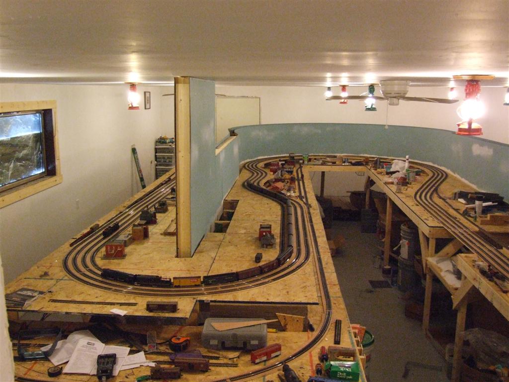

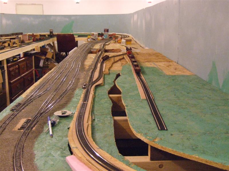

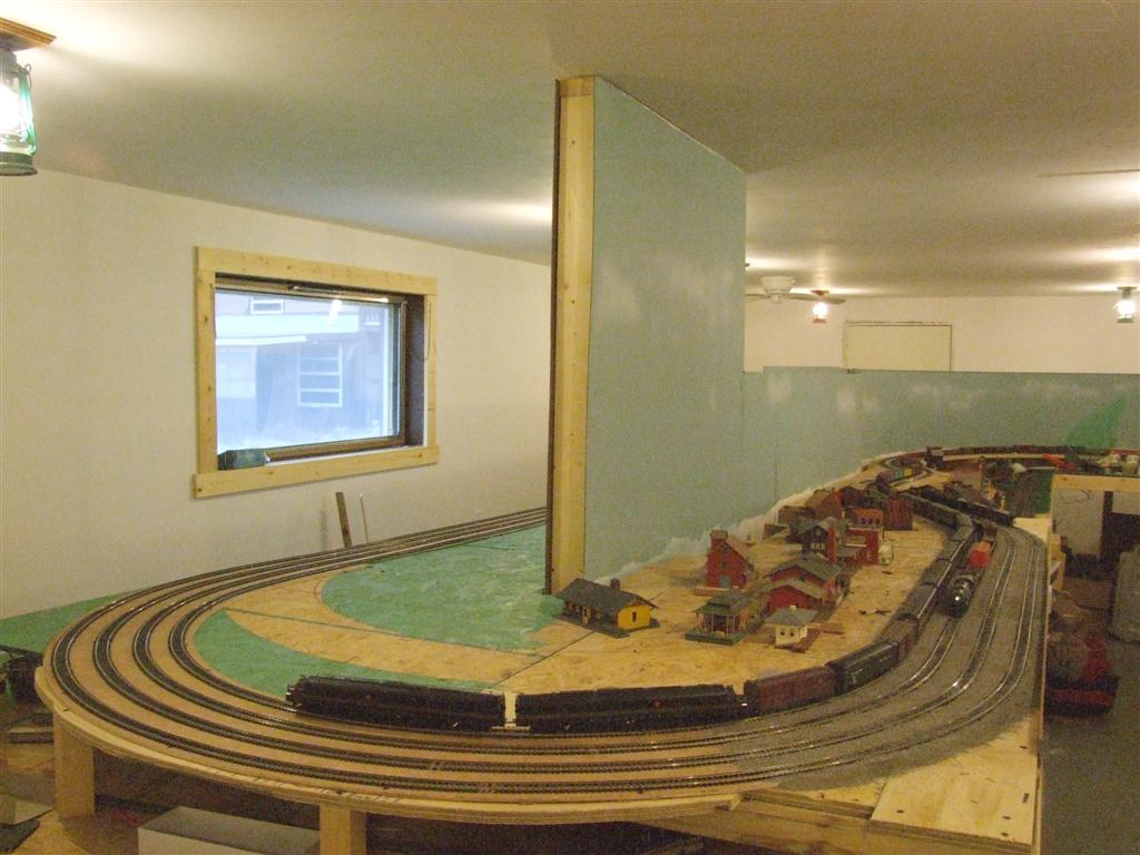

It's about time for an update. I had one curve that I was not at all happy with. It had a minimum radius of 22 inches on the inside track, and was the tightest curve on the main. Last Friday I tore that up and added more width to the upper deck and broadened the curve. Now the minimum inside curve is 26.5 inch radius, and the outside has a 35 inch radius. It looks better and the bigger cars and locomotives look better.
I was unable to find any ties locally so I set up a jig on my scroll saw and made a couple hundred to place at all the remaining joints before I finish ballasting.

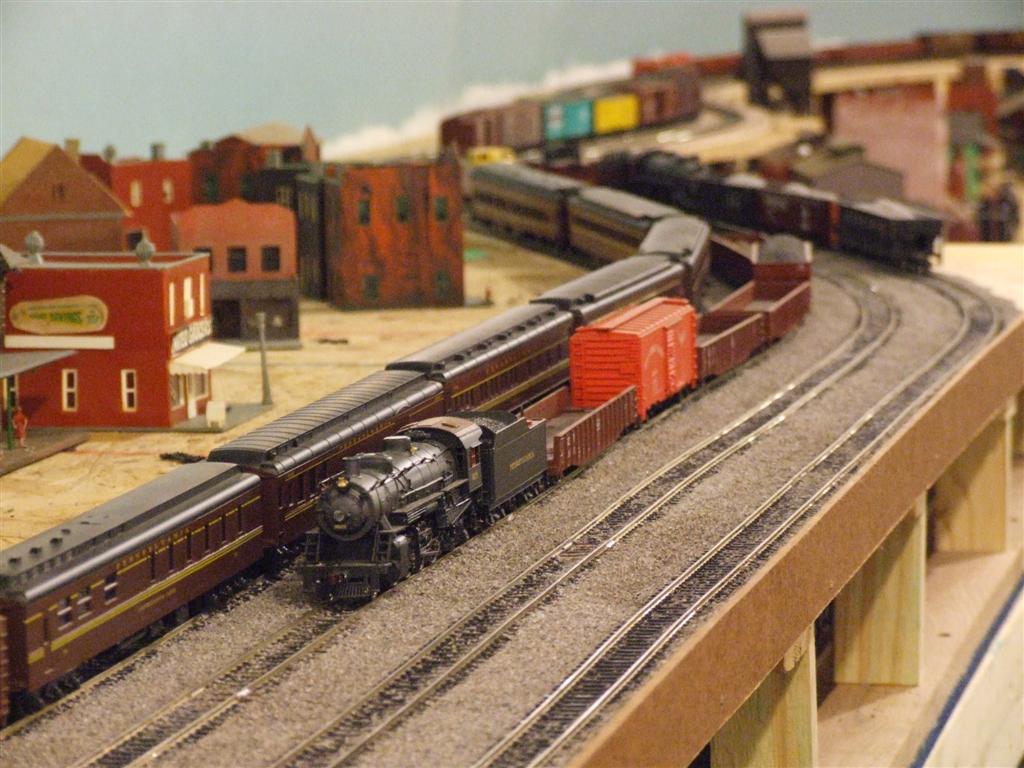

I have 45 feet of four track main left to finish ballasting, then I have about 150 feet of branch line to do. I think I am going to have some ballast left over.
You're making great progress, Charlie. Thumbsup Thumbsup Looks like all the shovellin', tampin', and gluin' oughta be done before my next visit. Wink Misngth Misngth
If you talk about ballasting it reminds me on serious work. There are lots of tracks hungry for ballast on your layout.
You might save some extra work if you paint the rails prior ballasting. It can be done afterwards but that is considerable more work. The many little ballast stones sitting on the ties can be easy cleaned up with a rotating steal brush in the Dremel. Just do not apply any force to the Dremel because the high speed rotating brush will melt the ties. That works so well you can cleanup 10' in less than 5 minutes.

Reinhard, I have tried it both ways and prefer painting the rail last. The rust actually runs onto the ballast on the prototype so a little paint looks OK. As for cleaning the ballast from the ties I just need a quick trip with a 1/2 inch wide scrapper and it comes right off. I'm waiting to do that last, the only thing I'm being careful of now is to make sure none is stuck to the gauge side of the rail so my trains won't derail. I have to have a worker protection under train movement plan in place because someone always shows up to see the trains run.
