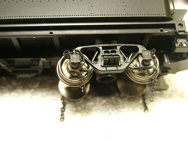

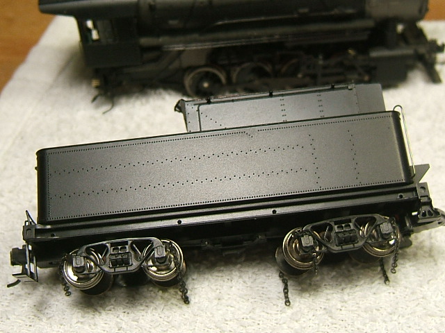

OK...So I finally got around to adding power pick-ups on the tender of my PK2000 0-8-0. If you're not familiar with this model, it's got some very prototypical chains on the tender trucks. After finally figuring out how to detach them from the tender - they were held in place with tiny-teenie pins, I went about the business of putting pick-ups on the trucks and wiring them to the decoder. That was the easy part. I buttoned the tender up, checked that all was working OK, and got around to reinstalling the chains back where they belong.....
I've spent the better part of two hours trying to get ONE chain back in place with no success. The chain is squirrelier than a wet bar of soap, and trying to insert the pin into the hole on the tender floor is next to impossible. So....does anybody know how this miracle was accomplished in the first place..?? Are the Chinese endowed with some quality I'm ignorant of..?? Surely they can do it in less than two hours per pin.... Eek
Does anybody have an idea how this can be done without spending the rest of my natural life messing with it..?? The next logical step is to cut them off and call it good.... Nope

can you post a pic of the offending chain.
Here you go...

Did you take the chains off the pins or the pins out of the tender's frame? Either way, you'll need lots of light, good eyesight (I use an Opti-Visor), and a good quality pair of tweezers.
Replacing the pins should be straightforward, if somewhat tedious. Wallbang Wallbang
I've found that the best way to get the chain onto a pin or wire is to allow it to hang, preferably over the edge of something so that only the last few links are dangling free - this decreases the amount that it can swing out of the way of the pin which you're attempting to insert into the last link. Two tweezers may increase your chances - one to hold the pin and insert it, the other to grasp the end of the pin and draw it completely into the link. A d... (that's much less than a drop) Misngth of ca should secure it so that you can work on the others without the finished ones coming apart. (To get a d... place a drop of ca on a piece of glass or metal, then wet the tip of an X-Acto #11 blade in the drop - the amount should be barely noticeable - and touch it momentarily to the pin/chain link). Simply repeat seven times, and you're done! Goldth
Another trick I find useful when dealing with chain is to put a big loop of thread through the last link. You may need to use a needle to do it, but then there is a big "handle" on the chain that can be threaded through a hole, or tied to something, etc as necessary.
Don't know if that helps in this case. Good luck!

Well...The nasty deed is done. Took me only about 4 hours... Sad
What surprised me was the vast vocabulary of swear words at my command. They were repeated often, I assure you... Eek
But it turned out OK...And they do look cool...AND the li'l ol' 0-8-0 works beautifully now..So it was well worth the effort... 2285_

Well...I started by re-inserting the pins into the chains. This was fairly straightforward, at first. For some reason the last 3 just didn't want to behave, so that brought on some more white hairs. Inserting the pins/chains into the itty-bitty holes was not as difficult as I thought....Once I could see the holes... Misngth My sight isn't anything to write home about, and trying to insert a black pin into a black hole was kind'a of a b*****. So I put a dab of white paint on the holes, and that made it much easier...
