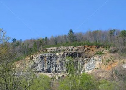

Les, I just remembered there is a strip mine near New Castle, Pa. and they are taking limestone. The mine has been there for years, I just forgot about it. Next time I'm in the area I'll see if I can get a decent picture. It is off the beaten path to get to it but you can see the dragline from the road. Years ago they shipped by rail too.

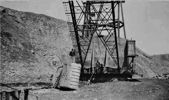

Les finaly got back to the gauge here is some photos of late 30's to early 50's strip mines. there are a lot of larger mines of the era but many smaller mines were still in opperation then by the mid to late 50,s most of the small opperations were gone and large was the norm. also one thing to rember a lot of coal was still shipped in gon's then.
jim
this is a photo of a small pit from the 40,s
here a few photos of late 40's to late 50's
