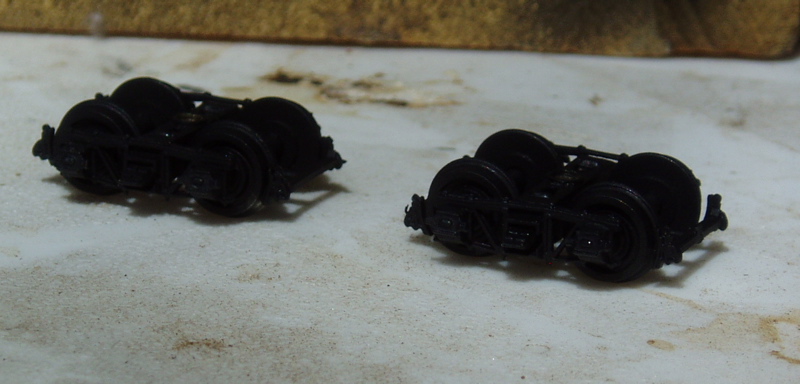

The trucks came unassembled. The sideframes and the bolsters are separate pieces, as are the journal box covers. The bolsters have brake beams attached, and the instructions say to cut off the inner brake shoes. I thought this instruction seemed odd, after all why add the brake shoes to the casting if they are to be cut off? But, I found it would be impossible to assemble with the brake shoes in place, and the inner brake shoes are hidden by the sideframes anyway. The instructions also say to assemble with CA. Solder could also be used but I thought JB weld would be the best choice. I have soldered unassembled trucks before, and they worked out okay, but they were difficult to hold together while soldering. The JB weld worked great on these trucks. I still need to weather them a bit and clean off the wheel treads.

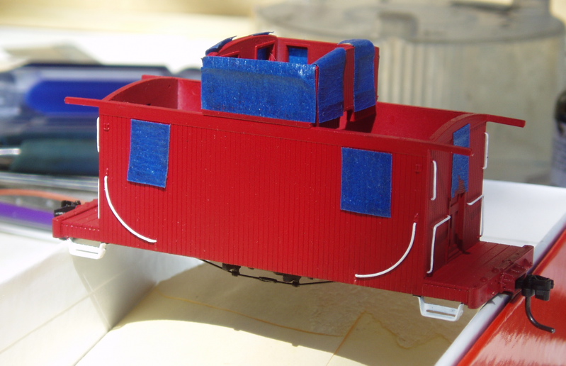

I also sprayed the caboose body with glosscote to prepare for decals. After the decals are in place, I will dullcote, install window glass, and then final assembly.

Does that style of truck have a name?
#18
TrainNut Wrote:Does that style of truck have a name?
I am glad you approve Big Grin It has actually been a fun build so far, and the complications haven't been that bad. If one is expecting an easy "shake the box" kit, then the complications are more frustrating. The trucks are archbar with leaf springs (as opposed to coil springs)

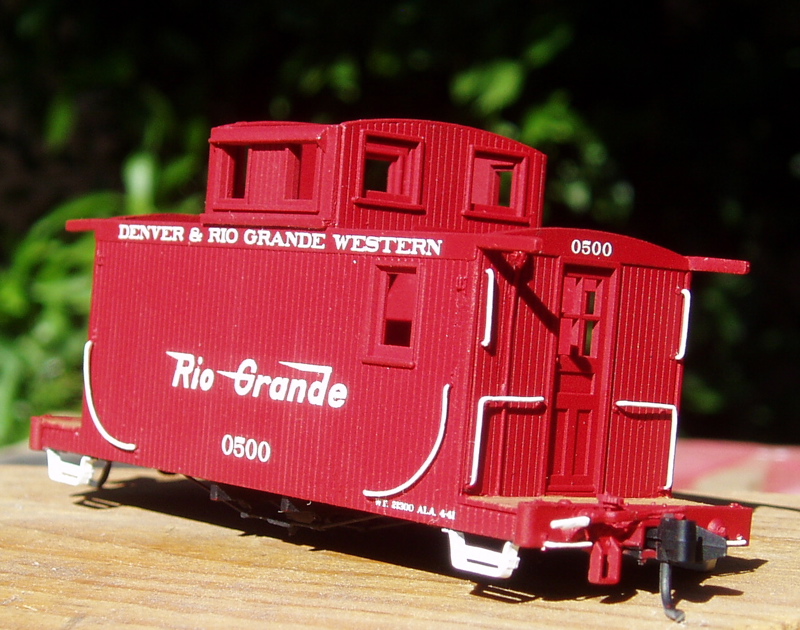

I added decals, and things went well. After the decals were set, I took an x-acto blade and sliced the decals between the siding boards, and applied more decal setting solution. You can't even tell they are decals! There were two decals that didn't fit. They are two small messages that tell passengers to stay off the platforms. I assume this message was added by the Rio Grande when these cabooses were used at the end of the Silverton mixed train, after tourism picked up after WWII. The photos I have found usually place this message on the end doors, and the decal was too long to fit on the door, so I left it off. Next up is to clean up and paint the end railings (they are brass castings), install window glass, and the roof sections.

Kevin, your lettering job turned out extremely well. Thumbsup Thumbsup

Very vibrant, crisp, clear lettering. The D&RGW across the top almost looks like it has depth to it. Thumbsup

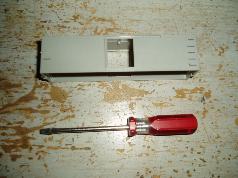

I am finishing up details on the caboose, waiting for paint to dry. So, last night I broke out the boxcars and began drilling for grab irons while watching TV. It is a perfect TV activity; unfortunately of the 4 sports playoffs series going on right now, none seem very competitive Curse . I plan to build the three boxcars assembly line style. Instead of building one after another, I will do each instruction step to all three cars before moving on.

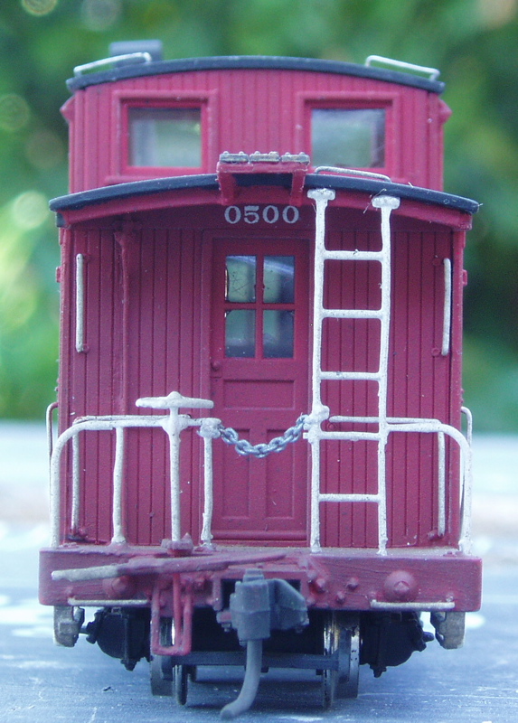

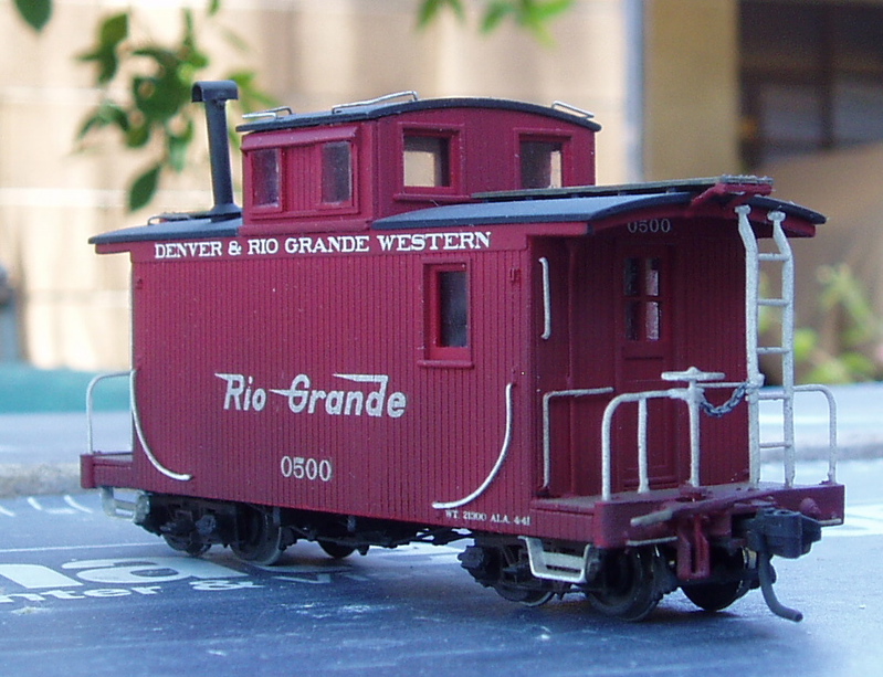

Here is the completed caboose. I glued the cupola side window glass to the outside because that is the way the prototype appears to have them (some kind of sliding window). I also added chains across the platforms, and some light airbrush weathering with Polly Scale Oily black. The light colored specks you see on the caboose side are some dust that flew on just before I took the photo (it brushes right off). I only mention this because perhaps this is the dust that is causing me allergy misery the past few days Curse Curse Curse
Anyway, on to working on the boxcars!

That certainly builds into a nice little crummy. Great job!

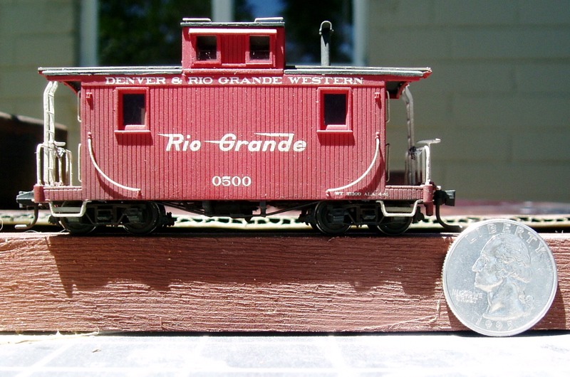

I realized some people may not be aware how small HOn3 is, so I took one more photo in the sun in front of a standard US quarter. It really isn't that much bigger than N-scale standard gauge, and is the reason I started into narrow gauge. I wanted something that I could build a small layout in an apartment, yet still large enough where detailing rolling stock wasn't too tedious.
