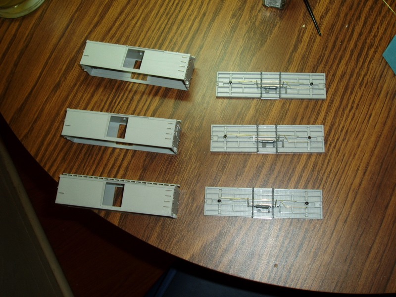

Thanks for the compliments, guys. biL - next is three Rail Line boxcar kits. I have the grab irons installed, and now am working on the underframes.
#32

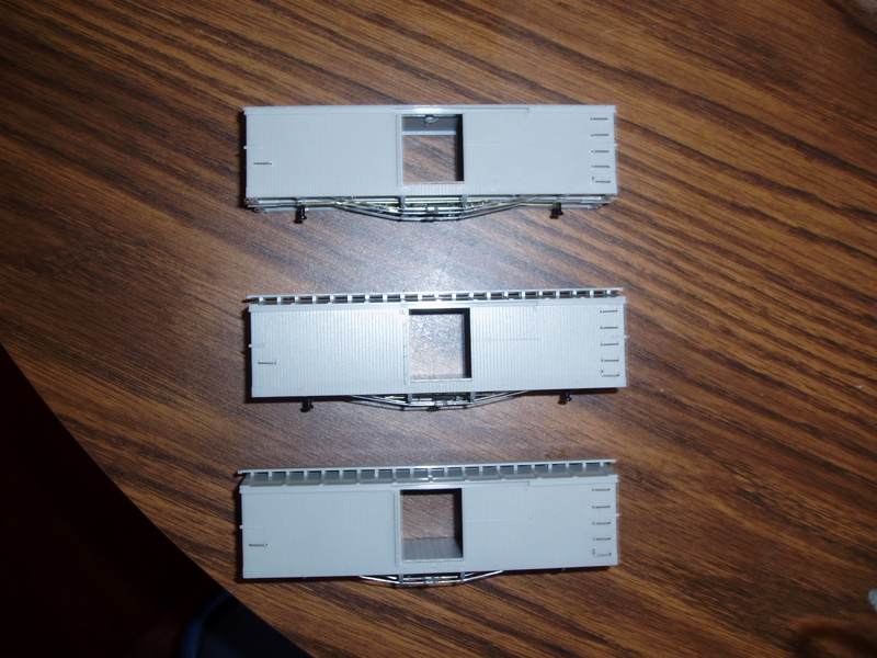

After multitudes of distractions, I have gotten back to work on the boxcars. I have the tedious work done - the grab irons and the brake rigging. These cars are loaded with tiny detail on the brake rigging that breaks easily (no pun intended) If you can closely in one of the pics, one of the brake levers disintegrated so I made a new one out of styrene. The instructions did not indicate making brake rods, so I made those out of brass wire. The trouble with HOn3 cars is that full brake rigging sometimes interferes with truck swing and truss rods. I have found this is more true with HOn3 than with HO standard gauge. So, I didn't attempt to make a hand brake rod attach to the long brake lever because I was worried it may interfere with the functionality of the car. On the bottom of such a tiny car, it wouldn't be seen anyway unless the car was picked up and turned upside down.
I got the grab irons installed, the truss rods in place and glued the tops to the bottoms Misngth Next up is the remaining body details.

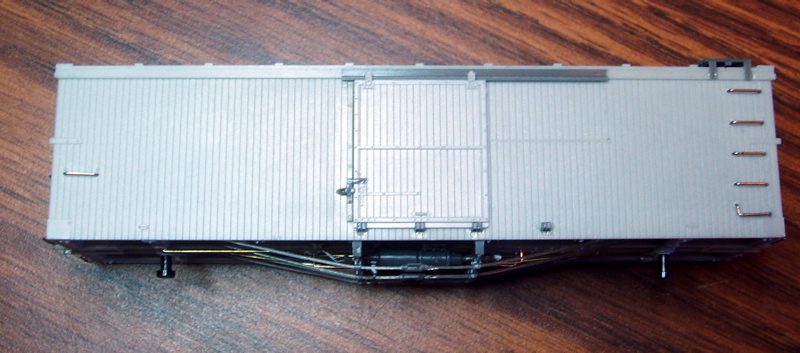

When I was a kid, I really liked boxcars that had doors that could be opened and closed. As I grew up, I realized that real trains rarely have open boxcar doors while in transit, and that the sacrifice for operating car doors was the oversize door slides on the athearn boxcars. Now, I would rather have scale appearance than operating doors. These Rail Line box cars have all the scale parts, and the doors would operate if they are left unglued. The instructions imply to leave the doors unglued, but my experience says otherwise. Being that the parts are scale, much use by 1:1 fingers on the miniscule door slides will certainly lead to breakage. Or handling the car in order to operate the door is likely one will break off tiny stirrups or brake wheels. Another problem is that much operation of the doors will wear the paint from the slides, exposing the shiny plastic underneath. The design also means the doors can be modeled either opened or closed, but glued in position. In deciding how I wanted to position the doors, I considered several things. First I looked at photos on this website:

My conclusion is that in lieu of operating doors, it is probably more prototypical to leave them closed. But, since open doors look cool and add visual interest, I think I will leave one door on one car open.

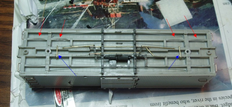

I got into HOn3 because it allowed me to build a smaller HO scale layout and get by with 18" curves and #4 turnouts. I assume many others got into HOn3 for similar reasons. My standard has been that my HOn3 cars should negotiate 18" curves and #4 turnouts. I am convinced that many HOn3 kit manufacturers designed their kits to look good but not necessarily run well. I have found most kits require a little tweaking or modification to get the trucks to swivel right or be able to use Kadee couplers. These Rail Line kits are no exception. Part of the problem is the larger than scale wheel tread widths and truck sideframe thicknesses needed in order to make an operating model. Also, many details are thicker than scale in order to be seen, facilitate installation, and reduce breakage.
Before adding the delicate brake staff and stirrup steps, I decided it best to add trucks and couplers to see if the couplers are at the right height and the trucks mount properly. It's easier to do this now than after the car is painted and detailed - and it's a good thing I did. As designed, these boxcars will probably not negotiate anything less than 24" curves and #6 turnouts with the blackstone trucks because the wheels rub against the truss rods and the floor beams. Trainnut specifically requested that these be running models with working couplers, so I needed to make a few modifications for reliable service.
First, I had to shorten the brake pipe detail I made under the car. Instead of terminating it at the truck bolster, I terminated it at a cross beam closer to the center of the car. I also carved away the inside corner of the floor beam as indicated by the red arrow. I also had to make a brass clip to pull the truss rods right against the center beam and out off the way. I could have simply used CA to glue the truss rod to the center beam, but I was wary of the CA failing over time. In hindsight, the best solution would have been to drill the truss rod holes right next to the center beam instead of where the instructions specified. Nonetheless, all the modifications I made are hidden by the trucks. The cars roll great now, and negotiate my #4 turnouts and 18" curves with ease. They now should handle any tricky trackwork that Trainnut can throw at them Big Grin
