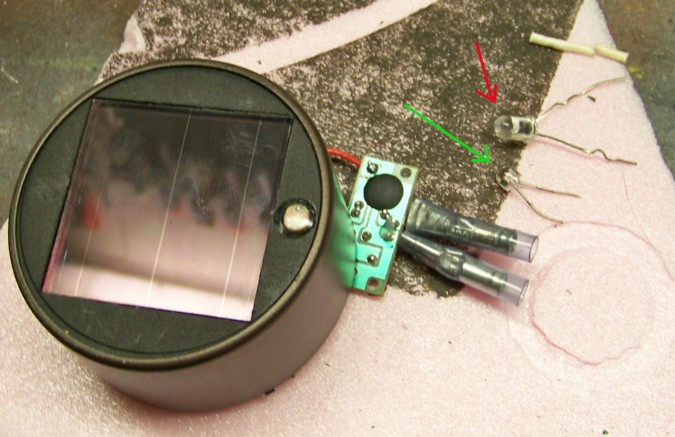

After twisting it's head off Eek I was left with this:
~~ NARA Member # 75
Now it's time to do the usual "How the Heck does this thing work??????
Well - when the sun shines, the solar cell charges up... See that circle at the top of the picture above? -- That turns off the LED and allows the battery to charge... (This is why you need a window near the layout or at least a light that is on a good portion of the day before you want to light the LED.)
Now, when it gets dark.. "Lights OUT" - The circle (CDS Cell) switches on the LED... Simple eh?????
Lights out - LED ON
Lights on - LED OFF
So, now that the mounted LED is working (Cover up the circle with your finger) I proceeded to destroy the garden light - in order to assimilate it into the layout hehehehehehee

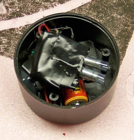

First - Take the screws out of the bottom revealing the innards.....
~~ NARA Member # 75

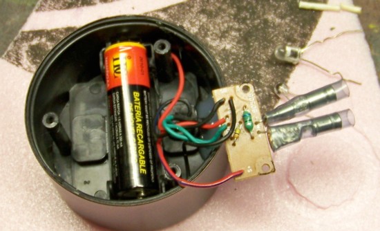

The above picture shows the Battery, the circuit board and the 2 Crimp Connectors I installed after cutting off the LED (It's under the crimp connectors.)
After cutting the wires and attaching the connectors, I then found the High Bright LED and attached Crimps to it too.
This photo shows the tiny "Original LED (Green Arrow) and the newer larger High Brightness Red LED (Red Arrow) before the connectors were attached.

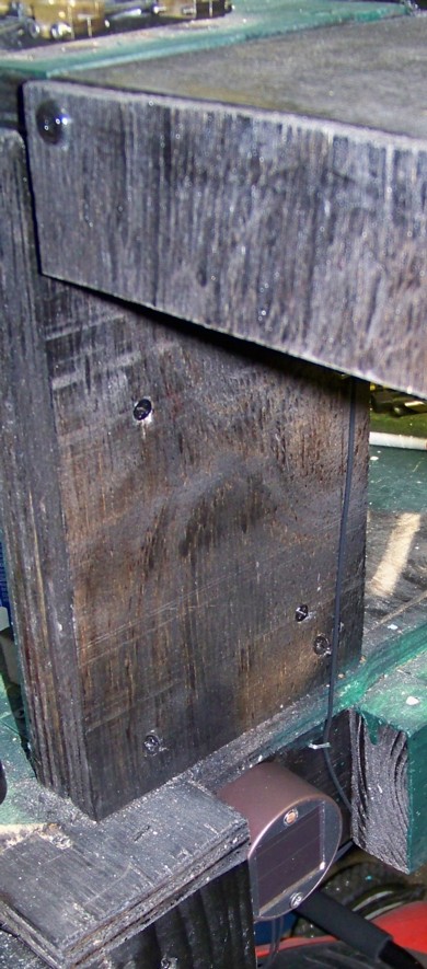

Then I decided where i was going to mount the solar cell on the side of the layout facing the window.

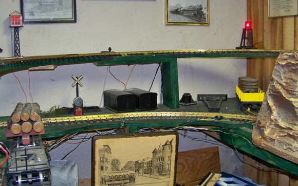

LIGHTS ON:
Lights OFF:
Don't be fooled by the camera flash!! The Room lights were off!!! and as soon as I shut them off. the lighthouse turned on!! Really a Cool effect!!!!!!

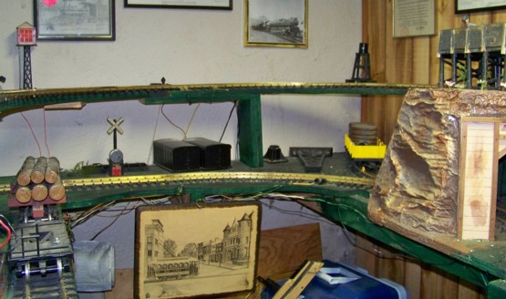

and finally - a pic of where I mounted the head assembly under one of the bridges, where it will get "daylight" from both the window and the flourescent light overhead.
~~ NARA Member # 75
