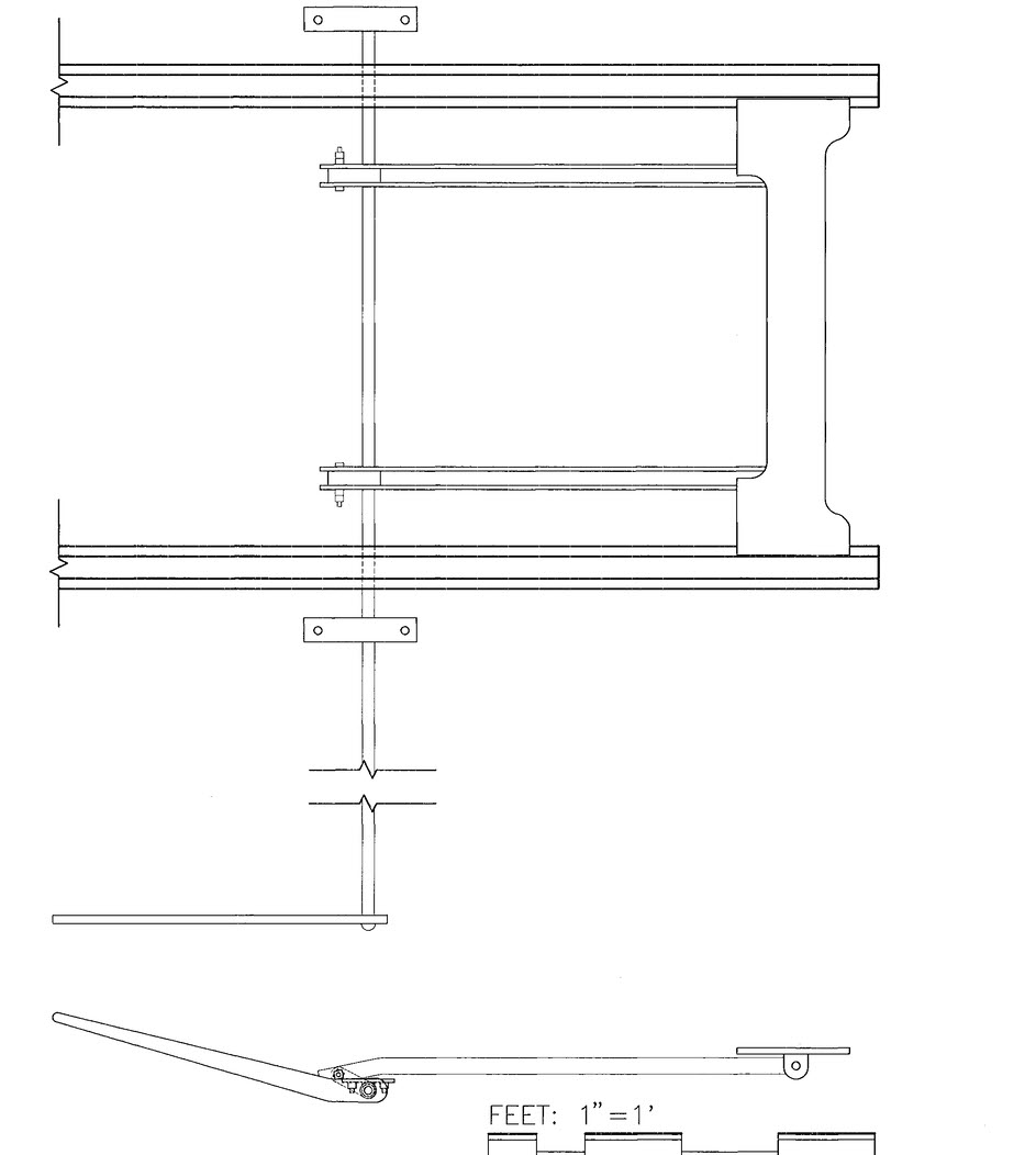

Gary the only reason to have staging yards on your layout is to have storage for excess rolling stock. You could run a track at one end going behind a large factory building to simulate the connection one way. A similar set up at the other end could go to the Galveston warf. The only reason to have a staging yard as such on your layout is if you have so many freight cars that you want to move some off the layout. What you could do in that case is make removable cassettes that would have holes drilled in the center of the tracks on each end to drop in a nail to keep cars from rolling off of the cassettes. The cassettes could then be stored on the walls around the room, and changed out to refresh the rolling stock on the layout.
the last three of my layouts have had storage / staging yards (some thing needed if you have a large amount of rolling stock) one in the open(had a large room then) the last two under the layout ones(a bit of a pain Icon_lol as you might guess) the current plan is to have a 10 ft by 42 inch section on slides under the layout but it will be slid out to work on it or make up trains the big problem with this is alliment but as it only has one access track i found the answer in plan for a old turntable locking system (photo below) by having the first inch or so on the yard track real rigid it should work. and a solid lock on the slides.

And Jim ... Nice drawing! Thumbsup The lever, the eccentric link, the slides ... I like it! I may use that arrangement where I designed in a scenicked "roll-away" section that will take the place of a hinged drop-down or swinging "gate." I'll need to lock it at both ends, but I designed the unususal removeable element because I'm not at all interested in a duck-under to get into my bedroom!*
And I can't find "sceniced" or "scenicked" any any of my four dictionaries or in the Encarta on-line dictionary either ... but the scenicked "roll-away" section of my layout is planned to include a bascule bridge crossing the Lehigh River between Weissport and Lehighton. There! In the dictionary or not, I'm still going to use it ... it's a model railroad-coined word!
