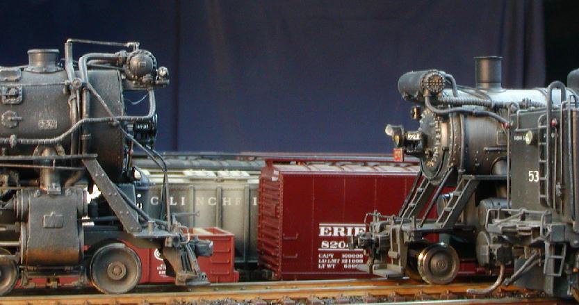

I love Elesco heaters! They look particularly nice over a Pyle headlight, like that on the Erie inspired JGL 2-8-2 on the right in this photo.
