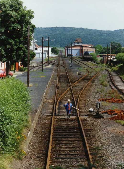

I had a little helper with a stick, this stick was in H0 just 1 cm!
[Image: naubfgr.jpg]
And for my church at Salina I used Google. I measured the Grandt Line windows which were 22mm tall. In the printed picture the window was 36mm tall. This way I've got the size.
Wolfgang

Either that guys is very short or those rails are very wide.
Gary S Wrote:Either that guys is very short or those rails are very wide.
Standard gauge, and my son was about seven years old. 357

Oh!!!! 35
Now I see it! I didn't look that close, I thought that was a railroad worker! No wonder he seemed so short! Big Grin
Interestingly if you take Wolfgang's photo as an example we have present a variable yardstick and that is the rail gauge as it diminishes into the background.
So lets say for argument you wanted to know the size of those two garage doors on the white house to the left of the tracks in the centre of the photo?
How do you measure them? Well we know that the gauge is most probably standard gauge at 4' 8 1/2" or 1435mm, so then if you measure the track width when level with the garage doors you will have a known dimension to work from. We also know from personal experience that the doors in all probability must be able to have a car drive through so that will act as a checking measurement.
