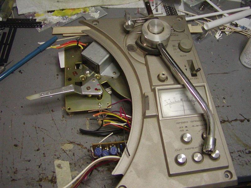

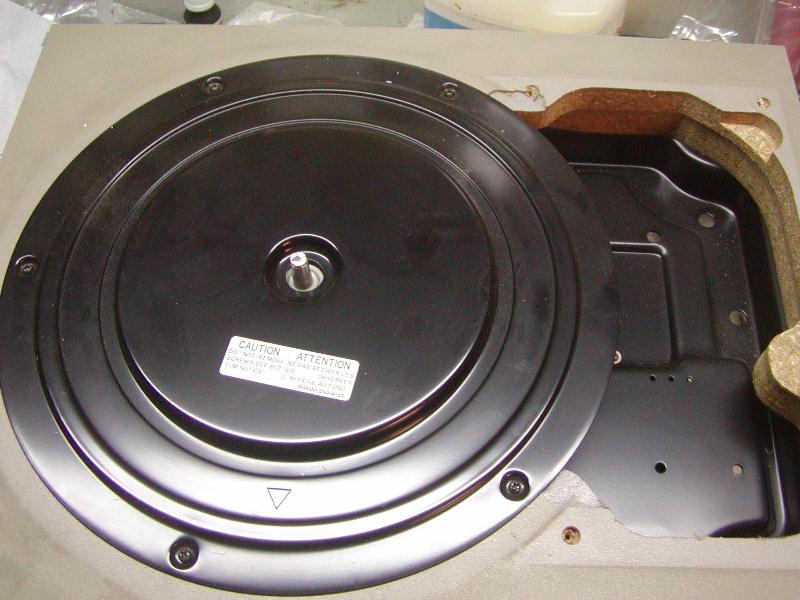

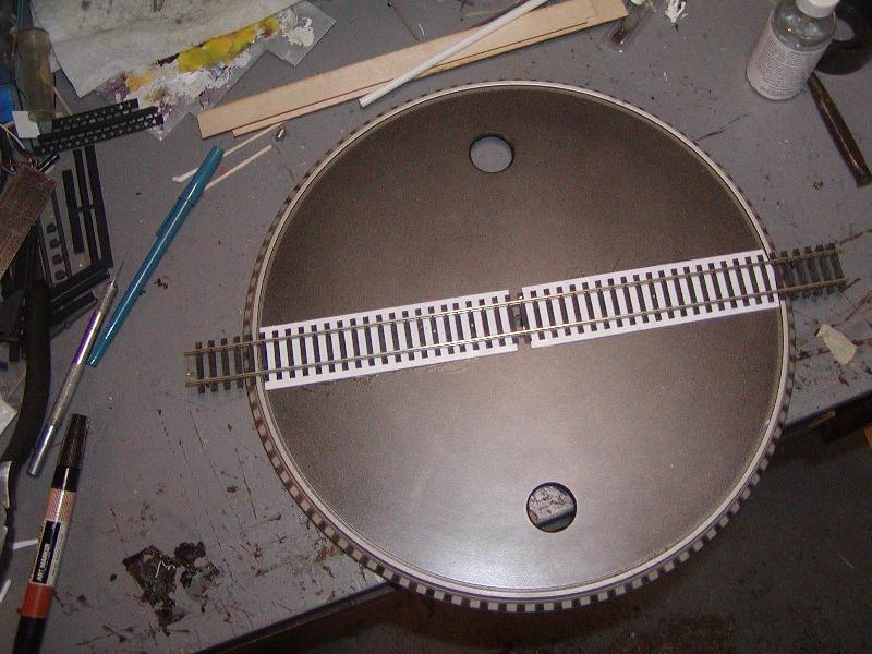

Or, A turntable..from a turntable. Many of you probably saw my white glue and l girder thread. So I was happily running stean locos thru the relaid curve adn quickly realized it was time to do something about being able to turn steam at the west end staging yard. I built the turntable and roundhouse at the east end servicing facilities about a year and a half ago but because of the problems with the curve hadn't really run much steam on the mainline. So last night after dinner I tackled the west end turntable. Literally a turntable! A Pioneer PL560 direct drive turntable that I had given up trying to repair when it kept auto returning prior to reaching the end of a record. Yes, I still play albums! I have (had) two turntables. So, removing the top and bottom screws and clipping a lot of wires enabled me to remove the tonearm and associated mech, leaving the direct drive motor intact and in place. Here is what it looked like after using a Dremel cut off disc to remove some of the spindle:

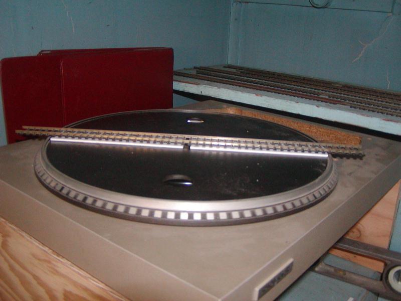

For giggles, here is the mech I removed. I kept the headshell and cartridge, what you see here is in the garbage.

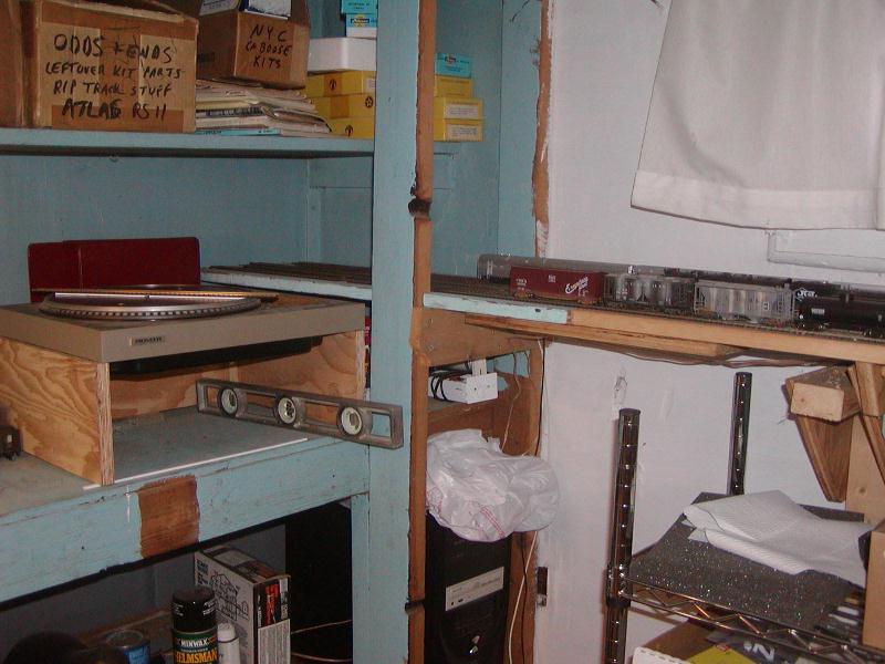

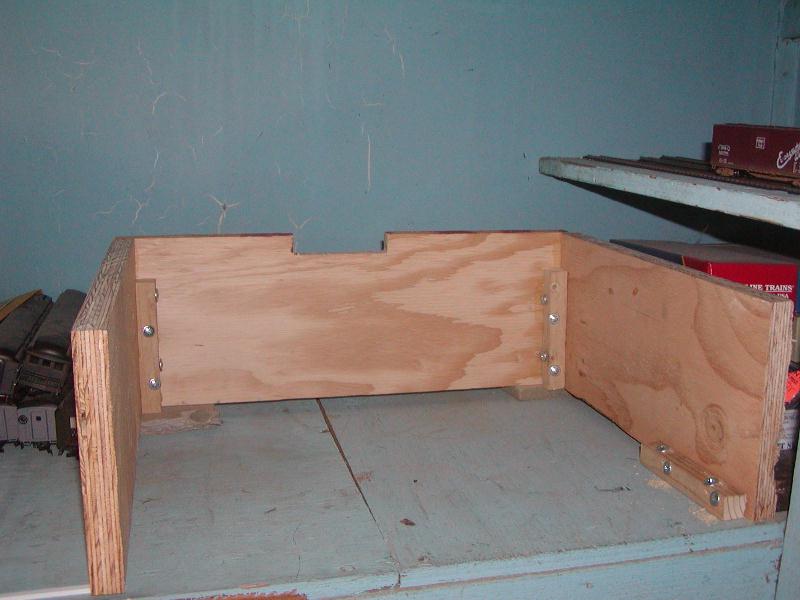

I built a three sided box from 3/4" plywood, at the height needed to get the turntable where I needed it. The shelf it sits on was so out of level I had to put 1/2 homasote blocks under the rear!

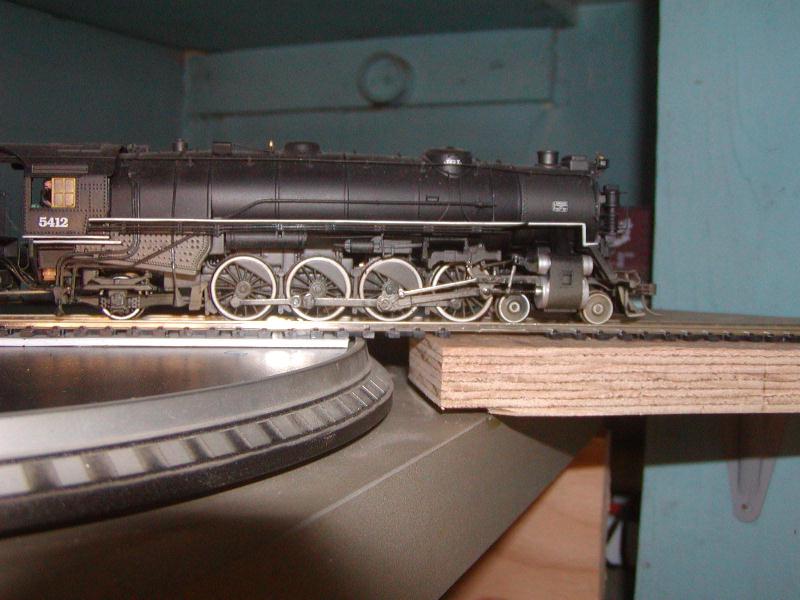

After discarding the rubber mat, I measured a .080 lip around the platter. So I used .080 styrene to make a "bridge" across the turntable, leaving a gap in the center for the shaft. I then glued a piece of flex track to the styrene. I made it 15" long, overlapping the ends about an inch, to accommodate the same length locos as the other, real, turntable.
Here it is, sitting in it's box:

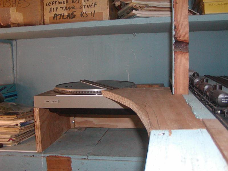

I cut the required wood and ran supports from under the existing roadbed. I found an old Atlas # 6 turnout in a box and it is sitting where it will be cut into place.

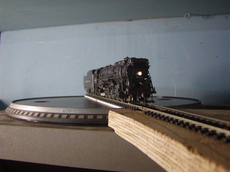

And at the turntable end. I had to remove one ply from the bottom of the plywood, and repalce it with .60 styrene, to get the height to match the track on the bridge. I used barge cement to fasten the styrene/wood to the turntable top and clamped overnight. I'm ready to lay track! Track power and alignment will be thru the use of sliding railjoiners. I'm not sure how relaible the electrical connection will be over a period of time, but I can replace the joiners if they get widened or dirty.

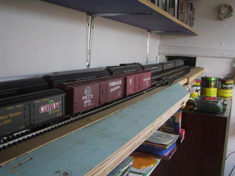

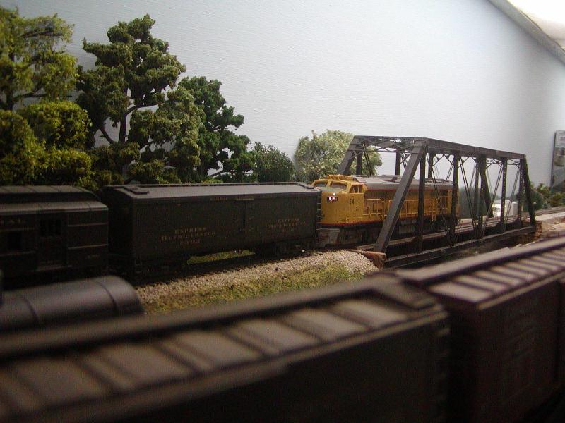

Utilizing my Lionel turbine to push trains into the staging tracks. I attached to the rear of the passenger train in staging, and pulled it backwards most of the length of the railroad to use the Garfield Industrial track as a wye. Can't do that with some of the steam, too tight a radius there. Here, I am pushing back into the staging area thru the last scenicked area prior to staging. Actually, setting up for the next session is fun in itself!
