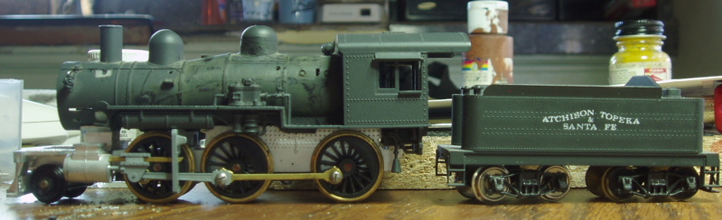

I wanted a distinctive little 2-6-0 that keeps other modelers guessing as to its origin. The few available non-brass moguls don't capture the look I am after. I want a relatively small 2-6-0, built around 1890, but modernized somewhat around 1910, and still works hard doing switching on a shortline somewhere. This Frisco loco is about what I am looking for:
<!-- m --><a class="postlink" href="http://thelibrary.springfield.missouri.org/lochist/frisco/friscoline/images/photos/P01523.jpg">http://thelibrary.springfield.missouri. ... P01523.jpg</a><!-- m -->
I had an IHC 4-4-0, but thought the tender was too big, and it would not run on my code 70 rail. Then I bought a junker MDC old time 2-6-0, used the boiler on an HOn3 project, and planned on using the old-time tender behind the IHC 4-4-0. The problem was, the 4-4-0 looked HUGE compared to that tender, and then I realized it wasn't just the tender that was too big, the whole loco looked to big to be a 4-4-0 (it is actually a SP 2-6-0 prototype with a 4-4-0 chassis). So, I decided to mount the IHC boiler on the MDC 2-6-0 chassis. It fit reasonably well, the boiler looked to big and long, so I cut the boiler shorter.
This is where I am at now. I like the overall lines of the loco/tender combo, so I think I will start scraping of the rest of the cast on details and put the thing together.

Am I correct ... that tender is an IHC 4-4-0 American tender? It has a delicious Taylor overall appearance ... I'll have to keep my eye open (well, maybe both eyes -- they're probably not abundant these days!) Taylor Tenders are us in Camelback land! And Taylor Trucks, too.
You're off to a nice start. I can see vestiges of Varney lineage in the boiler lines and a little SP in the cab configuration. But then, I can't be sure ... Varney was a long time ago, memory fades and it took me a while to realize that S.P. and Espee were the same animal. :oops:
Ten-Wheelers are cool little dudes! They go about their day unnoticed and overshadowed by Atlantics, Pacifics, Berkshires and Mountains, with only one more pair of pony wheels than the lowly Peddler Mogul. But cool little dudes, all the same! I'll enjoy this build!

That's actually the stock MDC tender. The IHC 4-4-0 I used for the boiler shares the same tender and boiler with their 2-6-0. I am told the 2-6-0 used to be offered as a tender drive loco by someone else (Pemco?). The former tender-drive is why the IHC tender is too big. I know Dr Wayne has cut that tender shorter, but I decided I like the lines of the MDC tender better. I don't think this 2-6-0 was ever offered my anyone else besides Pemco. I know Varney had a 4-6-0 that looked kinda similar.

Wayne, grinding off all that die cast detail is a PITA. I wish more kit manufacturers would have just left that stuff off rather than cast it in with the boiler. I filed off the details of a few MDC boilers - and tried not to file off rivet detail or clog too many files.
Nice work on those piston valves. Ironically, the piston valves are one thing that kept me from using the IHC 2-6-0 and 4-4-0 as-is. I figure a shortline would mostly use secondhand locomotives for switching, about 20-30 years old. So, in 1920, they would be using vintage 1890-1900 locos with slide valves. I still think I will keep the steel cab and maybe the two -stage air pump - thinking my railroad could have added those around 1910.
