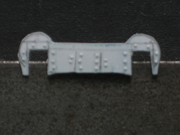

I wanted a set of pressed steel fox trucks for my coke cars. I was having trouble finding some at a reasonable price so I'll try to bash some together. I started by taking some measurements from a set that I had and made a master.     I added a set of journal boxes but deleted the pic.

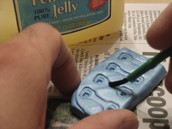

next I pressed it into a blob of Sculpey clay a few times. I wanted to do a few more but wrecked the master after 4 imprints so I hope they work out. Into the toaster oven it went for a few minutes to set.when it was cool I coated the mold with a ""thin"" coat of petroleum Jelly for a mold release.

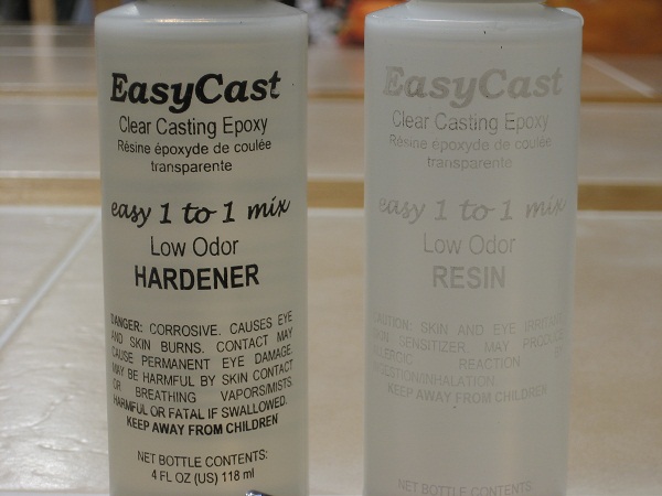

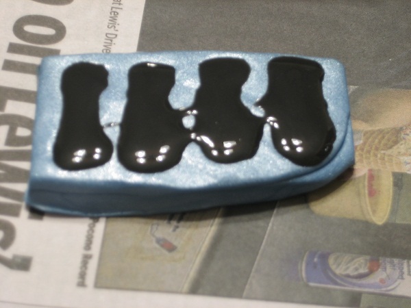

I fond some casting resin at the craft store that dries Cristal clear     . I experimented with it a few times and am happy with the results.I mixed up a batch and added a few drops of black paint to it and poured it into the mold. thinner castings take a wile to cure completely so I'll demold in a few days.I have to make enough for at least 3 cars so it's a slow process.

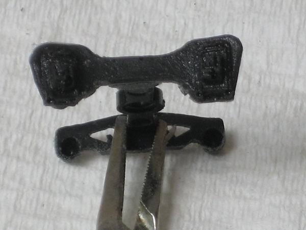

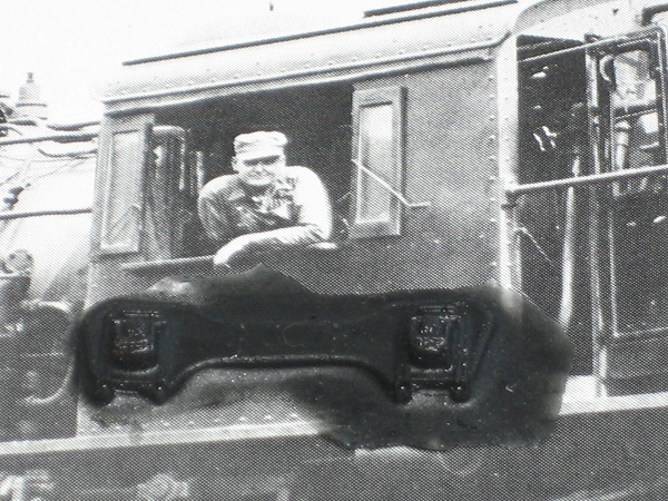

Out of the mold they came, flashing cleaned and mounted on a athearn truck with the detail filed off.
I'm having trouble with air bubbles, but as a first try it shows promise. I'll keep on playing around with my technique till I get it right. you get the Idea of what I'm going for.

To defeat air bubbles you must first not introduce any into your casting epoxy. Yeah, I know that sounds like a "duh" statement, but it is critical! When mixing the catalyst into the epoxy, stir gently, slowly and mix thoroughly without any undue "splashing." You needn't stir violently to get a thorough mix.
The next step is to eliminate any air bubbles that have joined the party despite your best efforts to avoid them. Then, when you make your "pour," do so slowly and from a height that allows the liquid being poured to "neck down" to as fine a stream as you can. The premise is that any bubble larger that the stream at the point of contact with the mold will break when the stream gets narrower than the diameter of the bubble.
Next, so as not to capture any air which may manifest itself as a bubble on the actual surface of the mold, start your pour in a corner and keep it there, letting the casting liquid spread out across the surface of the mold. When the mold cavity you are pouring fills, quickly move to the next mold cavity and stay in the corner where you begin the pour.
One last thing. Surface tension. Although the use of petroleum jelly seems like an intuitive choice for a mold release, it has "dimension" and may impart that dimension to the finished part, yielding an imperfect surface on the final production part. When I was in design school (in the mid '60's and then again in the early '70's) and taking the class where we did patterns and molds and master molds from which to cast production molds, and then had to produce a run of "parts," we used a solution found in the pharmacy called "tincture of green soap" as a mold release. It had a very low coefficient of friction and was a marvelous mold release. You may find other substances that will work as well (Pam, maybe) but gently brush it on the surface of the mold, paying attention to a smooth surface and no bubbles.

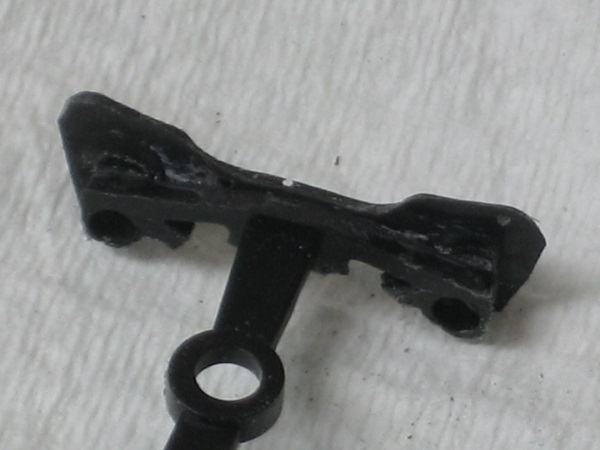

Thanks everyone... What I found is that I need to use even less mold release and less paint. I did notice what Bil said about the petroleum jelly and using less is giving better results. The paint thickened the mix quite a bit cutting it back to a single drop makes it easier to pour. The last step that I added is to put the mold on my 2 month old's vibrating seat for a few moments to shake out the bubbles.
Here's a pic of a sample from the last batch.
Even engineer Fred thinks that I'm getting better at this.

Much better IMHO.
