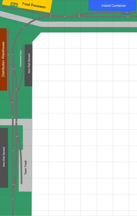

So this is an idea I am considering, It is based off one of my earlier designs, I know it looks bad at first with the switchback, but it is long enough where it adds to the operation rather than making it harder. I plan on adding an abandoned industry on the switchback lead.
The layout will use Micro-Engineering track with a 28" radius and #6 Turnouts code 70

Justinmiller171 Wrote:So this is an idea I am considering, It is based off one of my earlier designs, I know it looks bad at first with the switchback, but it is long enough where it adds to the operation rather than making it harder. I plan on adding an abandoned industry on the switchback lead.
Might be able to add more to it. I think that the food processor and inland container are kinda cramped. one of those industries should move to the corner, but thats just my opinion.

Green_Elite_Cab Wrote:Might be able to add more to it. I think that the food processor and inland container are kinda cramped. one of those industries should move to the corner, but thats just my opinion.
Yep, That's what I was thinking.
I'm not really certain on what I want on my layout, I may need to look at some other ISL plans for inspiration.(Hint) Icon_lol
Justin Miller

Something like this perhaps?
Ed
FCIN Wrote:Something like this perhaps?[ATTACHMENT NOT FOUND]
That looks pretty good, though I might lengthen the bottom-most section of track after the run around, so to fit two geeps. Not 100% necessary, but then anything will fit.
personally, i might swap the places of the team track and the abandoned siding, so that the trains spread out a bit more, as well as reverse the direction of the switch to take advantage of that run around a little more.
those are just my opinions though. Overall, i like that plan.

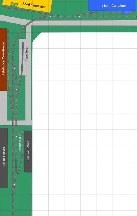

More like this?     Does give you two industries that switch from both directions making better use of the runaround track. I figure that you'd just be using one engine at a time, so didn't lengthen the tail track, but of course you could shorten up the runaround by a foot and add that extra length if you desired.
I'd treat this plan as though it was either a portion of the main line going through a small town or a branch line that terminates at a small town. I'd stage the train at the upper right end of the main line as though it was just coming into town and work the industries as required. Then runaround the train and head back to where ever the train originated.

Wow thanks guys! You two make a good team. Thumbsup
I really like that plan Ed,I prefer Plan 1 as is gives a more "Concrete Canyon" look , I plan on just using a single GP15-1 so the tail track should be fine.

Justinmiller171 Wrote:I'm probably not going to start anything for a few months, so I plan on doing things such as weathering freight cars in the mean time.
Good idea there Justin! Give yourself plenty of time to just think things over, but yet keep yourself busy doing little projects that will keep your interest peaked. Acquire more cars (and the always present desire to add more engines) as finances permit, weather them or whatever.
No doubt some other ideas will come along and this plan could no doubt be changed here and there. As it is, Inland Container is a bit short on track length and even reducing the curve to 24 inch radius wouldn't add much to that spur. But then again, you might come up with another industry that you like better.
GP15-1 or GP15-T nice choice for motive power - Conrail, CSXT or NS if you're still thinking about that theme. Heck, CR GP15, CSXT GP40/38 and an NS high hood GP38 for variety if you're thinking of Conrail Shared Assets as a theme.
Ed
My Versions of FCIN's design, Some industries may look familar :?
