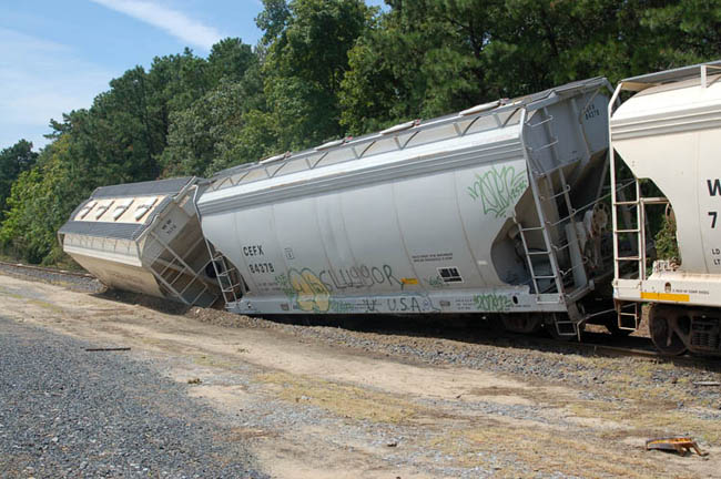

Here's what happens when someone on the switching crew doesn't spot the blue flag derail.

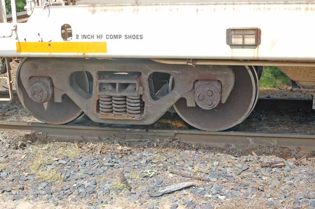

#38
Just out of curiosity. What am I supposed to see in the first photo? Or is it just a gratuitous shot showing a set of trucks sitting over a gap in the rails? 35
#39
tetters,
The yellow piece in front of the wheel is the derail with the blue flag. The photo doesn't show the blue flag it was laying next to the inside of the rail.
