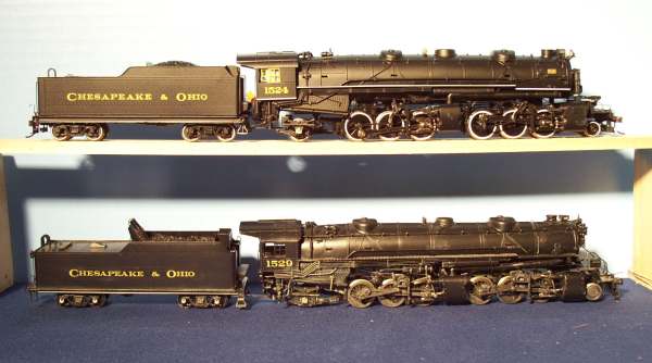

Which brings me back to your # 1524 from Bachmann Spectrum. ( which I also have )
The only real difference between it and the Akane USRA 2-6-6-2, is the front end. The placement of the compressors/pumps, the smokebox door, that step on top of the headlight, and the switcher style pilot, which I haven't seen in any of my C&O H class photos.
Ahah !!!! just noticed the builder's plate on the Bachmann....it's American Locomotive Company !! The USRA design H-5 was built by Baldwin.
An ALCO 2-6-6-2 would have to be an H-3, H-4, or H-6 . The Bachmann ( #1524 ) more closely represents a class H-6 ( #s 1475-1519 ) the 1300-1309 H-6's were Balwin built.
Ahah again !!! ( http://www.steamlocomotive.com/2-6-6-2/?page=co ) shows that thirty were built, and 20 by Alco, so I stand corrected. " Things usually starts very harmless... " was a very appropriate title for this thread....harmless... until I open my mouth !!
None the less, the Akane USRA 2-6-6-2 is still closer to the photo, than the Bachmann. I still want to see a photo of one of the C&O H-5 2-6-6-2's,,,,,,,,,and I'm still looking.

That ^ photo, looks just like the Akane, which I have lettered for the wrong road!!! The Akane is a Baldwin, and was exclusive to the Wheeling and Lake Erie ( the photo link has WLE in it )......which also means that the Bachmann is probably more correct for the C&O. I got caught using only one reference, without photo verification. :oops: :oops:
I'd still like to see an actual photo of a C&O H-5.
Anyway, the Bachmann is the top, and the Akane is below it:
I would expect the cab to be the straight front USRA design.

After painting it all matte black it is time to took a look on the prototype photo again.
![[Image: dsc02701ngkg.jpg]](http://www.abload.de/img/dsc02701ngkg.jpg)
A look from the side. You can't see thru under the firebox, the "ashpan replacement" in form of an single styrene stripe prevent it.
The shortened tender with its new bunker extension.
![[Image: dsc02703igjx.jpg]](http://www.abload.de/img/dsc02703igjx.jpg)
And that was the left over section. Bachmann made the botton extra thick to prevent model railroaders from drilling holes for installing speakers and sound decoders in soundless locos?
Greetings Lutz
