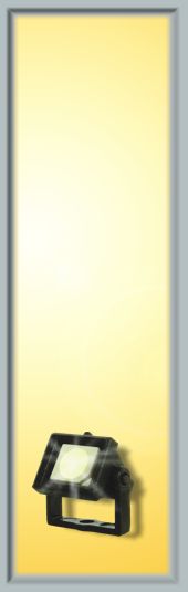

Gary,here is a company who makes these flood lights.Check it out <!-- m --><a class="postlink" href="http://www.rocousa.com/detail.asp?product_id=vi6333">http://www.rocousa.com/detail.asp?product_id=vi6333</a><!-- m --> They're kinda pricey at $10 to 15 dollars a piece.I have seen them on Ebay for about $10.99
<!-- m --><a class="postlink" href="http://www.ebay.com/itm/Tiny-SMD-LED-Flood-Light-Ready-Go-Viessmann-/380184741290?pt=Model_RR_Trains&hash=item5884c6c5aa">http://www.ebay.com/itm/Tiny-SMD-LED-Fl ... 5884c6c5aa</a><!-- m -->
Or there is this option <!-- m --><a class="postlink" href="http://www.ebay.com/itm/20-leds-wired-0805-SMD-LED-Warm-white-12V-/120831807396?pt=AU_Toys_Hobbies_Model_Railways&hash=item1c22230fa4">http://www.ebay.com/itm/20-leds-wired-0 ... 1c22230fa4</a><!-- m -->
