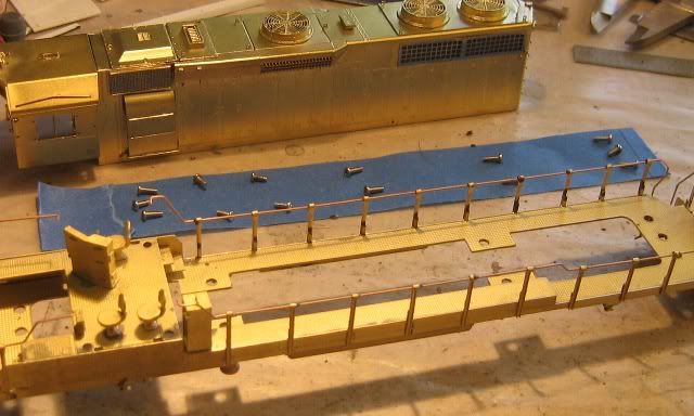

I’m always concerned about losing all those little screws, so I have a procedure that I follow when I take things apart and this is as good a spot as any to mention it. The safest place to keep those tiny little machined buggers is right back the tiny little holes they came out of. But they must be placed somewhere until they’ve all been removed and the parts in question have been separated.
My solution as to what to do with them while they’re being removed is …
[Image: KeepingtheScrewsinProperOrder-1.jpg]
An upside-down piece of blue painter’s tape is helpful in keeping the screws in the same general locations and relationships to each other until they can be replaced in the holes they came out of.
So, now we have reduced the model to the four main components – the short hood, the cab and long hood, the walkways and end platforms and the chassis/power truck assembly …

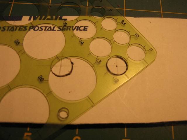

In an effort to reduce “clean-up” after airbrushing the wheels of the power trucks, I made a “Kwikie” Power Truck Wheel Mask …
Using my calipers, I measured and marked off the axle centers of the drive trucks, drew center lines, and marked the circles with a pen and one of my circle templates …
[Image: DrawingtheCircles.jpg]
… cut around the circle with a #11 blade …

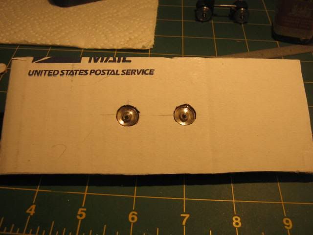

[Image: ReadyforUse.jpg]
… and slid the drive truck in from behind …
[Image: TheWheelMaskasPurposed.jpg]
After a quick trip out to the garage, we have Grimy Black wheel faces, just aching to be weathered …
[Image: PaintedWheelFaces.jpg]
Patience, little round guys … the time will come!

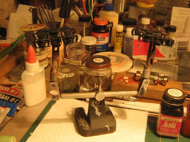

The truck side frames were reassembled and set up in “third hand” gripper, given a trip out to the airbrush station in the garage and …
[Image: TruckSideframePaintingSet-up.jpg]
… and when the humidity shot up due to a local downpour, the took up residency under the heat of a high intensity bulb …
[Image: WatchingPaintDry.jpg]
… and now the truck side frames are Grimy Black and awaiting some weathering …
[Image: Detail-PaintedTruckSideFrame.jpg]

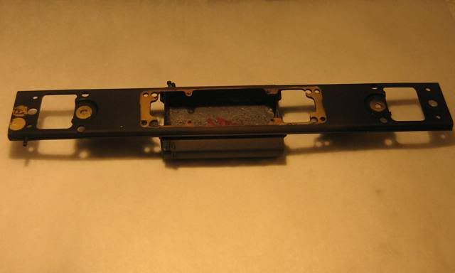

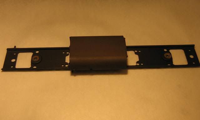

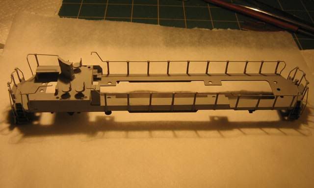

No rain today … just cold … upper 40’s this morning! But by mid afternoon, with the mercury in the garage in the 60’s, I stirred the paint jars and took them out to the airbrush work station and let the pigment fly. First up ... the Cab Interior–Walkways–End Platforms/Pilots (which had been primered two days ago and masked off last night) got a coat of grimy black on the underside …
[Image: CabInteriorWalkwaysEndPlatforms.jpg]
[Image: Underside-CabInteriorWalkwaysEndPlatforms.jpg]
The Chassis had a few small areas masked and it also got a coat of Grimy Black. I couldn’t help myself, though …
[Image: ChassisinBasePaint.jpg]
… yeah … I had to hit the fuel tank with my Grimy Road Dirt mixture …
[Image: Underside-ChassisinBasePaint.jpg]

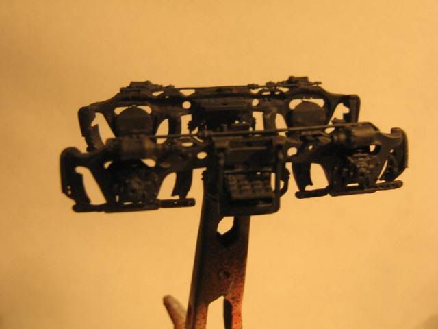

The trucks were then assembled and given a light dusting of the Grimy Road Dirt mixture …
[Image: FrontTruck-InitialGrimyBlack.jpg]
[Image: RearTruck-InitialGrimyBlack.jpg]
