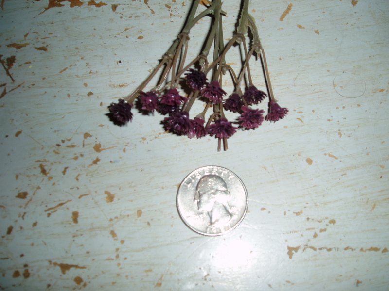

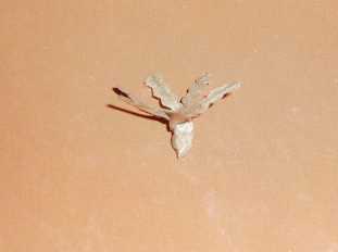

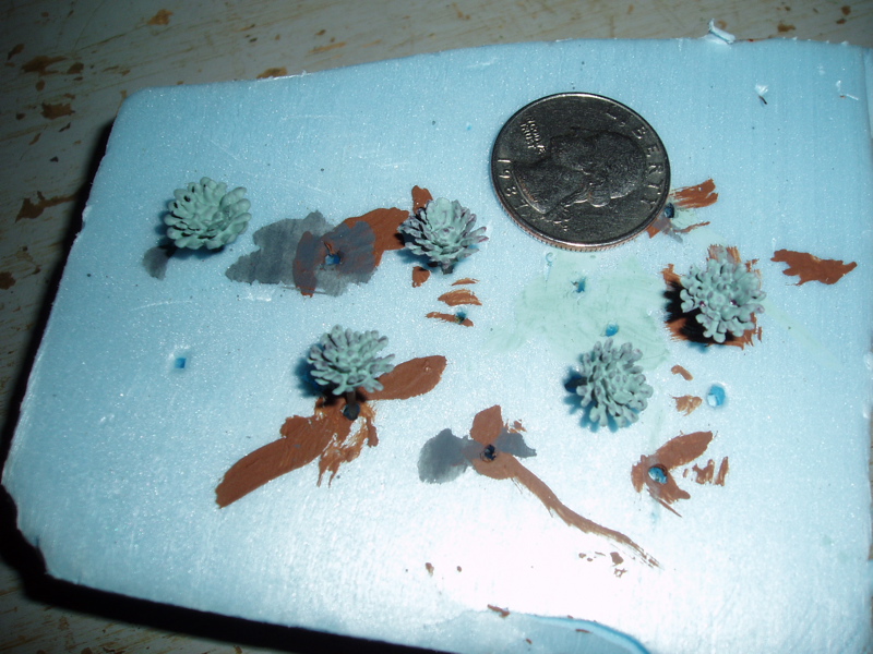

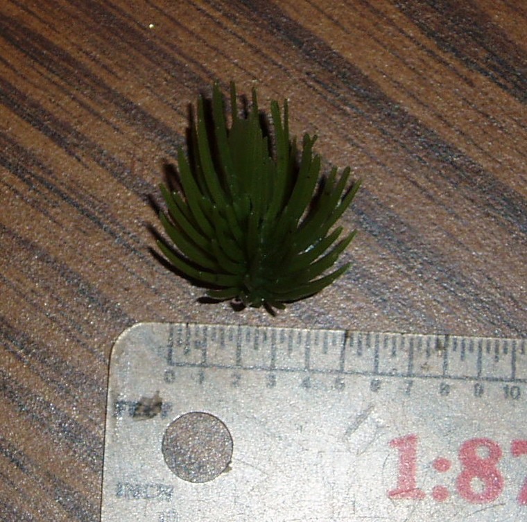

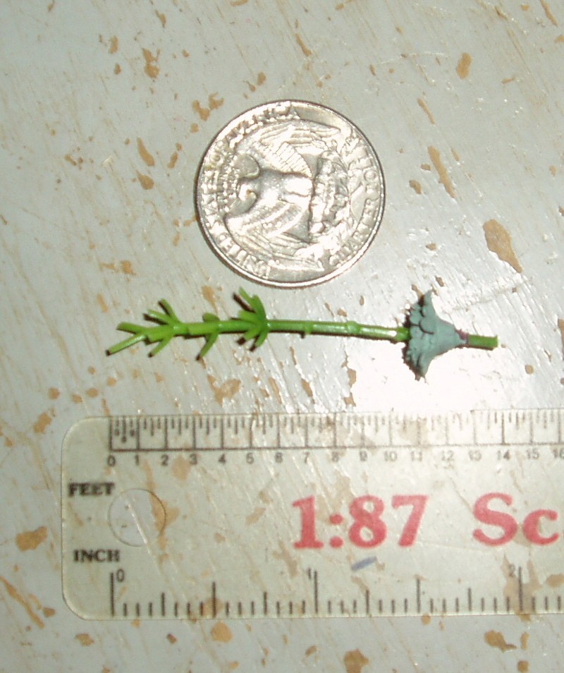

To make my model plants, I walked up and down the plastic flower aisle at the local craft store until I found suitable materials. First up is this cluster of small flowers. The individual flowers resemble the rosette of the century plant. Unfortunately, they only scale out to about 3 scale feet in HO, so my plants will be a little small.
Once I cut off the individual flowers, I shoved the stem into a block of foam, and painted them using a "cactus green" color craft paint.

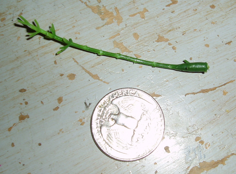

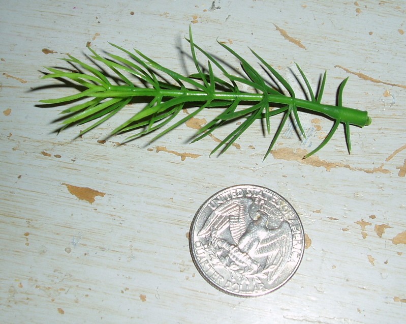

For the bloom stalk, I found this plastic asparagus fern.
Great stuff Kevin! Looking forward to more of your techniques. Thumbsup

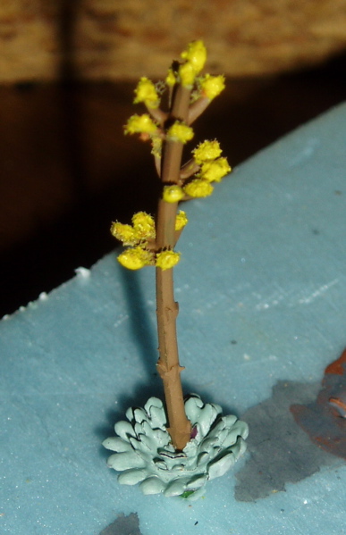

Next, I took some scissors and a hobby blade to the asparagus fern. I cut off all the leaves except for those near the end, and trimmed the end leaves shorter. This made the bloom stalk.

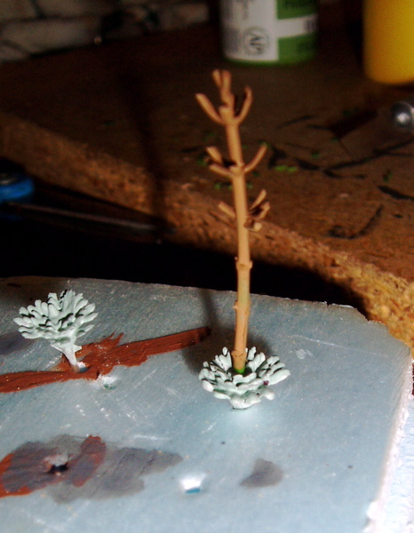

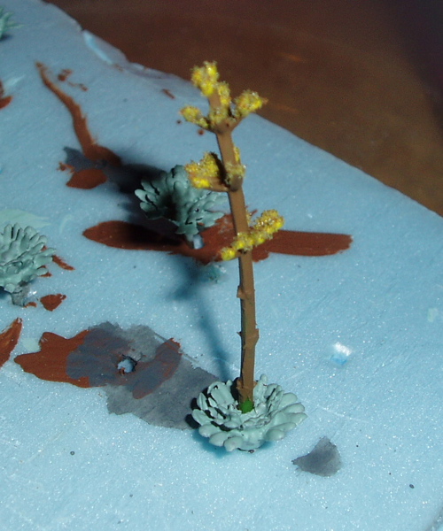

I then drilled a hole through the rosette, cut the blunt end off the stalk, and shoved the end of the stalk through the rosette until the overall plant height was about 12-14 scale feet.

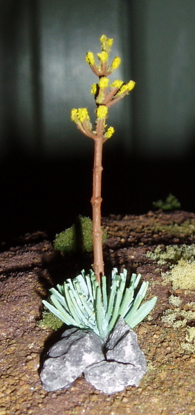

Next, I painted the stalk brown.
I painted the top sides of the stalk "branches" with yellow craft paint, and while the paint was wet, I sprinkled on a greenish yellow fine ground foam. Yellow ground foam would be better, except I did not have any.
After the paint had dried, I shook off the excess foam, and then painted over the foam with more yellow paint.

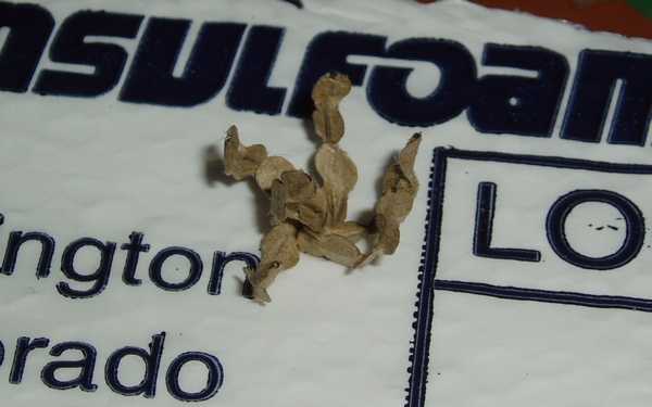

I also found this pine branch in the plastic flower aisle, and thought it would be good for the basal part of the century plant. It's a little on the large size, and takes a little more work to trim down and paint.
I like the results, but I think the finished plant is a little too big. Plants are one of those layout items that often look best if you make them a little smaller than scale. It makes your layout appear larger, and creates a depth illusion.

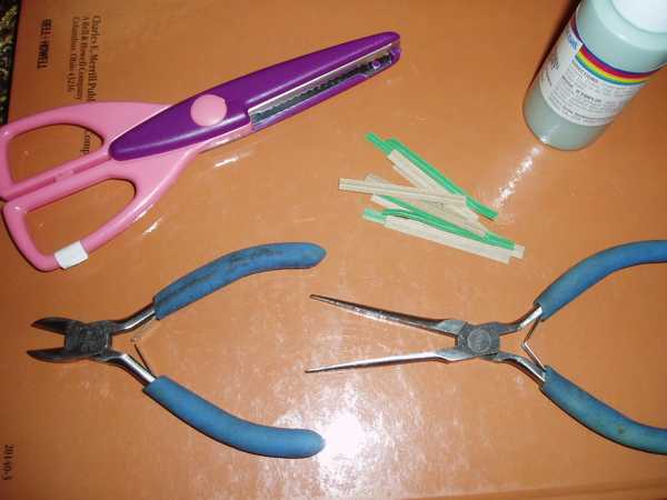

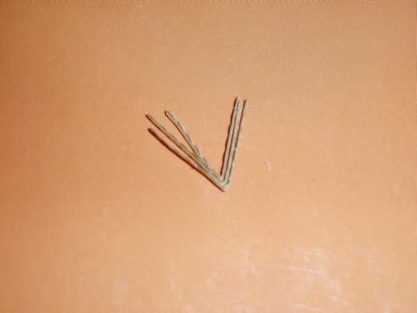

I start out with paper twist ties pilfered from the produce section of my local supermarket, some scrapbooking scissors that produce a scalloped cut, and various pliers and cutters.

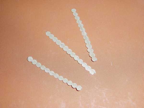

I use the scissors to cut along each side of the twist tie next to the wire. The result looks like a string of joined circles.
I then take the cut twist ties, cut them to an appropriate length, and bend them in half.

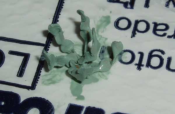

I then nest a few of the twist ties together, and twist the bottom portion to form a base. Sometimes I have to put a drop of glue on the base to glue the individual branches together, as the twisting alone is often not enough to hold it together well. Next, I fan out out the branches.
I continue twisting and fanning out the branches to give a more natural shape. The individual pads of this plant are typically at an angle to each other, so with two pairs of pliers I slightly twist each branch between the pad segments.

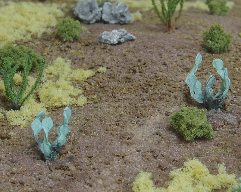

Next comes paint. Again, a block of foam helps hold things while I paint.
With a little india ink weathering, they are ready for planting. I haven't tried making a prickly pear with blooms or the red fruit yet. Perhaps gluing on a few of the woodland scenics "apples" would look good, or maybe I can find some little red beads at the craft store.
