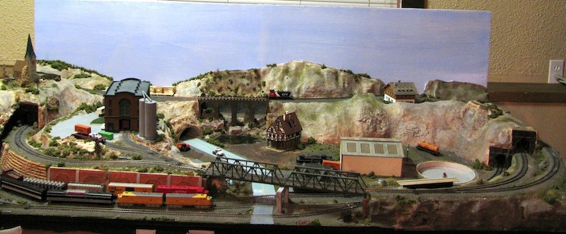

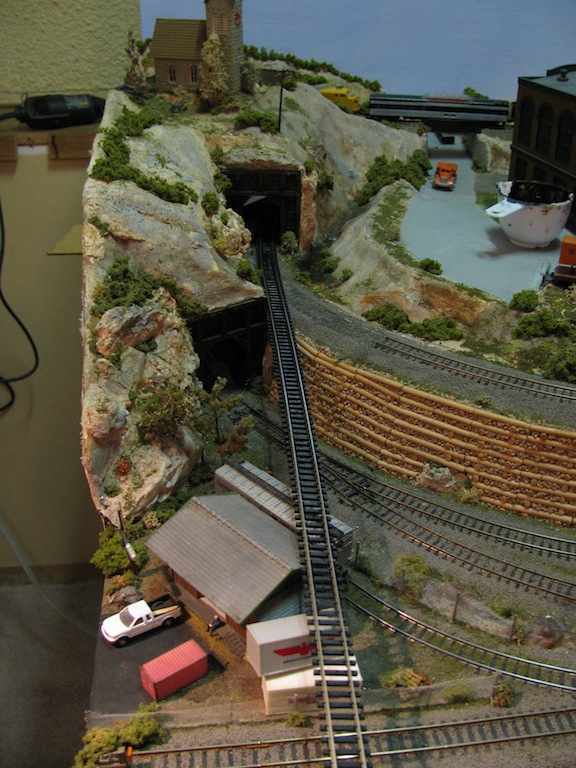

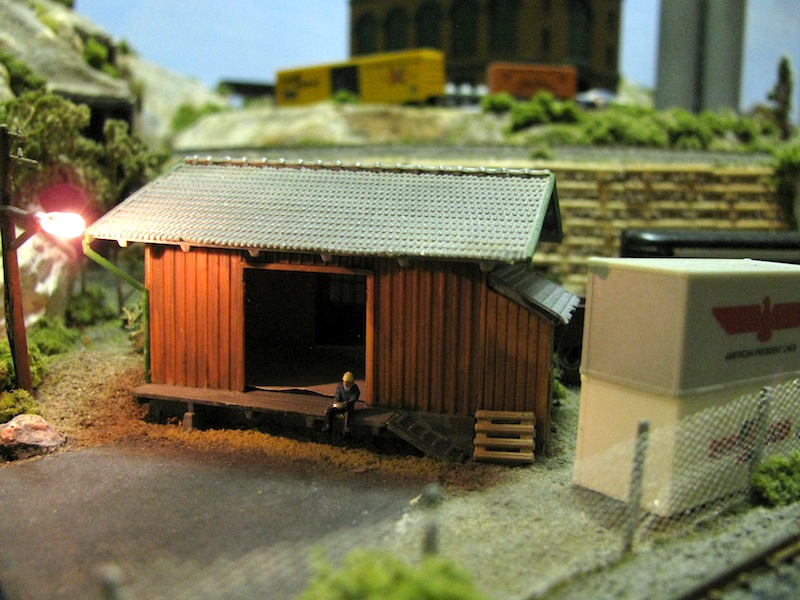

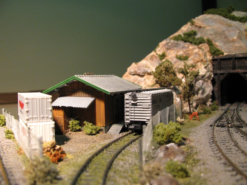

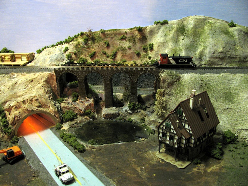

Here's a quick post with a few photos:
I didn't get any work done today on the layout, as it was a beautiful sunny day - worked on my pond instead. Did do some work last weekend, so I'll post those photos maybe tomorrow.

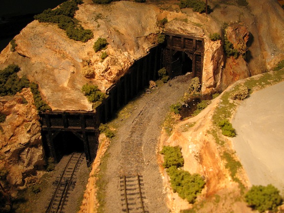

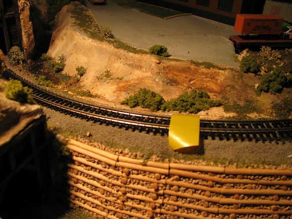

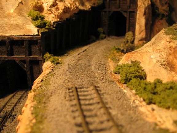

A project from a couple of weekends ago was to replace a section of track that was causing me issues. I had tried a few times to fix it to no avail. So, I cut the track with my Dremel, soaked the ballast with plain water and tore up the track:
Hmm, should have put up a construction sign of some sort! Eek

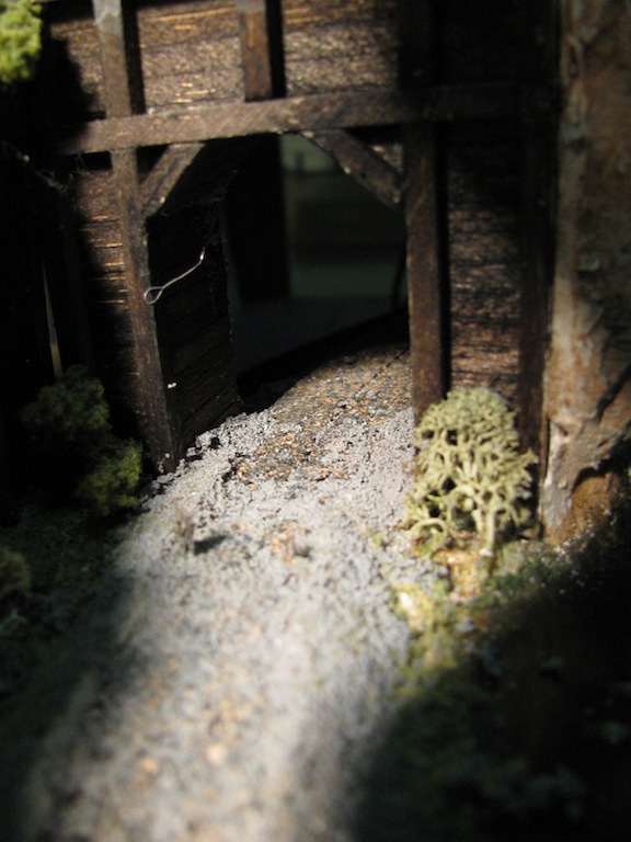

Here's the problem: some of the track is inside a tunnel (now don't ask me what that wire-like thing is sticking out of the tunnel portal - have no idea)

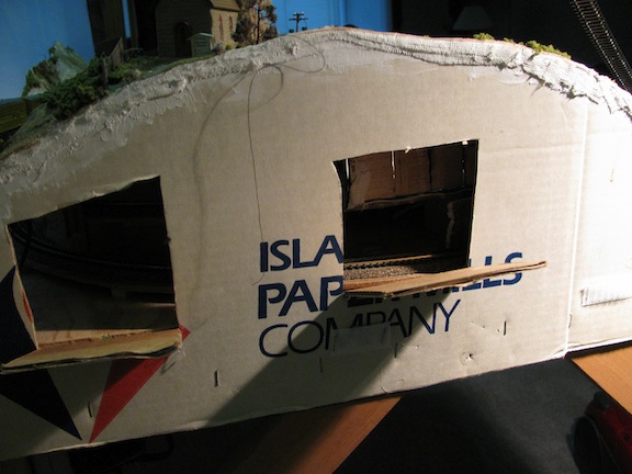

Luckily I have an access hole to reach inside the tunnel from the side:

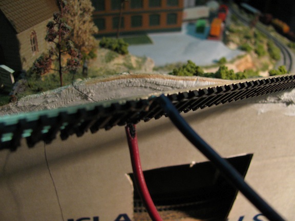

Power to the track is needed, so I removed some ties and soldered on feeders to the underside (note that this is my first ever soldering job and I only managed to melt one tie - not bad):
Discovered I need another access hole - since the "fascia" is made from cardboard, I simply used a knife to cut another hole, hinged at the bottom:

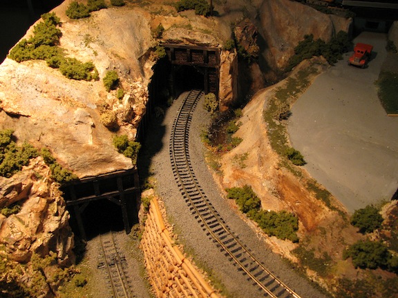

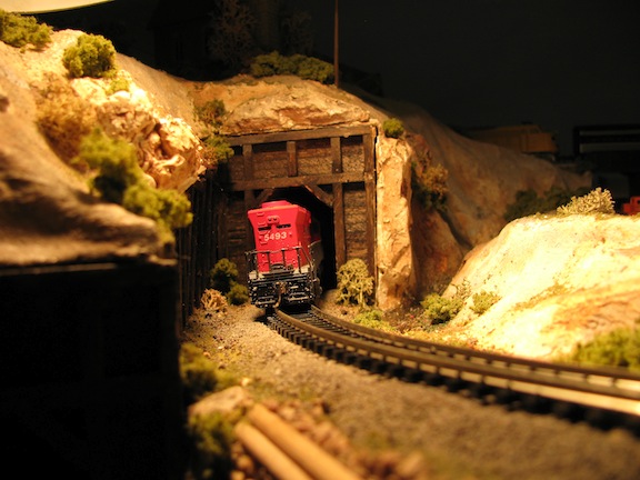

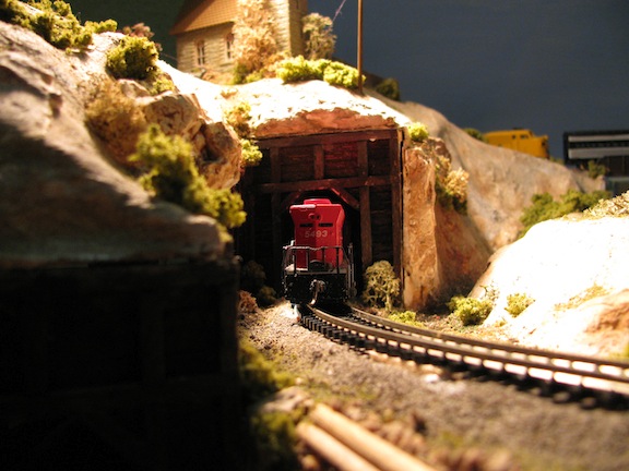

And finally after ballasting, it's done. Trains run much smoother through this area: Big Grin
