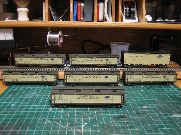

    Here is a shot of the cars to be modified, I figure the pickle cars could have started life as covered gondolas and the reefer could have the ice bunkers removed and dams added to the inside of the doorways to allow for the loading of bulk cement not unlike the l&NE did to some of It's box cars. All of the cars will get hopper doors added to the under frames also, but for now I working on the center sills.

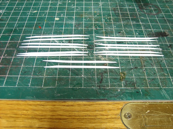

    The were cut from simple styrene, lucky all the under frames are the same so I only had to measure once and cut seven sets.

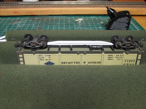

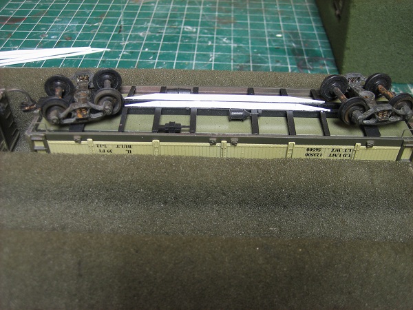

    they were glued in place after I cut some groves in the brake gear so that they would lay flat. I was not to worried about detail on the sills because the hopper doors will cover parts of them.
    When that was dry I added a cap to the sill with some more Styrene.

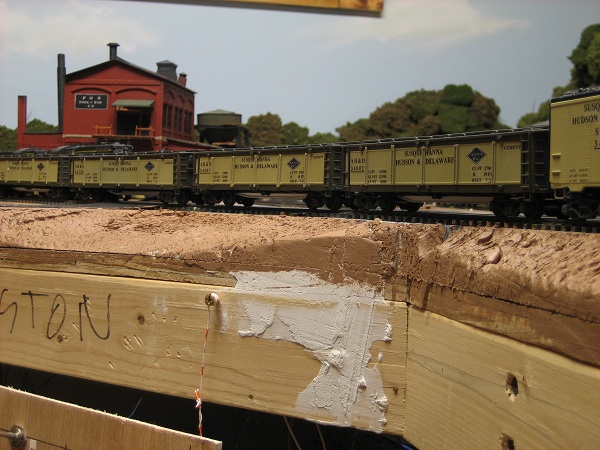

    with them all installed I set them on the track to see how they look. I say so far, so good. I'll start on the hopper doors tomorrow.
Definitely so far so good. The mods look good and the paint scheme looks good too.
Those are some very cool cars! I wasn't familiar with the style of cement car from that era. Thumbsup
Thanks Gary. the colors are Polly scale aged concrete and empire green. I've used them before on some of the company structures but never on rolling stock. My wife calls it the Eddie Bauer scheme 357 .
