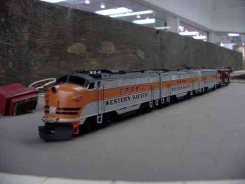

The masking for the orange stripe/nose of these WP FTA+B - F7A was done with blue painter's tape:

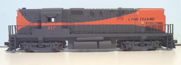

As was the orange "Flow-through" on the LIRR C-420 kitbash:

Quote:The masking for the orange stripe/nose of these WP FTA+B - F7A was done with blue painter's tape:
[ATTACHMENT NOT FOUND]
Very Nice! The LIRR one concerns me though, how did you get the tape in around the hood door seams?

Green_Elite_Cab Wrote:Very Nice! The LIRR one concerns me though, how did you get the tape in around the hood door seams?
By using 1/8" wide tape strips, I was able to work it into the "depressions" between doors ( etc. ) using a 3/32" dowel with one end formed into a "chisel tip", and another simply tapered to a point. The tape has to be pushed in, as you go. If you laid down the strip and then tried to push it into the crevasses, you would most likely puncture, or break the tape. Metal tools can have "too sharp" edges, and cause cutting or tearing of the tape.
Understand, there is still microscopic "bleeding", nothing is perfect, but unless it is over magnified, it is "unseen".
I'm going to have to make myself one of these tools, that just might work!

Quote:For your E-units, I'd make a guide as outlined above before applying any paint. The crucial area is at the colour separation between the lower green area and the grey/silver band at the nose. First, use your dividers to determine the full height of the lower green band and cut a strip of tape to that width, then apply it to your model - it doesn't need to be the full length of the body at this point, as you're merely determining the shape of the curve, but it should extend a little past the mid-point of the nose, where the band ends in a point. Make a vertical pencil mark at the point on the nose, and another pencil mark where the curve begins, which appears to be at the leading edge of the small walkway on the cab's side. Remove the tape and, using a straightedge, place it back on the sheet of glass. Use a pen or pencil to trace your estimation of the curve onto the tape, then cut along the line and re-apply the tape - you may hit it accurately on you first try or you may need several attempts. When you're satisfied with its appearance, apply the tape to a piece of paper (or thin styrene) and cut the paper/styrene following the curved edge of the tape. Use this pattern to prepare two strips of tape for each loco, flipping the pattern to do the opposite side of the loco.
Green_Elite_Cab Wrote:I think I understand that. Essentially, the first tape would be used to create a template to cut additional strips to match. Wouldn't it be possible then, to make the template already match the full width of the stripe, rather than just the edges?
Not exactly: The tape you're cutting to follow the curve is merely a guide for the lower edge of the tape needed to mask the light-coloured band. Once you have the correct curve (of the front end of the lower green area), you can go ahead and paint the entire unit with the light colour of the band. When that paint is fully cured, re-apply the guide tapes, then apply a thin strip of tape above the guide tape - this will demarcate (and cover) the lower edge of the light coloured paint which will comprise the light-coloured band. Use the dividers to mark a line parallel to this at a distance equal to the width of the light-coloured band, then use another thin strip of tape to mark (and cover) what will be the top edge of that band, then fill in the space between the two narrow strips with strips or bits of tape as required. The curved piece of tape at the bottom of the carbody (covering what will be the lower green area) is removed and discarded.
Quote: You can do the stripes with decals, but if the correct colour isn't available, you could also paint them, using the methods outlined.
Green_Elite_Cab Wrote:This is the part that concerns me. The red pin-striping would need to curve with the paint. Can a straight decal stripe conform to these lines? It can definitely see how this method could be used to paint the pinstripe, but that seems difficult to maintain what is roughly a scale 2" or 2 1/2 ".
You've already made a template/mask which follows the upper edge of the lower green area - simply re-apply it (or a fresh version of the same), then apply a strip of tape 2" or 2 1/2" wide, then a strip of suitable width to cover the majority of the light coloured band. Above that, apply another 2" or 2 1/2" strip of tape and then tape, in narrow strips or wide, as necessary, to cover all of the other areas that are to remain green. Remove both 2"/2 1/2" strips and apply your red paint on the exposed stripe areas.
If you use decals, straight stripes can be made to conform to curves - take your time and concentrate on the long (upper) edges of the stripe - the lower edge will pucker and may lift slightly in some spots, but don't worry about it. When it's in place to your satisfaction, carefully apply decal setting solution, which should make any puckered or lifted areas snuggle down. Touch-up with paint or small bits of decal stripe where necessary.
Green_Elite_Cab Wrote:I've seen this "Pactra" striping material in hobby shops, have you had expirience with it? It comes on a roll and can be applied around complex curves. One side is adhesive. I tried it once on a model for a friend when I ran out of regular decal stripe, but it did appear to come up so i grow concerned about how good it is. Then again, I may not have applied it properly since I was in a rush. Perhaps it could be used as pinstripe masking....
I haven't used it, but with the methods outlined above, you won't need it.
