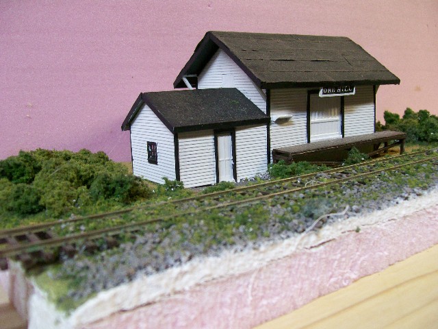

This is an example of one of my scratchbuilds. It was a station that was located on the main line of the Central New England. I guesstimated the dimensions from a picture in a book that was taken in 1928. I had to "Guess" the backside as there were no pictures and used "modelers liscence" for the build.

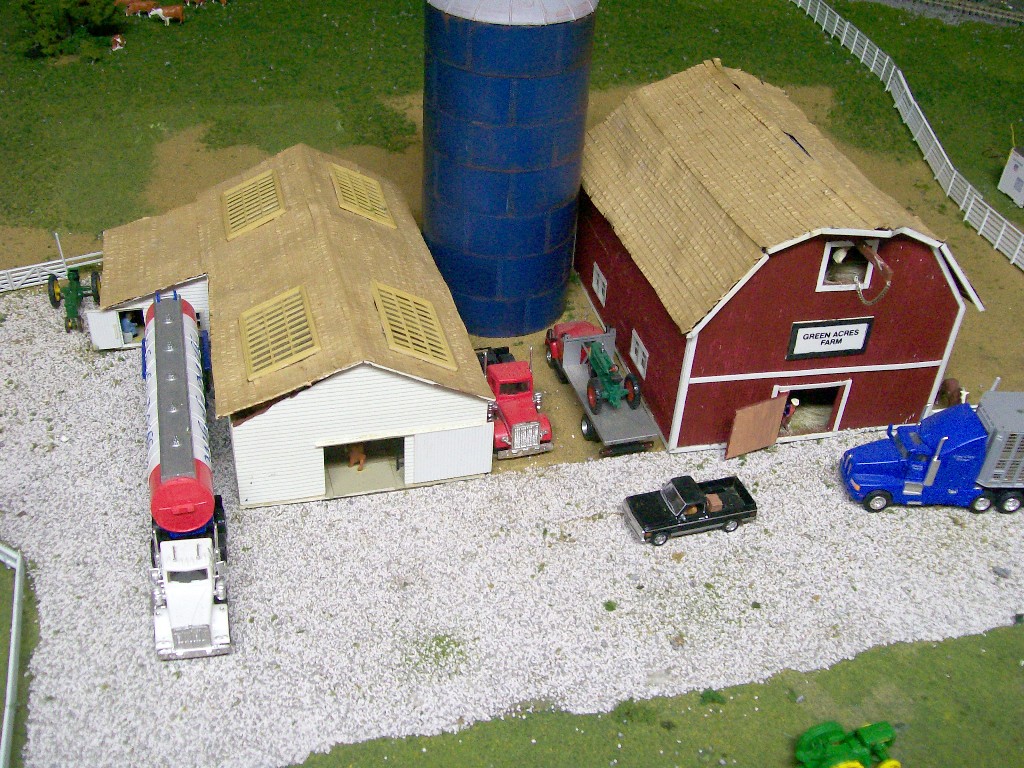

Here's a couple of barns that were scratch built using Evergreen plastic. The skylights in the milk barn were spare windows from DPM modular system. both roofs were covered using Campbell shingles. Doing the Dutch Provincial Roof on the horse barn was probably the toughest, that and cutting the end walls to match.

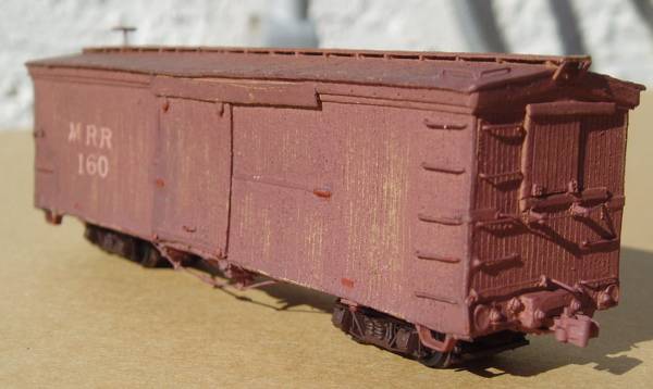

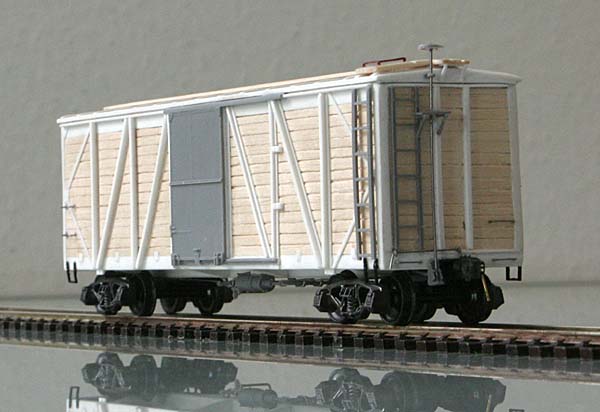

As for mixing wood and styrene, it is no problem. I did it several times, you only have to find the right glue – your plastic cement might even do the trick. It worked for me when building this boxcar.
[Image: Boxcar35.jpg]

The only scratchbuild I ever mocked up was the horse barn. Instead of trial and error with plastic, I first constructed the barn, less doors and windows, out of cardboard, holding it together with Scotch tape. Once I got the walls and roof right. I used the cardboard pieces for patterns when I cut the plastic.
Oh, by the way, the reason the two barns roofs are curling up is that my layout is in the attic, and the heat in the summer, with the Campbell shingles shrinking(a theory fo mine), the roofs are curling up.
