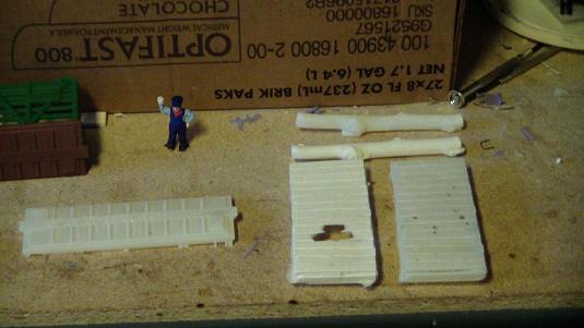

Here are some pics of One and Two part molds for On30 roofs for rolling stock, a flat car and a small log. I am scratch building in 2 scales at moment On30 and S standard gauge.
So far I have Kitbashed 5 box cars(On30) and scratch built 3 cars 2 in S and one in On30(the On30 has had a mold and I have cast hald a dozen of them so far.

If you put the molds in a pressure tank when you make a casting, you will eliminate or minimize the bubbles in the castings. Many people use a paint sprayer bucket.

dave1905 Wrote:If you put the molds in a pressure tank when you make a casting, you will eliminate or minimize the bubbles in the castings. Many people use a paint sprayer bucket.
I have also heard that de airing in a vaccume jar does the same thing, they also say a light dusting of talc in the mold also helps bubbles come to the surface and pop.
I am collecting stuff ro make a spincasting machine to help avoid any voids by useing centrifugal force to draw material in to the molds.

Practice and low viscosity resin help.
Here's a flatcar I cast:
The deck is a separate part from the frame, and is made up of scale 2"x6" boards...which are correct for this car. Some minor air bubbles were present, but I filled them with the trusty super glue and baking soda combination. You can't see them now.

What is the mix ratio of super glue to baking soda?

Kevin, I agree with that recommendation. That's not enough to justify the cost and learning curve of resin.
There isn't really a super glue to baking soda ratio. Just fill the void with superglue and then add baking soda to it. Usually, an air bubble leaves at least a thin layer on the surface. I recommend filing flat car decks from the bottom before removing them from the molds to protect the thin surface as the void is filled.
I have heard this a few times now and went looking for a pressure pot and they were kinda expensive however Harbor Freight has a 2 1/2 gallon one on sale for $79.99. At that price I am willing to try it. It beats trying to make a spincasting setup. If I get one will post the results in this thread.

Well here is the lattest casting and molding I have done, still have not setup pressure chamber due to a bad gauge waiting for replacement as the face of gauge was bent up and a loose screw as well rattling around(can you say mfg. defect?).
Anyway here is what I have been up to today.
