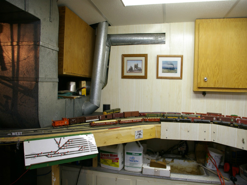

As their is a discussion on line and dead bolt elsewhere I felt we needed a new and broader one so people can show what they use and discuss such things as versatility easiness to construct and install, cost etc. With out hijacking some ones thread. I would like to hear other people thoughts on this subject. Do you like electric or manual or other?

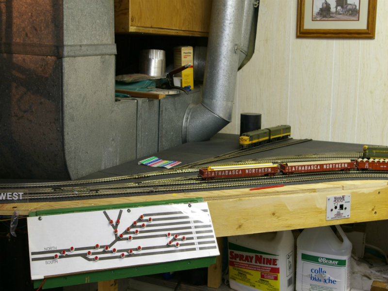

As I am using all electric control at this time accept for Caboose Industry's ground throws as temporary machines on Atlas and Shinohara and like switches, until I get time to install the electric ones. I have two more staging yards to build and am looking for alternative ways to control switches that are hard to reach, without knocking cars off the track.
On this yard there are a lot of switches on the back side making it hard to reach in. If I had used manual control rods there would have been a lot of knobs on the fascia making it confusing to the operators. On the electric control panel we put the push buttons on a schematic diagram of the yard, but it can still be confusing to new people. Does some one have a better idea?
There are more turnouts to left of the control panel and behind the cars on the yard.[ATTACHMENT NOT FOUND]

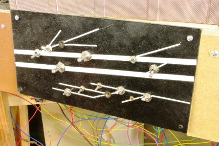

I use mostly Tortoises, with some legacy twin-coils on the part of the layout that was moved from an older place, and a few oddball situations like a Peco double slip with Peco twin-coils. Since I use a lot of Shinoharas (the older, non-DCC style) with live frogs, and Atlas code 83s with isolated frogs that I power, I like the electrical reliability of routing power to the frogs from the DPDT contacts on the switch machines. I also control additional relays for signals from some of the contacts.
Here is a typical yard panel:
I'm on straight DC, so there are three types of switches on my yard panels: block switches (the large center-off DPDT switches), switch switches (the medium, flat handle SPDT switches that control the Tortoises through steering diodes), and the smallest, SPST switches that isolate particular pieces of track. If I were on DCC, only the flat handle ones would apply.
I've found it's hard to have electrical reliability on Shinohara/Walthers switches if you don't route power from the switch machines. Powering Atlas isolated frogs also makes things that little bit more reliable. I'm also in favor of anything that keeps hands out of the scenery, since it's easy to knock down figures, snap telephone poles, knock details off structures, knock equipment off the track, etc etc. Thus I like remote operation of switches even if they're right in front of you -- for the same reason, I like uncoupling magnets under the track.

Prairie Trains Wrote:On this yard there are a lot of switches on the back side making it hard to reach in. If I had used manual control rods there would have been a lot of knobs on the fascia making it confusing to the operators. On the electric control panel we put the push buttons on a schematic diagram of the yard, but it can still be confusing to new people. Does some one have a better idea?[ATTACHMENT NOT FOUND]
The first thing that comes to mind is color coding.
