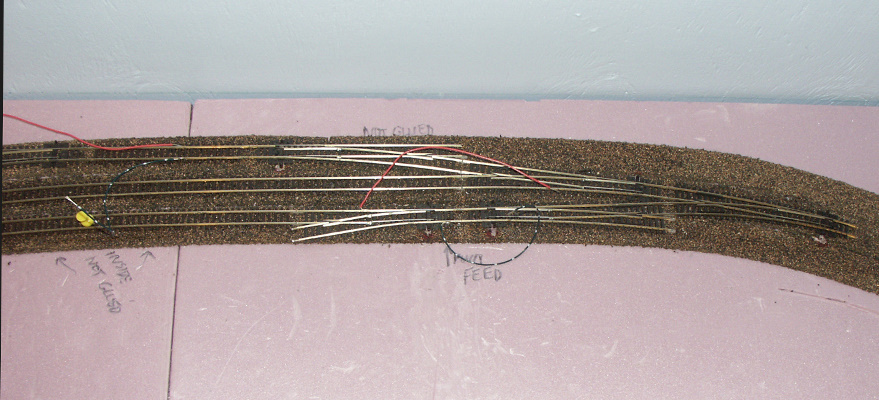

Ok, here is the track laying disaster part 1. The middle track and the interlocking in the 3rd photo I did after the rest was done using less caulk. So much so, some of the track didn't stick. Enough for ballasting (I hope). I apparently either got bits of cork roadbed and/or caulk around the throw rod of the lower turnout in the 1st pic, the points didn't throw properly. I tried cleaning it out, but wound up destroying the spring. The points move ok now, but no snap action.
Not a happy camper. :oops:

videobruce Wrote:I apparently either got bits of cork roadbed and/or caulk around the throw rod of the lower turnout in the 1st pic, the points didn't throw properly. I tried cleaning it out, but wound up destroying the spring. The points move ok now, but no snap action. Not a happy camper. :oops:
That, is also a risk when ballasting. you have to be very careful where and how much ballast and glue you use around the point rails.. . . . . and, it's one of the reasons I never glue down the track.
N scale track spiked to cork, and ballasted, on my Ntrak module. ( with the N scale tour car )
It doesn't show that clearly, any difference. It isn't a bad way to lay track, the modules have survived several trips to and from shows, and wide temperature extremes, with no apparent damage. . . . and, comparing "Hours/foot" track laying time. . . not a whole lot slower, and with a lot less mess. Besides, spiked rail /track, can be adjusted for any operating problems. That's much harder / messier to do when the track is glued down.

From the pics , it looks like you got the cork roadbed down OK with no issues there . If you messed up a turn out or 2 , no biggie , just replace them and be done with it . We've ALL messed up and it usually costs us time , money or both .....for me it's usually both . I guarrantee you won't make the same mistake again . If there are some small areas of track that didn't sufficiently adhere , try raising the offending area slightly with a putty knife and apply adhesive ( caulk , glue , whatever ) with a toothpick . Lay a longer piece of 1x2 wood over the track , put on a little weight and leave it to dry . You should be fine .
Looks pretty good in the pics .....track spacing is smooth , nice realistic radius etc . Thumbsup
