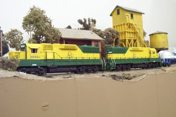

It may be a bit hard to see in this photo, but the Cindys Harbor Logos, and numbers, were done in Green, and in Yellow, by Rail Graphics, to my artwork.
To get the green on yellow, and the yellow on green, I had to cut one of the green, and one of the yellow logos, and piece them together, for each side of the FTA,( FTB, and F7A ).
In the shot of the BL20-2's, I was able to use the complete Green logo decal, because the entire background was Yellow.

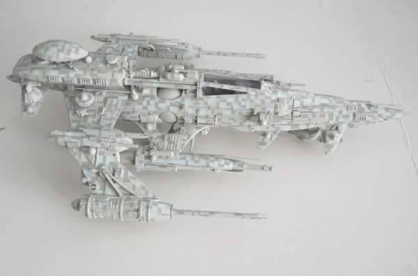

** P.S. If you want to learn "Masking Madness" - - - - try a digital camouflage paint scheme like :
