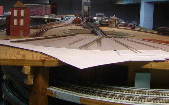

Just about exactly a year ago I started work on a CMR turntable kit. No, it hasn't taken me that long to build! It actually is a very nice kit (made of laser cut acrylic) and goes together easily. Believe me, if I can get it together and have it square enough to operate well on the first try, just about anyone here can! But once I had it built to the point where it could be operated, I needed to install it and that required several other things to be done first. My turntable is mounted above the inside space of a helix, so I set up the 3/4" plywood base on sawhorses to mark locations and cut out the hole for the tt and the slots for the inspection pits in the roundhouse. Then the base was mounted in place and it was time to install an indexing system. So a control panel needed to be built and the motoor installed, etc. Once that was done, I had to bring in the lead tracks, which travel over a section that was to be removable for access to yard turnouts for maintenance if (when) needed. Then I realized that the lead tracks went under the coaling tower and sanding tower, and over an ash pit, and none of these structures had been started yet. So all these were built and installed along with the track at my workbench, then put in place on the layout. Which brings me pretty much to where things stand today, with work on the roundhouse about to start, followed by finishing the turntable bridge and detailing. some pics to follow.

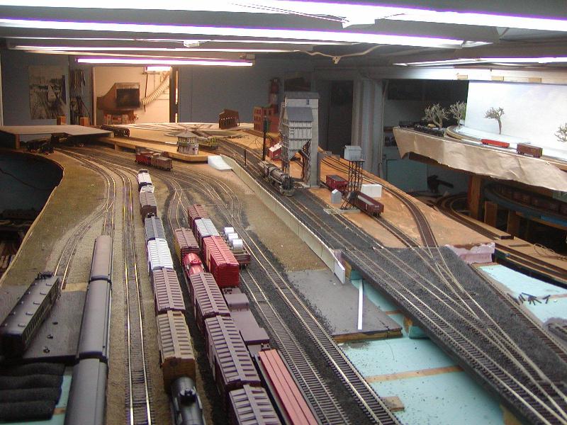

This first pic shows the end of the peninsula, where the helix is located. You can se the floor of the roundhouse, which is the Walthers 3 stall kit, two of them actually for 6 stalls. The 3 stalls on the right have been extended 3" and a cinder block addition will be added to the brick structure. To the left of the turntable is an old Magnuson model serving as a fill in for now, a scratchbuilt powerplant will go there, burning oil deliverd on the track alongside. To the right of the leadtracks you see a switcher sitting in front of a tower. The track that runs in front of the tower and to the right where you see the end of a passenger car, is the siding Eddie Willer's private car is spotted on. JGL corp. offices will be there.

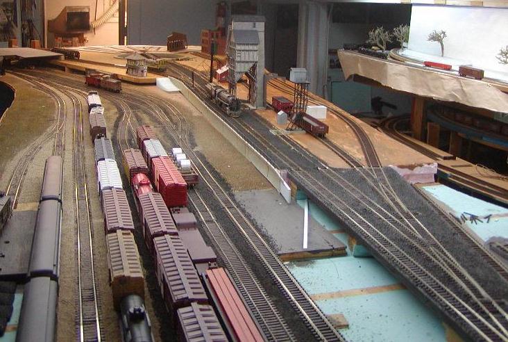

This aerial view of the yard from near the other end shows the track arraingment pretty well. The passenger cars are on the main, the next two tracks are the thru receiving and departure tracks, then the next three trcks are stub ended yard tracks. The next track is the yard runaround track. To the right of all these is the new trackage laid for the engine facility. They connect to runaround track about 3' below the bottom of the picture. The left hand track is for oubound locos while the next is for inbound. Both can get coal and sand and water. Only the inbound track has an ashpit. The ash conveyor was scratchbuilt as I found no reasonably priced kit of the prototype I wanted. The coaling tower and sandhouse/tower are Walthers kits. You see the service track behind the ash conveyor and coal tower. I modified the coaling tower so that the track needn't be elevated. I have to admit I did not find any pics of situations where the track was not elevated. I'm not sure why the track would need to be elevated, the elevator in the tower needs to lift the coal to the top anyway. Perhaps to avoid the neccesity of digging a pit to dump into? At any rate, elevating the track would have caused me problems, as I desired to use just one track to service all functions, ash, coal, sand and diesel fuel. The track furthest to the right, which splits into two tracks just behing the ash conveyor, are diesel ready tracks. The yard is primarily used for changing power on thru trains. Diesel only to the east, mostly stean to the west. Cuts of cars are exchanged for both a couple locals which run out of the yard and for interchange with other roads, coming in from hidden staging (down the helix). You see a piece of masonite sitting above the yard tracks just before they hit the helix. Trains will run out of sight from this point east. On the far side of the structure, which will be the corp. offices, there will be a parking lot ove the tracks, which you will not even know are there.
I see the bottom of the photo was cut off when posted, I have resized and edited out the top in hopes you will now see the bottom of the photo.

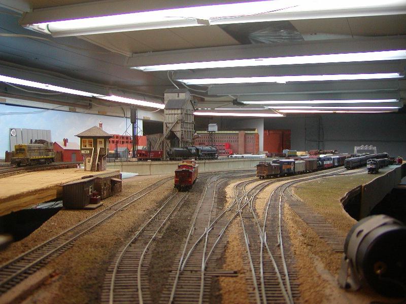

Well, you got more of it, but still not all. But enough to get the idea. Let's see what happens with this one. This is the view Eddie will have from his office over the tracks.
Yikes! That's awful. Resized again and hope you get the bottom of the photo, but I believe it will suffer in clarity.

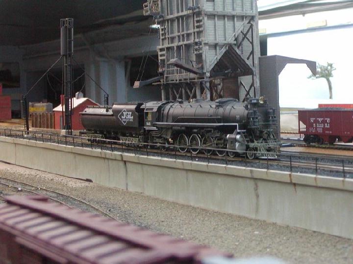

Bummer. Oh well. This last shot was just for the sake of composing a nice shot showing as little unfinished are as possible. There will be a aservice road in front of the wall. Hope it shows up ok, it really is a nice shot.
The bottom is cut off again, can someone tell me what I' doing wrong, or is it that my file is to big and the site just lopes off some? When I reduce to 640x480 the picture quality really suffers. 800x600 would be nice, the last photo(one post above) is at 720x540
