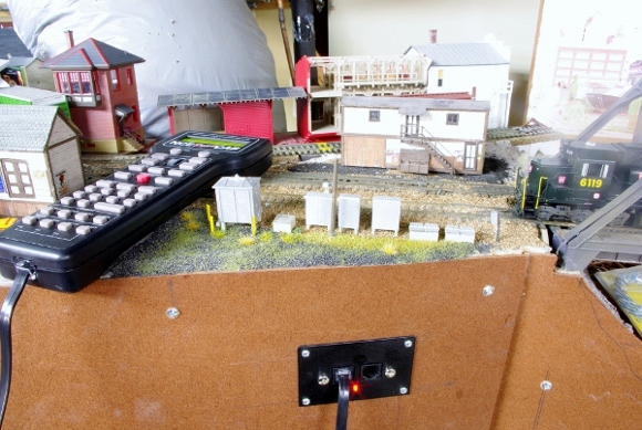

Based on some research and some input from this forum, I went with the NCE PowerCab. Here it is, with the base station or whatever you call it, on my layout:

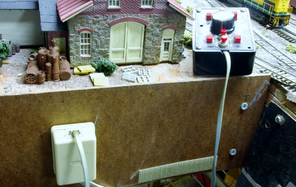

Here is the straight DC walkaround control system that I'm partly replacing with DCC:
It was made by ITTC, who is still in business http://ittproducts.com/ doing sound modules for layouts. However, he quit making the DC walkaround systems in the early 1990s, deciding that there weren't going to be many new straight DC installations as opposed to DCC. That was his call, of course, but the two ITTC walkaround systems I have are very robust and have lasted 25 years. If I'd been able to get replacement parts, especially the handhelds, I'd have stayed with them.
However, there were some downsides: as you can see, the tether wire for the controller was always getting caught on something, and a lot of the time it wound up pulling the handheld controller to the floor, so the handhelds are beat up. Also, the standard phone jacks are wearing out. As a result, I'm going to radio control for my DCC cabs, and I'll change from two ITTC systems to one, cannibalizing the parts in best shape from the other to keep the one running.

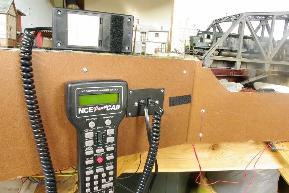

One of the early problems I wanted to solve was how to hang the handheld components of the NCE system. A defect of the ITTC DC system I'd been using was that there was no provision for hanging the handhelds anywhere, and for 25 years I would just put them on the layout when they weren't in use, which inevitably tore up scenery on one hand, and on the other, the tether cords would catch and pull the handheld to the floor, which was also bad -- though the handhelds do both still work, a tribute to how robust the system is.
I'm jealous that Reinhard was able to find some Bluepoint universal throttle pockets -- they're out of stock over here, so that option was out. Then I remembered a tip I'd read someplace that you could use Velcro strips to hold the handhelds to the layout fascia. This is what I've come up with:
Here is how the Velcro strips work:
I don't know how well the Velcro strips last, and I'll still keep looking for the universal throttle pockets, but at least I've solved this initial problem. I still don't like the cord that the Power Cab uses. The Power Pro is radio capable, and I'll use it with radio once I get the NCE base station.

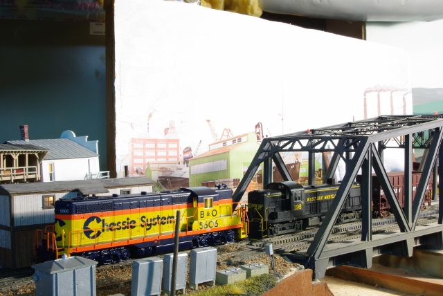

I've disconnected the less powerful ITTC straight DC controller from the second cab of the block system on my main line and replaced it with the NCE Power Cab. You can see the headlight on B&O 5606 to prove this:

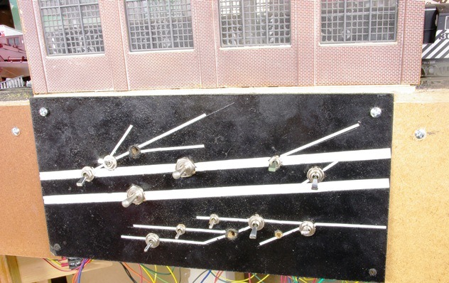

The more powerful (5 AMP) ITTC straight DC controller remains on the first cab of the block system. In effect, what I've done is to add a DCC option as one cab on a two-cab layout. Here is a typical block control panel. It's set up to allow me or any (very rare) other operator to select blocks as we walk around:
I know this is a less than good way to do things, but I have so many locos on plain DC that DCC is going to be a long-term transition project, and it will almost certainly be necessary to retain a DC option for as long as I have a layout. The large DPDT toggles on the board select one of two cabs, depending on whether the switch is up or down. They have (and are now in) the center-off position. The normal position of any block switch will be center-off, and since I will normally be the only operator, there's less chance that I'll run a DCC loco off a DCC block and onto a DC block by mistake, thus smoking the decoder, though I'm definitely aware of the risk. However, I don't see any other way to do things.
Also, the subminiature toggles on the board are for DC-style isolation of tracks where locos are stored. I will continue to use that for both DC and DCC locos, since the layout will continue to be wired for lower-amp DC operation, and I don't want to run the amps up with locos not in use but on the track. The flat lever toggles are for switch machines. Again, the switch machines will continue to have separate AC power, meaning less amp draw off the DCC wiring, which will continue to be a basically two-block system.
I'm pretty sure that the two-amp capacity of an NCE Power Cab won't be too much for this level of wiring. If I wind up using a lot more amps, I'll expand to a 5-amp booster and rewire the buses.

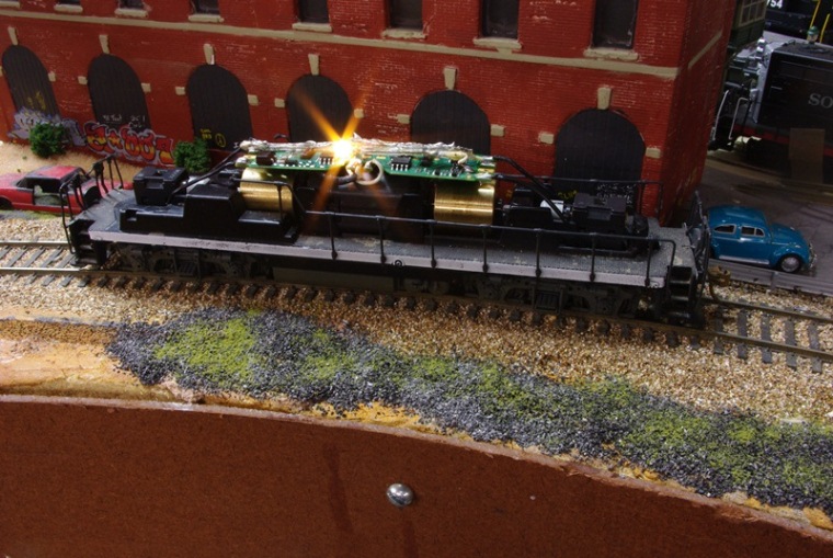

I've installed a few plug-and-play decoders, changed some Atlas dual-mode in their GP38s and 40s to DCC, and programmed some Bachmann DCC on board locos. I decided to try a next step, the TCS A4x decoder, which is a replacement for the Atlas light board in old yellow-box GP7s, RS1s, RS3s, RS11s, S2/4s, etc. There's some soldering involved, and the question of what to do about the lights. The old yellow box Atlas typically had a single incandescent bulb at the center of the board that was unidirectional, feeding two light bars going to either end. One of my biggest objectives for DCC is to get better, constant lighting in my locos. I had some yellow-white LEDs on hand, and the TCS A4x has built in resistors for LEDs, so what better place to start? I followed the suggestions in the various TCS install guides on their site and wound up mounting two LEDs to fit roughly at the center of the board, replacing the single incandescent.
After about an hour, it worked right the first time!
I didn't want to do anything to change the existing light bars, since I wasn't sure exactly how to cut them and then polish the new ends to get them to transmit light, and I'd already installed numberboard decals in the numberboards, which are integral with the headlight lenses. I still need to check and be sure the LEDs will fit between the bars on the GP7 body -- otherwise, I'll need to fiddle and adjust:
Also do something like paint the half of the LEDs not facing the light bars black to try to get as much of a not-lit effect on the rearward-facing headlight as I can.
But it looks as though the TCS A4x will rejuvenate and add value to old yellow box Atlas, and I have a LOT of those.
