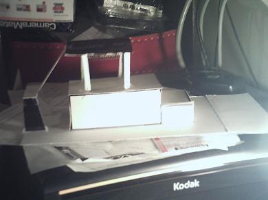

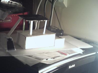

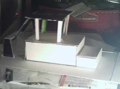

The following pics are just a practice run mock up of the model I will be building. I have a few sheets of srtyrene that have no project claiming them till now but will most likely use a mix of materials in the construction of the Ruby Belle. In the pics the Pilot house has not been made yet on the mock up.

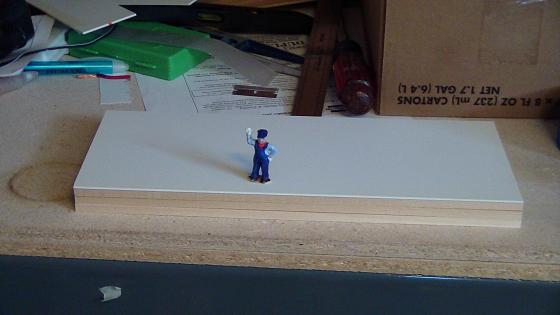

Here we have 4 pics of the hull being made out of stuff that was on hand which made it 12" because that was the longest sheet of styrene on hand . Building up the hull with some bass and balsa wood strips glued together and to the plastic using walthers Goo. And the figure is an O/O27 railroad worker just as a scale reference. I will be using the pics and the half completed mock up to keep me on track as I build.

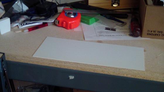

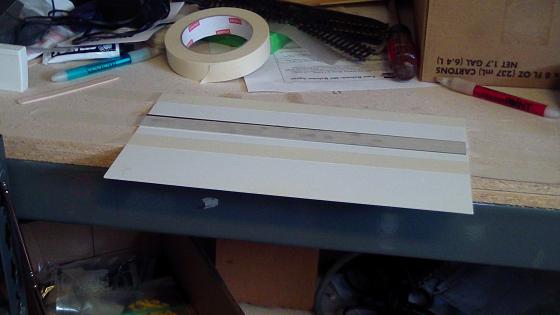

This pic shows styrene sheet fastend down and ready to cut.
Here we have the deck cut to width

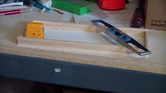

Test fit for overall scale +/- artistic license
Hull glued to deck(the underside)

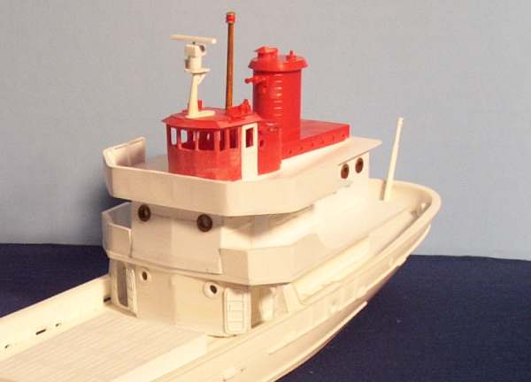

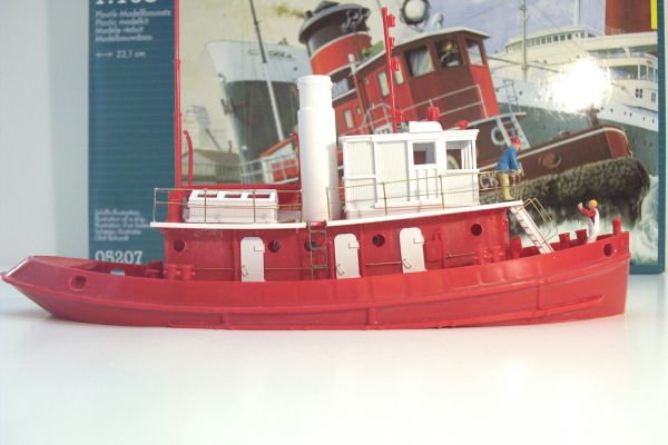

Big Grin Big Grin Same model kits, different boats. the "Sunk-Stripped" was modeled after a photo of an abandoned tug on the cover of a magazine. The pilot house of that one was used on my "Coastal Freighter" "Louis Atrhur". The pilot house of the "Towboat" is being used on the --as yet unfinished "collier","Ralph Henry"
Both the freighter, and the collier started out as Lindberg "North Atlantic Fishing Trawler" kits. Yup !!! Bash, bash, bash.

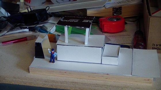

Here the mock up is place on actual hull

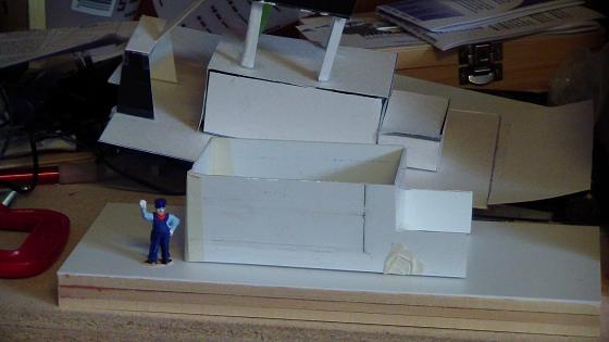

Here is the begining of the model's lower section(not glued yet have to mark up for windows and doors)

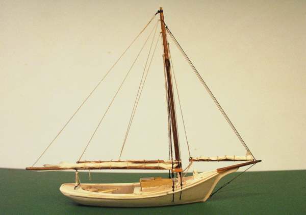

This is the Harbor and Ocean series, cast resin and wood HO scale kit of a Friendship Sloop. It was.....a challenge to build it as a decent model of a sloop. I ended up using the hull, and seriously scratch-building the details, and not using the rigging line provided. ( a bit on the "heavy side" ), even the lighter weight thread I used photographs a bit "stout". Remember that in HO scale 1", is only an actual 0.114942" :o Wink
O K... I admit, I am familiar with this sloop, and it's development as a "Down East" work boat, a "grown-up" Muscongus Bay Lobster Smack. They are really a sweet sailing craft !, and make a wonderful private sailboat. Their work boat "roots", give them a seaworthiness that can be hard to find in some modern sailboat designs.
That said, The resin casting was excellent, and the resin was easy to work with, and again, it was because I know the boat, that there was a lot of ironwork,blocks,and dead-eyes that had to be built from scratch.

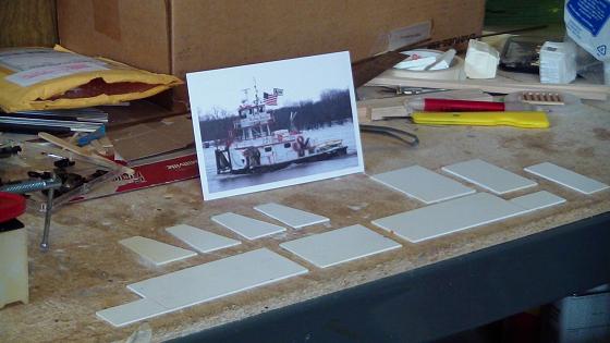

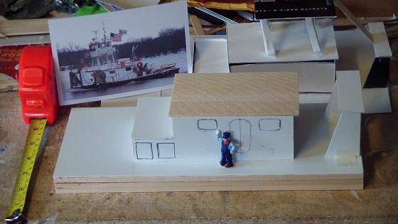

Here is a pic of most of the deck house parts cut and laid out(have not cut out a roof yet. Once I locate the doors and window locations I will then go back to the mock up and try a few things out on the pilot house before commiting to the actual model.

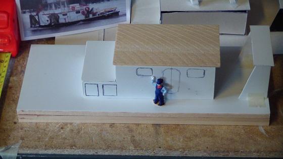

Here we have the Doors and Windows mapped out, I will make a template so that the windows will be same size and shape before cutting out. Again it is just held together by tape to check and compare to the card stock mock up and photo. The figures I will use are actually diesel(train) machanics. The roof on the deck house is just a random piece of balsa, will cut out the roof from sheet plastic. The figure in the pics is for a scale reference only and is not part of the Ruby Belle crew. Icon_lol
Port side aft, the lower "deckhouse structure", it appears that there is a "Cover" /"Hatch" to the port side of the stack. Looking at the after window it looks like a railing, inside, on a stair ( ladder ). This would be a "Companionway" and the cover would be a "Companionway hatch". It is possible that it would be the same on the Starboard side, but I can't be positively sure about that. The stack would run down into the engine room, and there isn't a whole lot of room on either side of it for much more than a "companionway", which is why I would expect one on the Starboard side as well.
Just a thought for when you get to that point in the construction.
Good eye Sumpter, I kinda thought it was a hatch but did not know if I should model it closed or open. If open the I need to model a set of stairs/ladder. As for the stack there are two exaust pipes? sticking out of it and already found suitable parts for them( bendy straws) May have to change the title from scratch build to scrap build Icon_lol
Once I get the windows and the pilot house figured out then will come the challenge of all the equipment on the pilot house. Being that the pilot house is mostly windows I am wondering what the interior of the pilot house is like specificaly a control panel?
The Pilot House interior would depend on "when" she was built, or last re-fitted.
I would expect to see, at least, The helm ( steering), an engine order telegraph, A display for the Radar, some means of Radio communications, and probably a chart table. I used the term "expect", because I'm not sure what a "River barge pusher" would be required to carry on board.
An internet search of "River Tug Pilothouse" might shed some light on the subject.
