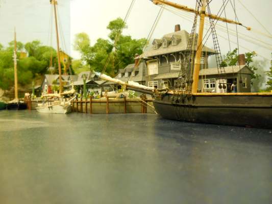

The only unknown element for me is how to do a calm sea. I never do that before and I have seen many techniques on internet. The key factor of success for this layout is the sea. I'm a little lost so if you can help me ?
Modeling "water" is never easy. The scene in this picture, is on a river, just inland from the sea. It is 1/4" plywood, sanded smooth, and spray painted a dark blue, with a clear gloss over. I waited until all the paint was dry, and then used a clear acrylic floor polish to add some more shine.
This is in HO scale. The scale you will be working in will almost require that you model every wave, and ripple of the water surface ! :o Big Grin
The only thing I can think of, to do, is, play with some of the techniques you have already found, to model the waves and ripples, and the traces of the wind on the water surface, on pieces of the material you will use for the "base" of your "sea". Choose the one technique that makes the best looking water, and go with it.
I would recommend that you use a "stand-in" for your boat ( a form identical to the lower part of the boat's hull, that you can coat with something that will keep it from being "glued into the water" ), when you do the water surface, so that when the water is done, you can set the boat in place and it will look like it is "in the water" , and not just sitting "on" the water.
Wishing you luck with this. Cheers Cheers
Thank-you very much for your advise Thumbsup
For the base, I will perhaps used a sheet of plexiglass painted on the under-face or your technique. I have to test both techniques.
For the waves and ripples I will do it with gloss acrilyc medium.
Waves and ripples work well with Clear bathroom silicone sealant, squeezed on in lines, and pulled up into peaks with a toothpick as it dries - then add a touch of white paint to the top where the wave curls over for the "foam"
