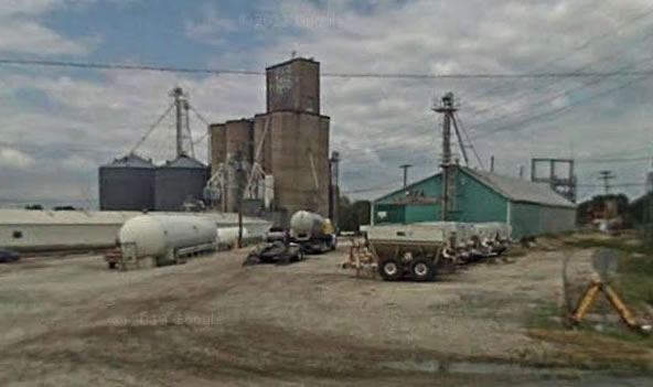

[Image: file.php?id=18714]
So is the greenish-blue house-shaped shed with the elevator for fertilizer? This seems to be a pattern I see in California, fertilizer in house-shaped sheds with the modern-style elevator legs.

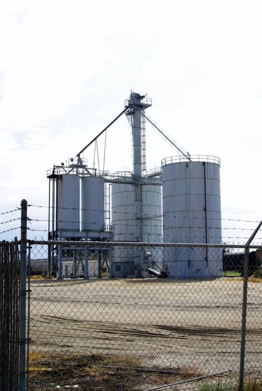

Here's another question: as I said in another thread, in many parts of the country, grain is shipped in as feed. However, the equipment seems to be very similar to town elevators that handle outbound grain. Here is what I'm almost certain is a feed facility in Buttonwillow, CA, The track is on the far side.
The smaller elevated cylinders seem to be for loading trucks.

jwb Wrote:... The smaller elevated cylinders seem to be for loading trucks.
I understood they are so called "surge bin". They are used as a buffer to collect the input and enable a continuous flow at the output side. I see them at loading stations (like on your photo) and at grain dryers.

jwb Wrote:[Image: file.php?id=18714]
You got it! The shed is where bulk fertilizer is stored. These facilities come in all sizes too, and the modern type "grain leg" is found at most of them. Also, the large tank you see to the left is an anhydrous ammonia tank.

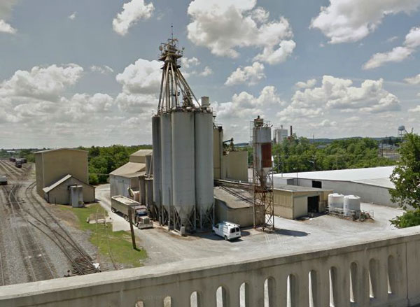

jwb Wrote:Here's another question: as I said in another thread, in many parts of the country, grain is shipped in as feed. However, the equipment seems to be very similar to town elevators that handle outbound grain.
Many feed mills look like your example and are often confused with being just grain elevators. Here's a view of Burkmann Feeds in Danville, KY.     You can just make out the rail spur to the left of the grain truck and the covered unloading pit. They typically receive about 1 car of feed a month. Lot's of cattle and of course horses in the area. I've seen some feed mills around the mid-west that are monsters.

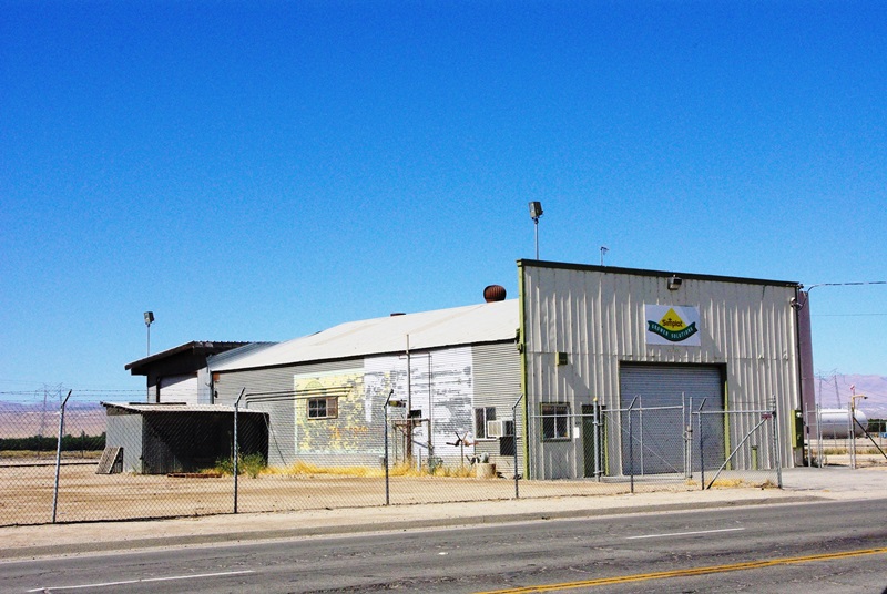

A couple more fertilizer questions (I don't want to hijack Reinhard's thread, but this does cover rail-served agri stuff, and nobody seems to have been much interested in the thread I started in the industrial forum a few days ago):
Here is a structure in Buttonwillow, CA with a sign that says Simplot Grower Solutions:

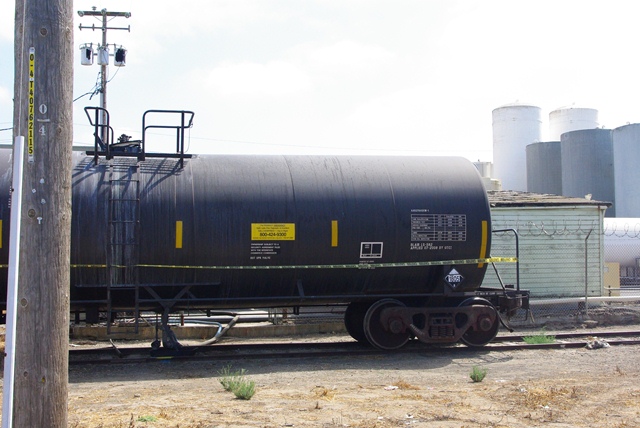

Simplot is a little puzzling to me, because they do both potatoes and fertilizer, and I assume this is the fertilizer end. This backs up against a rail siding, but I don't know if this gets rail shipments of anything. But here is a tank car lettered for Simplot in Santa Maria, CA carrying phosphoric acid. It seems to be serving a somewhat similar small facility, though there are tanks here, and the car is clearly being unloaded.
Is the same thing being done at both places? If so, I really, really like this layout-size agri business.
