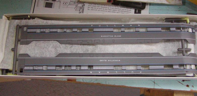

Ok,
Here are the pics...
First, the kit...
[Image: IMG_1746.jpg]
Don't let the injection process fool you, the castings are not distorted. They are flash free.
[Image: IMG_1751.jpg]
The model vs. the official Pullman drawing.
[Image: IMG_1755_2.jpg]
The sides are slightly too long (slightly) and lack the full width diaphragms (or any!).
[Image: IMG_1753.jpg]
The windows aren't right. Neither are the skirts...although the skirts might have been altered for negotiating model railroad curves and are acceptable to me.
[Image: IMG_1754.jpg]
The vestibules are close but no cigar...especially with respect to the doors.
The model trucks vs. the real thing. I knew before I ordered that this detail would be wrong.
The cars are actually fairly nice. The trucks, which are less than stellar on their own, seem like solid trucks for a skirted car. The killer for me is the windows being 4.5" too high. While it isn't too much of a problem without paint, it would look terrible once the car is painted up in the 1938 4-stripe two tone gray scheme...the stripes won't line up with any correct or non-ECW cars! Nope Nor will it line up with my J-3a's tender. Wallbang

very weird how the windows are the wrong size...Was the manufacturer working from different plans? Most of the time when dimensions are wrong, i assume it to be from 1) a compromise to allow the model to run on tight radius curves, 2) a means to use existing detail parts or dies; 3) the manufacturer not having access to accurate dimensions. I'm scratching my head as to why those windows would be wrong.
nachoman Wrote:very weird how the windows are the wrong size...Was the manufacturer working from different plans? Most of the time when dimensions are wrong, i assume it to be from 1) a compromise to allow the model to run on tight radius curves, 2) a means to use existing detail parts or dies; 3) the manufacturer not having access to accurate dimensions. I'm scratching my head as to why those windows would be wrong.
They are actually the correct size, but located in the wrong place! The killer for me is that the vertical location ruins the striping. Wallbang
I suspect that the tooling was done before 1987...when the official records were published. The plans I have are better than looking at a surviving car...they are Pullman's as-built plans and are accompanied by the builder's photos...including interior shots. If you like lightweight passenger cars, they are the ultimate books: <!-- m --><a class="postlink" href="http://www.rpcbooks.com/index.php?option=com_content&view=article&id=51&Itemid=23">http://www.rpcbooks.com/index.php?optio ... &Itemid=23</a><!-- m --> They are re-printing the AT&SF because the initial run 20+yrs ago was too small and they were selling for $500+.
I just can't understand how they got the window placement so wrong...car sides usually look rather symmetric...vertically.

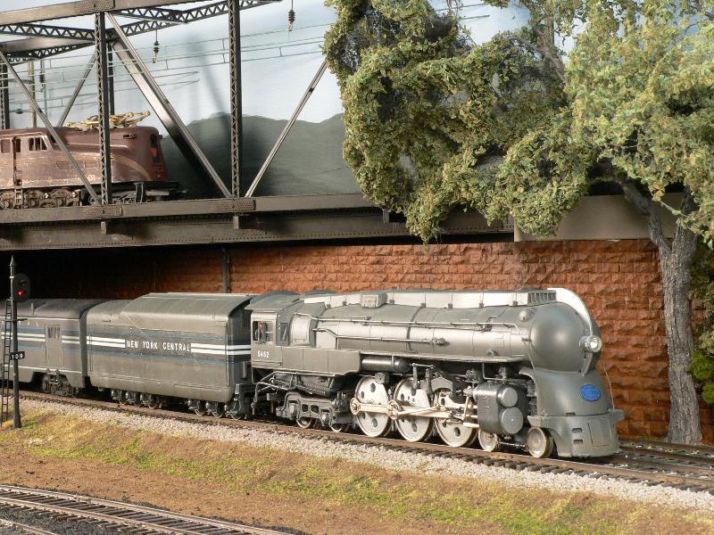

Gee, the lines match up well on my Rivarossi tender! See photo

Heh, I'm just playing with ya, funny story how I came to wind up with the 38 Century. Back around 1980, I told my wife I would like a brass J3a that had just come out. I was not thinking of the streamlined version, but guess I never mentioned that. I got the streamlined loco for Xmas. Many years later, maybe ten years ago, I went to the NYC Historical society's show in Cleveland. The brass loco had sat unpainted all this time. At a table there someone had the 7 car set of the 38 Century by Eastern Car Works, all built up. So I bought them. When i got home I found they had not been assembled terribly well. They did have full width diaphrams on them, which were very stiff and had to be removed to get them around my 30" radius curves. But I still had derailment problems and I found the trucks were not assembled square. A bit of tweaking improved all but the observation car, which even had its body glued on at an angle so it was higher at one end than the other! The trucks don't roll well either, but the brass loco is a strong puller and it hauls the 6 cars up a 2% grade ok. But when i pull the string by hand it is obvious the drag is much greater than say Walthers cars.
Anyway, I had a painter match the colors of the cars to paint the loco, (turned out to be difficult, the greys are not just black/white) and I bought a Rivarossi tender to replace the centipede tender that came with the loco. We just painted the tender and put the stripes to match the cars, I never realized they were in the wrong place! I was on a NYC forum some years ago and found someone with the 7 car set unbuilt and so I bought it. Have not done anything with it, but would like to find the correct trucks and then build the cars, I'll have more sleepers this way, and an obervation to replace the bad one. I'll repaint the coaches for my freelance road.
Here are a few pics, the original brass tender waiting for a use (may upgrade a J1 someday) the boxes for the unbuilt set of cars, and the side of the observation, as you see prepainted, so most folk will never realize the window problem, till they couple up to a loco such as yours. Bummer. You could just reapint the tender.
