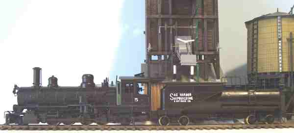

Hi Matt. I don't think it's that low. Here's a quick picture of the engine on the layout:
[Image: 006_zpsjvmswmdp.jpg]
As for a prototype, I'm not really aiming for anything in particular, maybe that 'narrow-gauge' look without going narrow gauge?

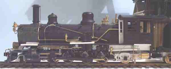

Here's a shot of the MDC Narrow gauge 2-8-0, as an "outside frame" 2-8-2, before painting.
I used an MDC narrow gauge tank car kit, to modify the kit tender to a Vanderbilt tender for this loco.
