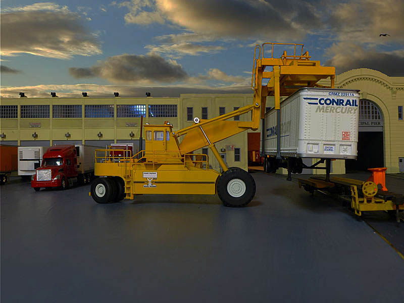

A shot of the ill fated piggyback unloading operation at Pier 34.
bdw9535 Wrote:A shot of the ill fated piggyback unloading operation at Pier 34.
Looks great!. How do you make this paved area?
postman Wrote:Looks great!. How do you make this paved area?
Thanks,
I used some balsa strip wood to form the area to just below the railhead, then used premixed joint compound to fill the forms and a metal ruler to level it off.
After it set up used a sponge dipped in water to flatten it out and reapplied the joint compound to any low spots and then used the sponge and water till I was satisfied with the look. When everything was dry I used cardboard from cereal boxes to fill in the area between the tracks and then painted with a gray acrylic paint.
One problem with the way I did mind is that if you get cracks or chip the surface the lighter color of the joint compound shows. You might what to try mixing your paint with the joint compound to avoid this.

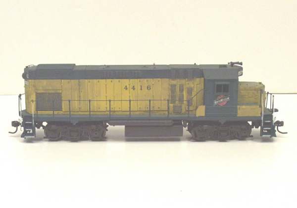

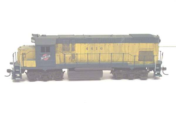

Speaking of GP-15............Saw this in the yard in Waukegan Il., and had to kit-bash one.

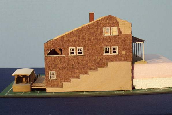

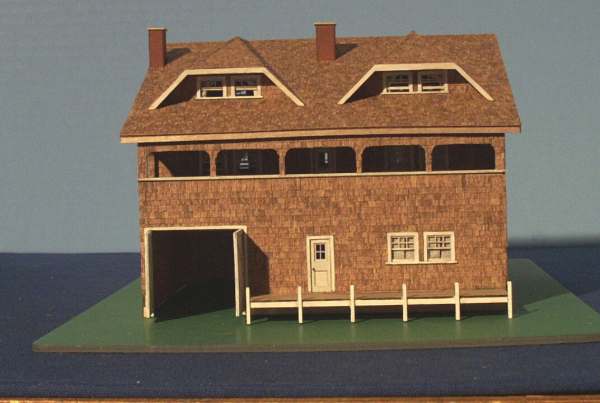

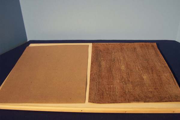

Do you really don't want to know how this:
became this:
became this:
became this:
became.....this:

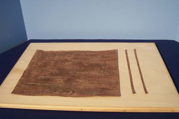

Yeah, about 7,500 of them, individually applied. :o NO repetitive Wink pattern anywhere on the building.
I was applying the last two, when those "nice young men in their clean white coats, arrived to take me away".
It was still worth the effort, to not have any repetitive patterns in the shingles. Wink

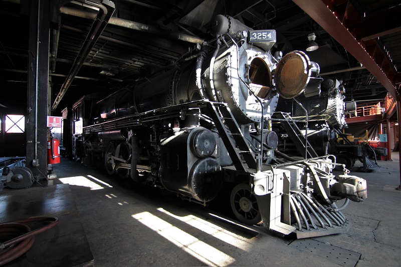

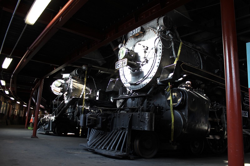

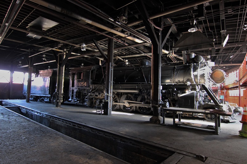

Canadian Steam at Scranton. The light was just right in the roundhouse this morning. All was quiet as just myself and a few other volunteer's shuffled around at Steamtown readying the park for todays guests.
