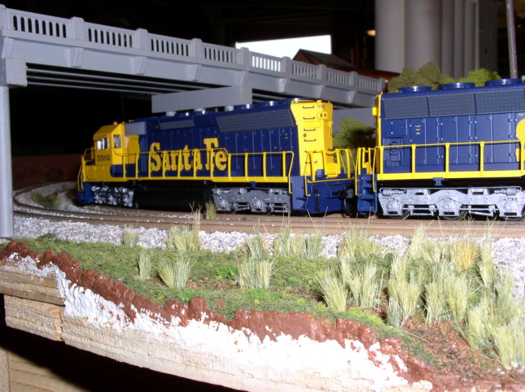

I use it also, similar to the manner Mike does. I model in HO so I do it a bit differently. First I take a small bit of 2-3 shades each and intertwine them together. Then I shift them slightly so the ends are randomly uneven, no more that plus or minus 1/16". Then I hold that end between the fingertips and make a straight cut as close to 1/4" as possible. Then I dip the straight cut into a puddle of Elmer's White Glue and stick it on the layout where I want it. You have to use very sharp scissors or the cut becomes jagged. Use a toothpick to get it to spread out in a natural manner. You could use all one shade, but around the area I loosely model, there tends to be varied hues in the same clump. Here's an example from my old layout.

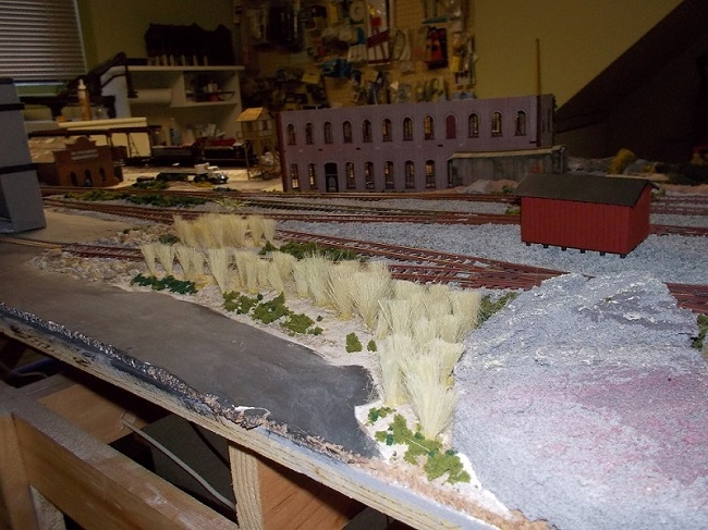

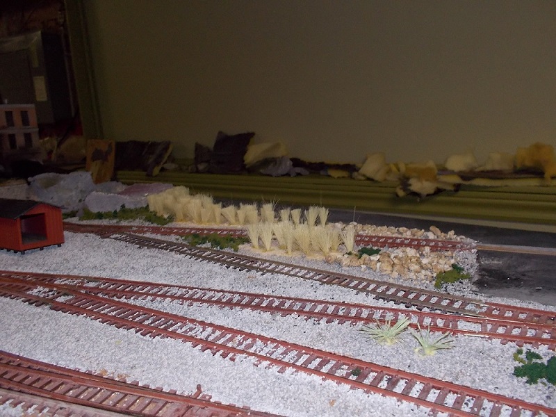

My effort so far
It went very slowly because the glue I bought recently was a no-name brand which dries OK but takes a long time to set up.....consequently I had to prop up each piece one at a time . In the first picture , in the foreground and to the lower right you can see that I've reshaped a couple of plants and painted them green to give a differnt look just for fun . Modeling the field grass wouldn't be my favourite mrring task but it came out OK I think .
T. they look a little to uniform I think? Maybe not.
In shape or height .....?
I would think " in height ".
a pair of scissors, maybe 3" to 4.5" total length, and kept SHARP. Make the cuts "almost parallel" to the grass stalks, and "attack" more than make a planned cut. the more random the cuts, the more natural the look, and the less chance of a repetitive pattern, in the length of each stalk.
An alternative method, would be to make up a batch of grass bundles, apply the glue to one end, and let it dry before proceeding. This way you could hold the bundle by the glued end, while making the cuts. In both cases I would use several rapid cuts, and let things fall as they may. If you try to "plan" each cut, they will lose that "randomness" and appear too fake.
Using this method, you can learn better how to hold the bundle, and how to "snip away at it", to make it more natural.

I see what you mean ...in the pics they do look like upside down brooms ......I may colour them as well . I think Switchmans field grass looks good with a lot of weeds around it , too , so I may address that .
T
Yes the tops look much to even. Most plant stems and leaves grow at different speeds and therefor are all different heights. santafewillie's method gives a better result. No offense intended but yours all look like they had a brush cut.
