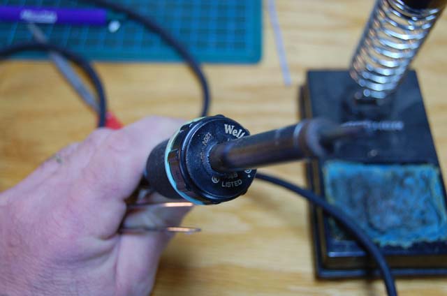

The hot side of these photos was facing up in the stand. Notice the discoloration of the "Weller" ring

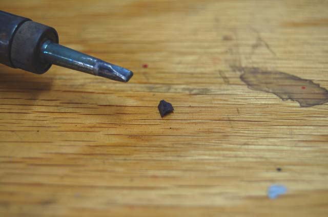

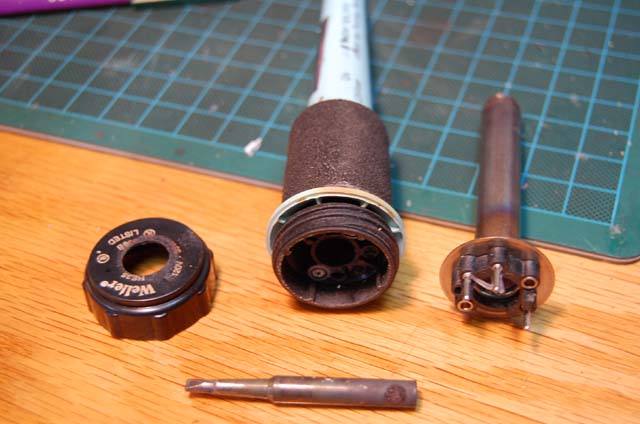

Apart you can see a white heat streak up the handle, the disassembly ring damage noted above, absolutely no damage to the heating element or it's wiring leads, and a spot of rust on the tip itself (and another 180 degrees removed). Not certain what would have caused that.
A crust of oxidation formed on the tip - easily knocked off with a file.
The iron is still functional - this is a good unit if it can survive a user like me...
